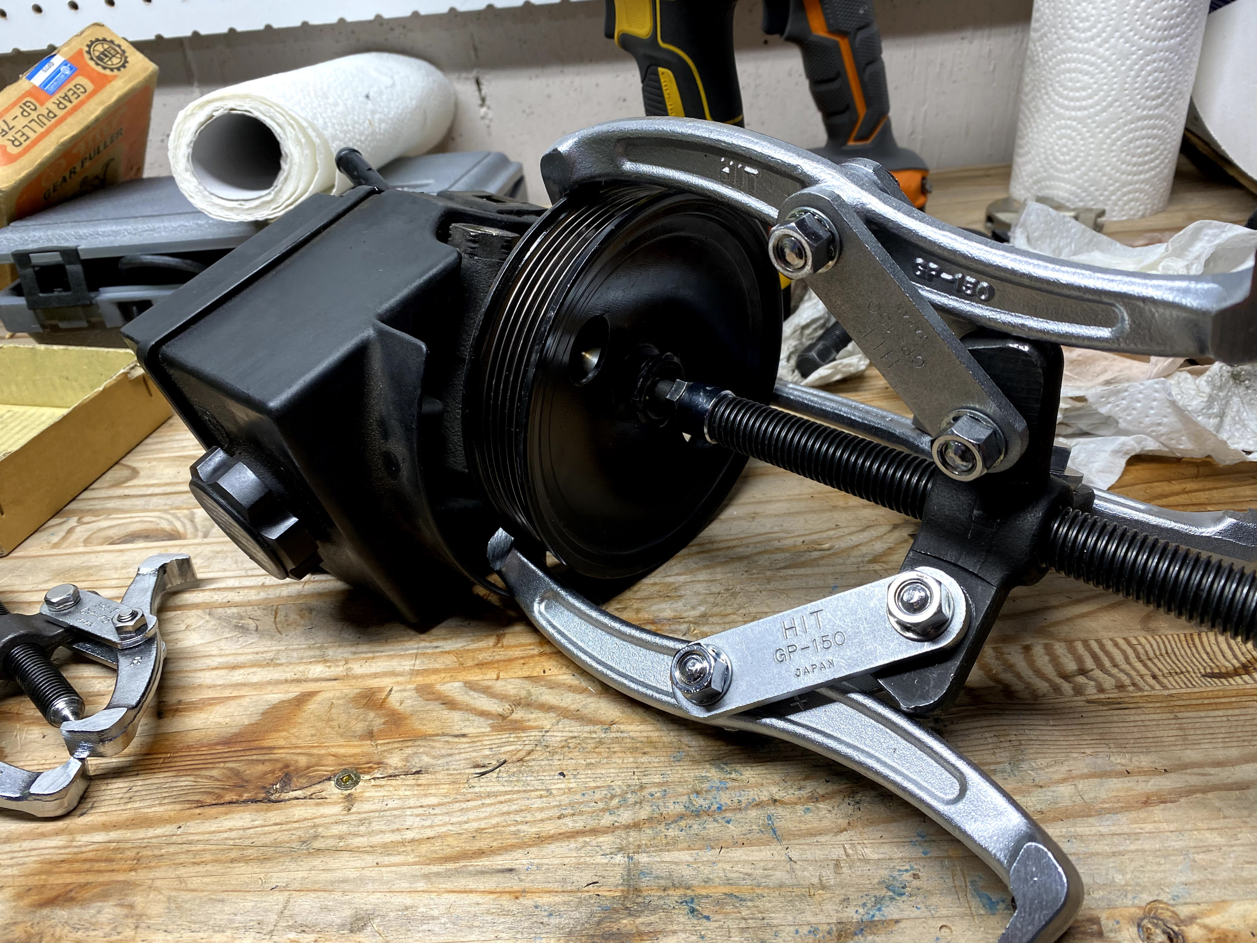

A small report on the pump replacement, which went quite smoothly. I'd give it a 3/10 on the difficulty scale, mostly because there's a couple annoying bolts and special tools required. I used a 3 jaw puller to remove the power steering pulley, and the reinstalling tool from this rental tool - https://www.canadiantire.ca/en/pdp/oem- ... p.html#srp to put the pulley on the new pump.

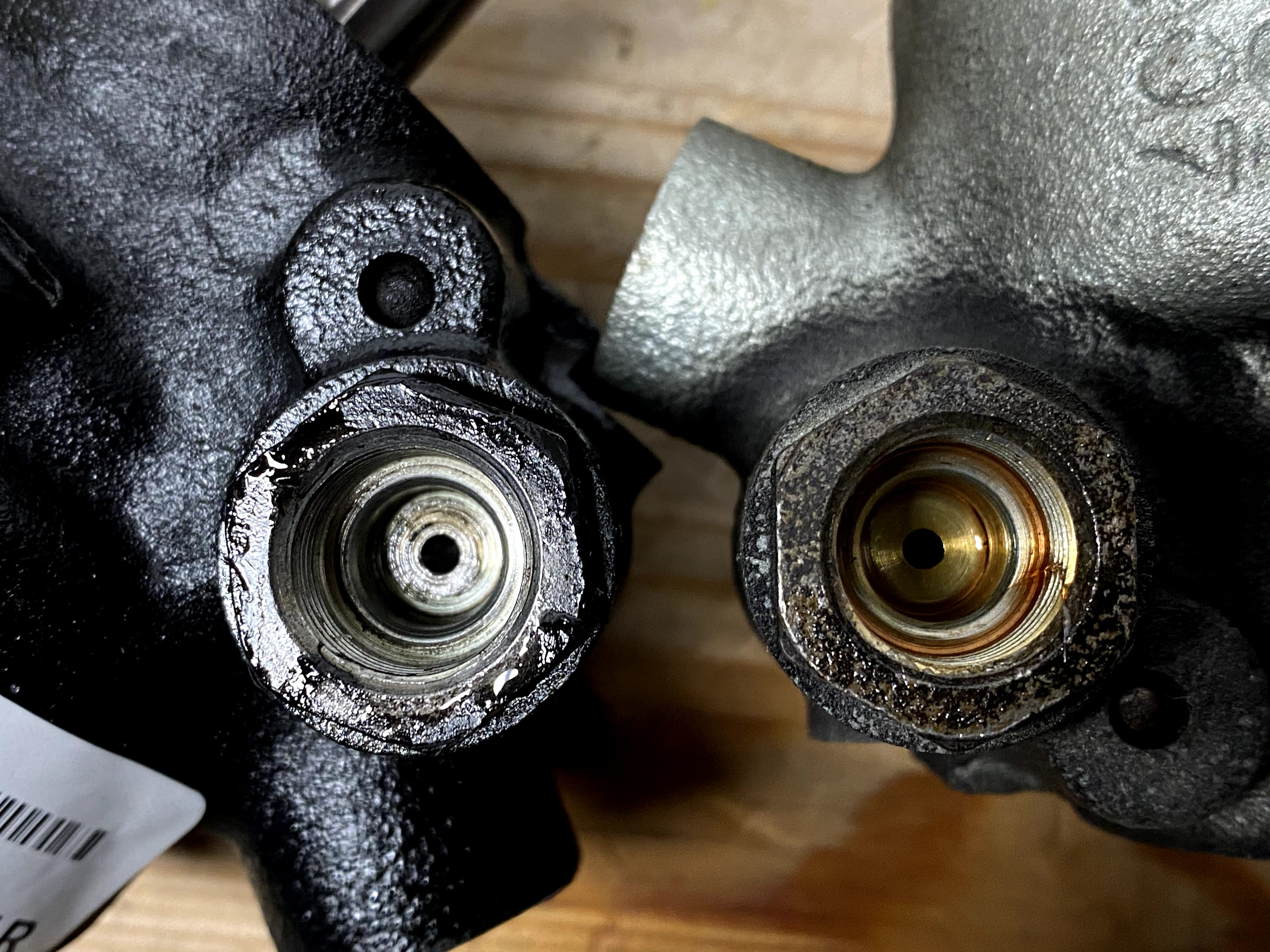

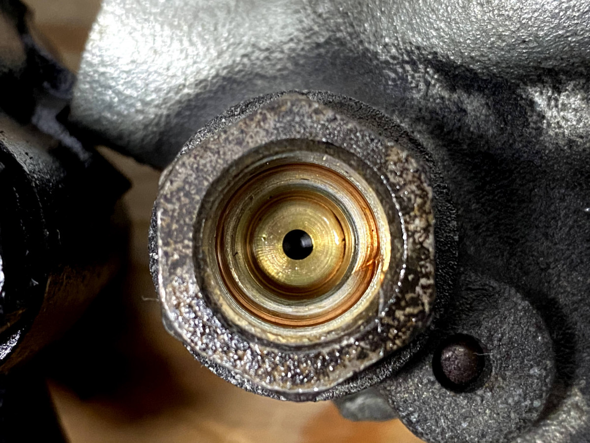

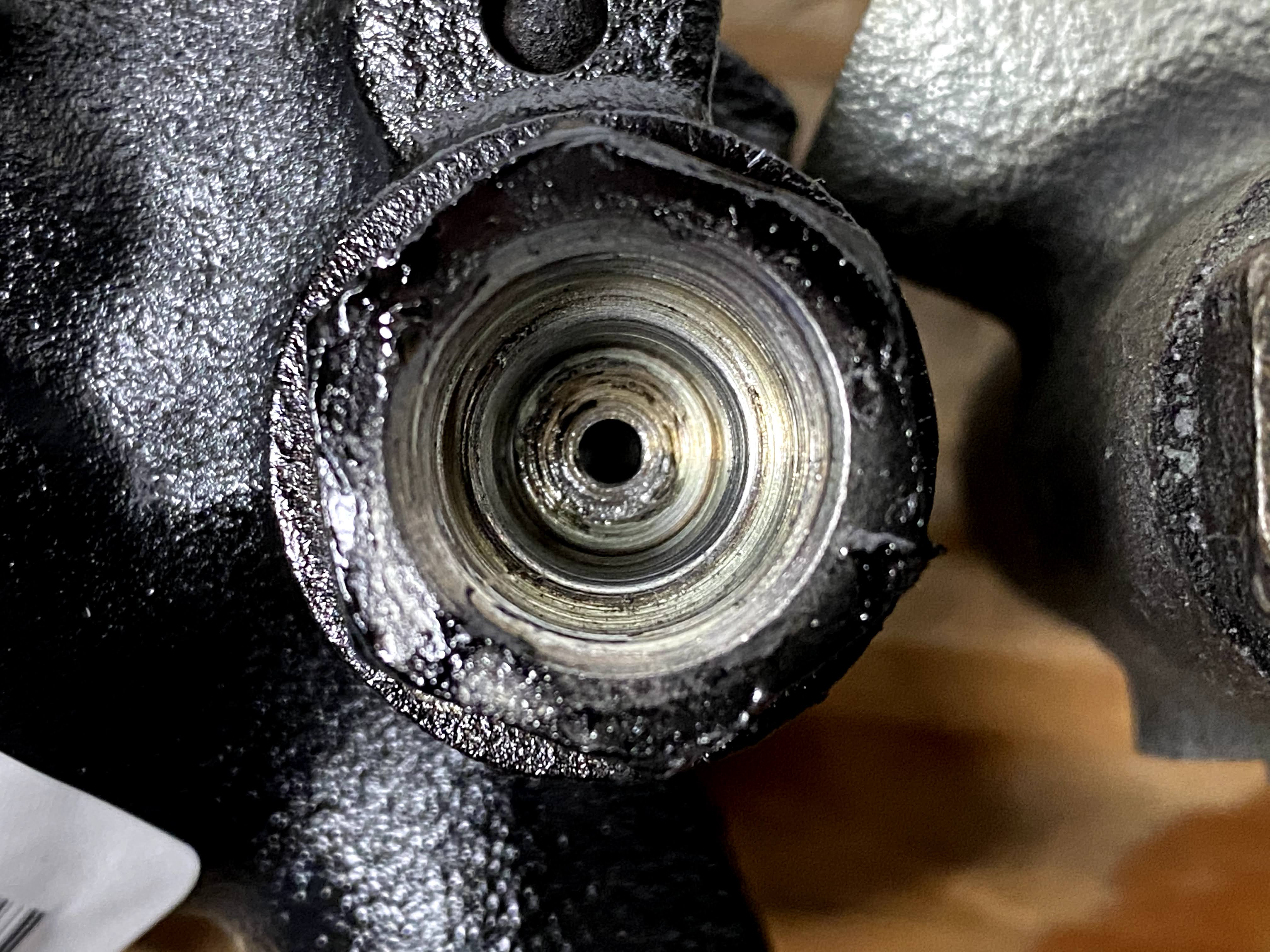

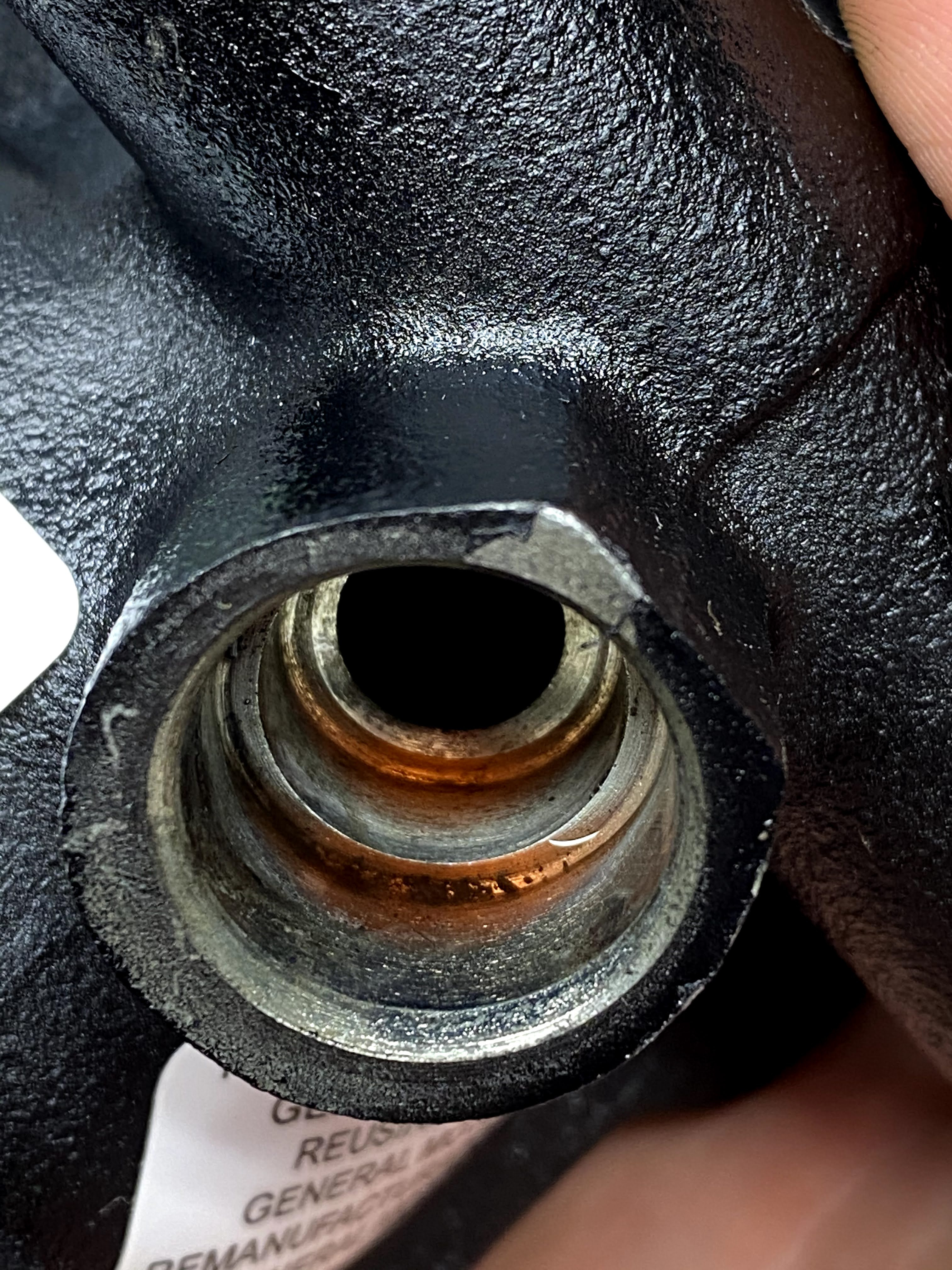

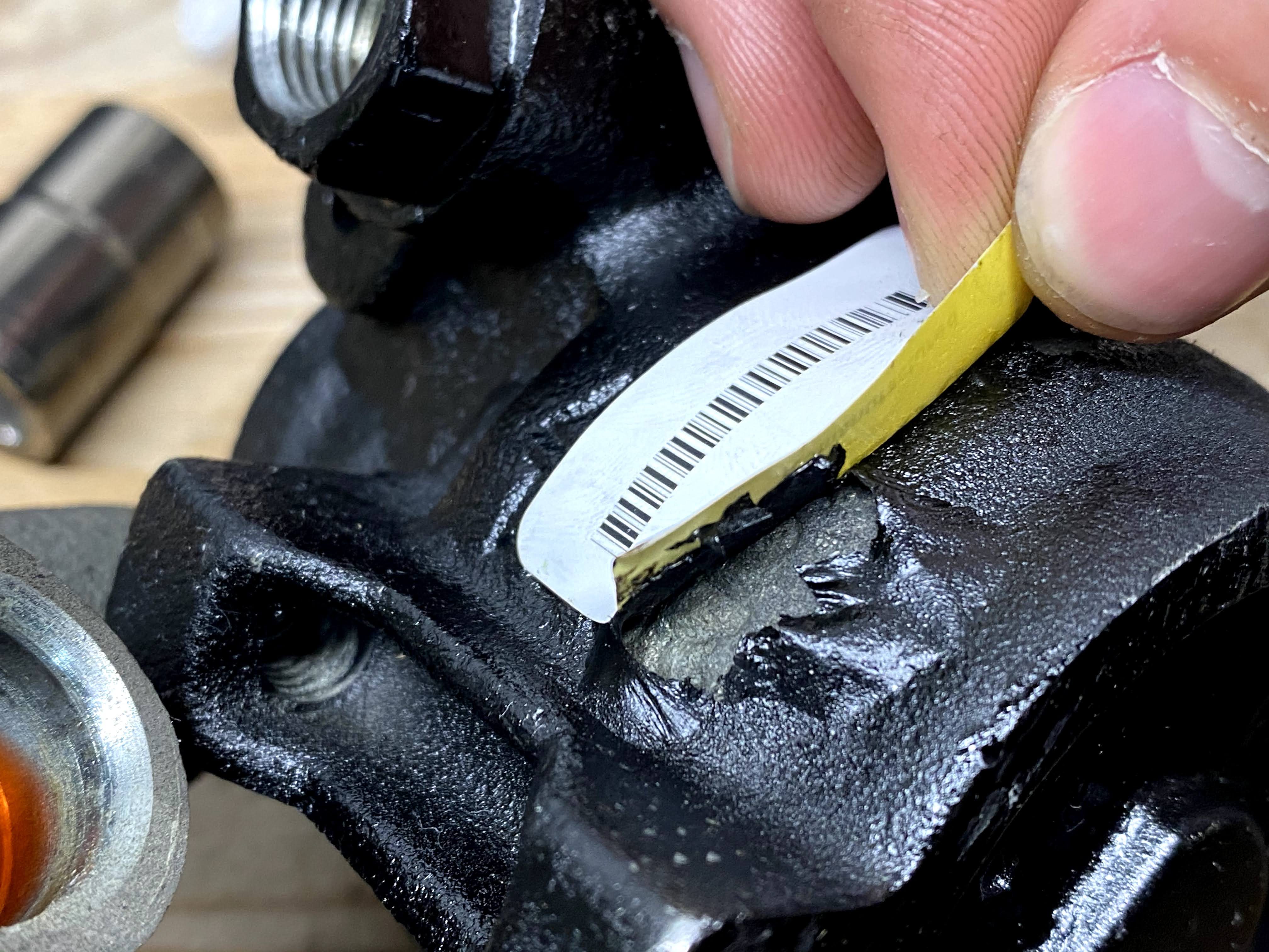

First impressions on the AC Delco pump - it's clearly an OEM Volvo part which has been plastidipped black, quite poorly as you can see how it started peeling when I removed the sticker to check the part number cast on the pump. No primer or anything, just black plastidip type paint straight onto the dirty part. No biggie, I peeled it off and it looks just like my original pump. There were a couple quality issues that I noticed, which was the lack of an o-ring for the reservoir attachment point, requiring re-using my original pump's o-ring. And a generally dirty-appearing fitting for the reservoir - you can see how my original pump is nice and clean and brassy, the reman pump has particles in the ATF still. I cleaned it out and while it's probably just fine, if I were someone who didn't give the pump a once-over, it could cause issues, especially installing the reservoir without the o-ring.

Quality paint
Original pump high pressure fitting
Reman pump high pressure fitting before cleaning
Both high pressure fittings
Both reservoir fittings
Reman pump shmoo on reservoir attachment point before cleaning

I'm kind of gobsmacked that the pulley could withstand being pulled that way without bending. The metal connecting the hub to the rim looks pretty thin, I guess it must be really hard. I never would have thought to pull it that way. I'm glad it worked for you!

That puller tool is designed for things like this.
There are few sizes of the same tool.
Pulley can't be bent because the tool grabs it in 3 points and it push the center while pulls the pulley in 3 points.

Misha, you are correct that as long as the axis of the puller screw is aligned with the axis of the pump shaft the 3 jaws will pull straight and evenly. If the puller goes crooked and the pulley is really stuck on the shaft there could be damage.
Now that sventastic has shown that it works I'll be trying it soon!

850oldschool wrote: 17 Jul 2020, 15:21 Misha, you are correct that as long as the axis of the puller screw is aligned with the axis of the pump shaft the 3 jaws will pull straight and evenly. If the puller goes crooked and the pulley is really stuck on the shaft there could be damage.
I was slightly concerned about it as well, but it doesn't appear to have bent the pulley whatsoever. I started off with a 2 jaw puller but it was awkward to finagle it into the 2 holes on the pulley, and I couldn't get enough force on it. The 2 jaw started to bite in and bend the pulley very slightly
