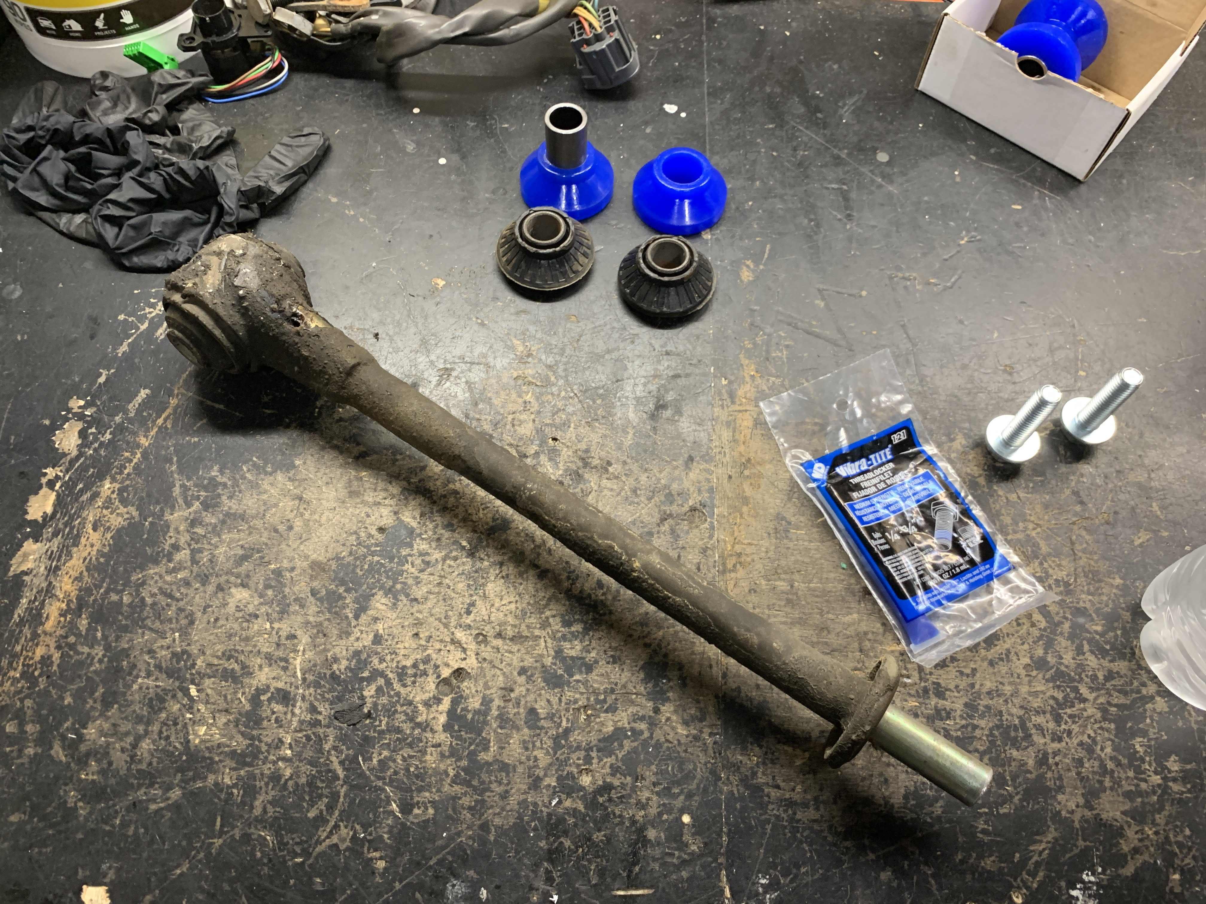

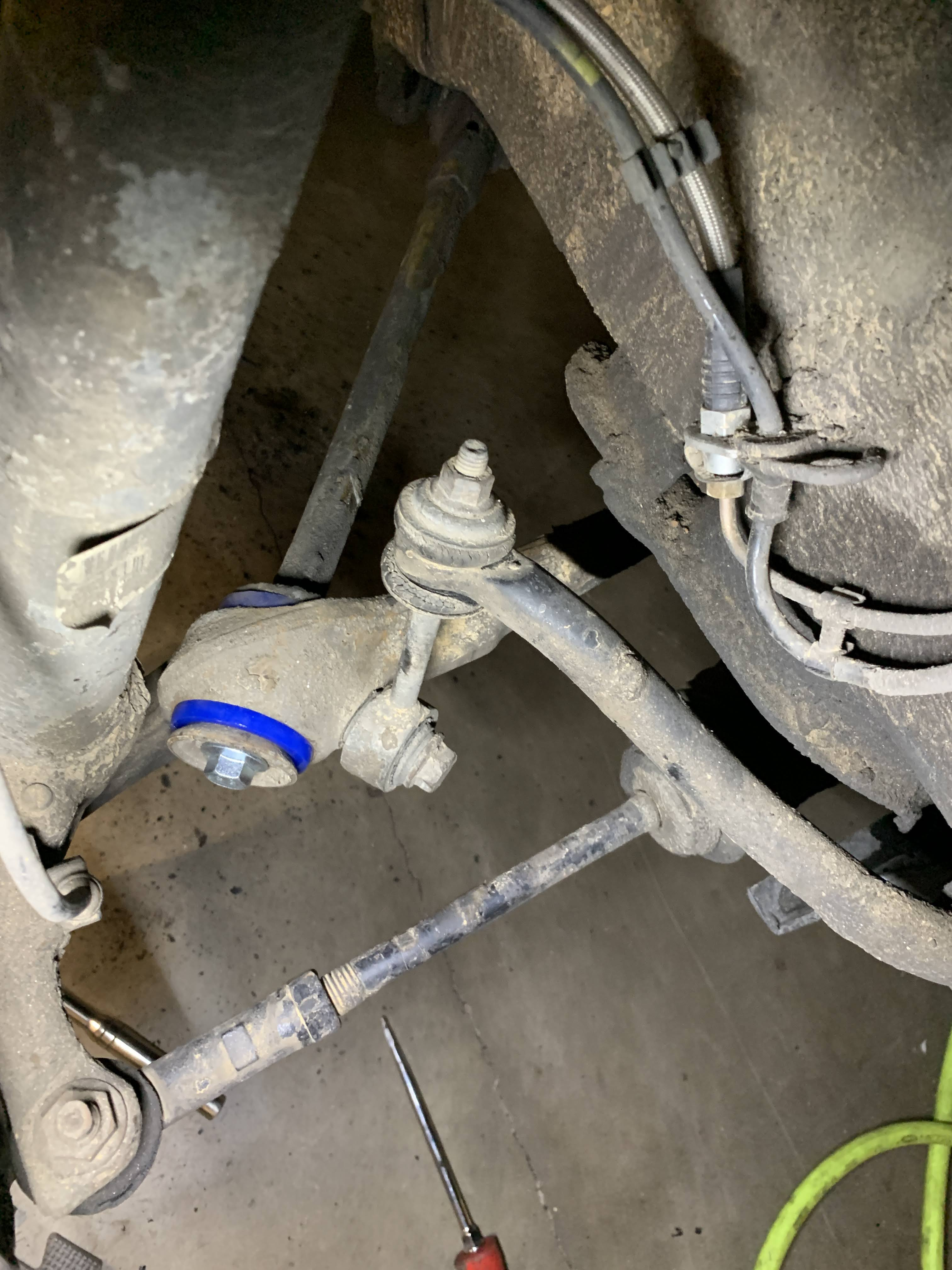

Then I pulled my 940 into the garage tonight and replaced the worn out old strut rod bushings with fresh iPd poly bushings. Easy job... I love the RWD cars. This should tighten up the front end a little bit. Now I just need to replace the tie rods, sway bar links, and ball joints. All of the rubber bushings look surprisingly good!

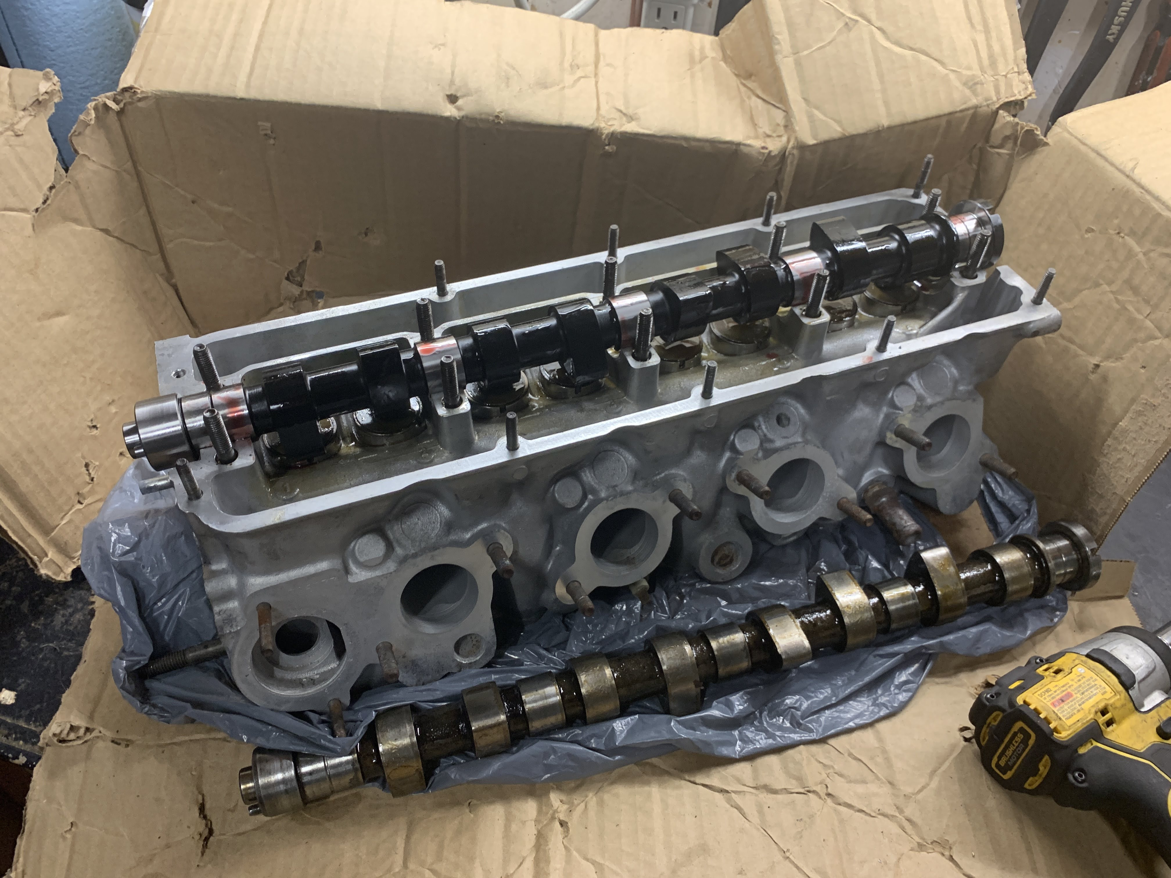

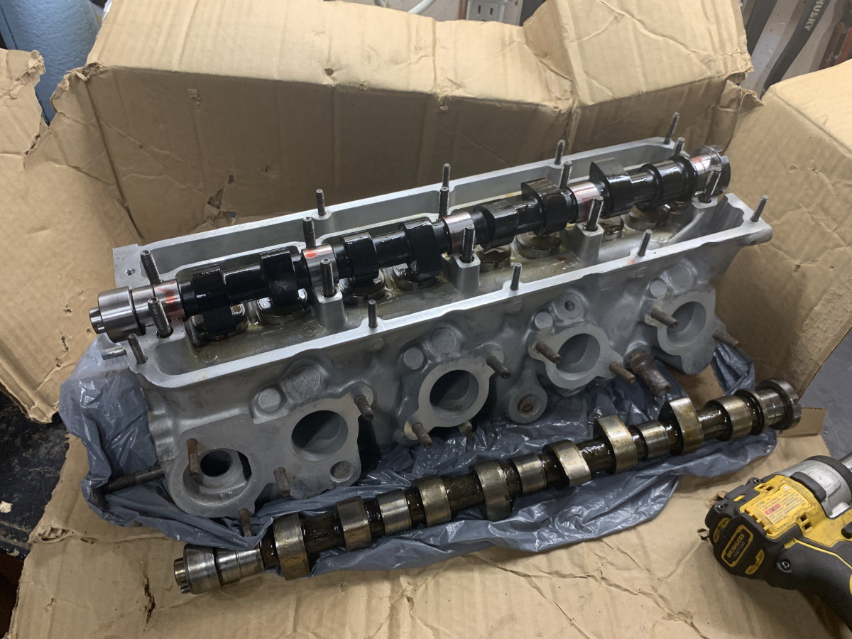

The iPd billet turbo cam is also looking nice sitting in the reman head that's soon to be put on the 940. Just need to order an angle flange downpipe for my 16t, then I swap everything.

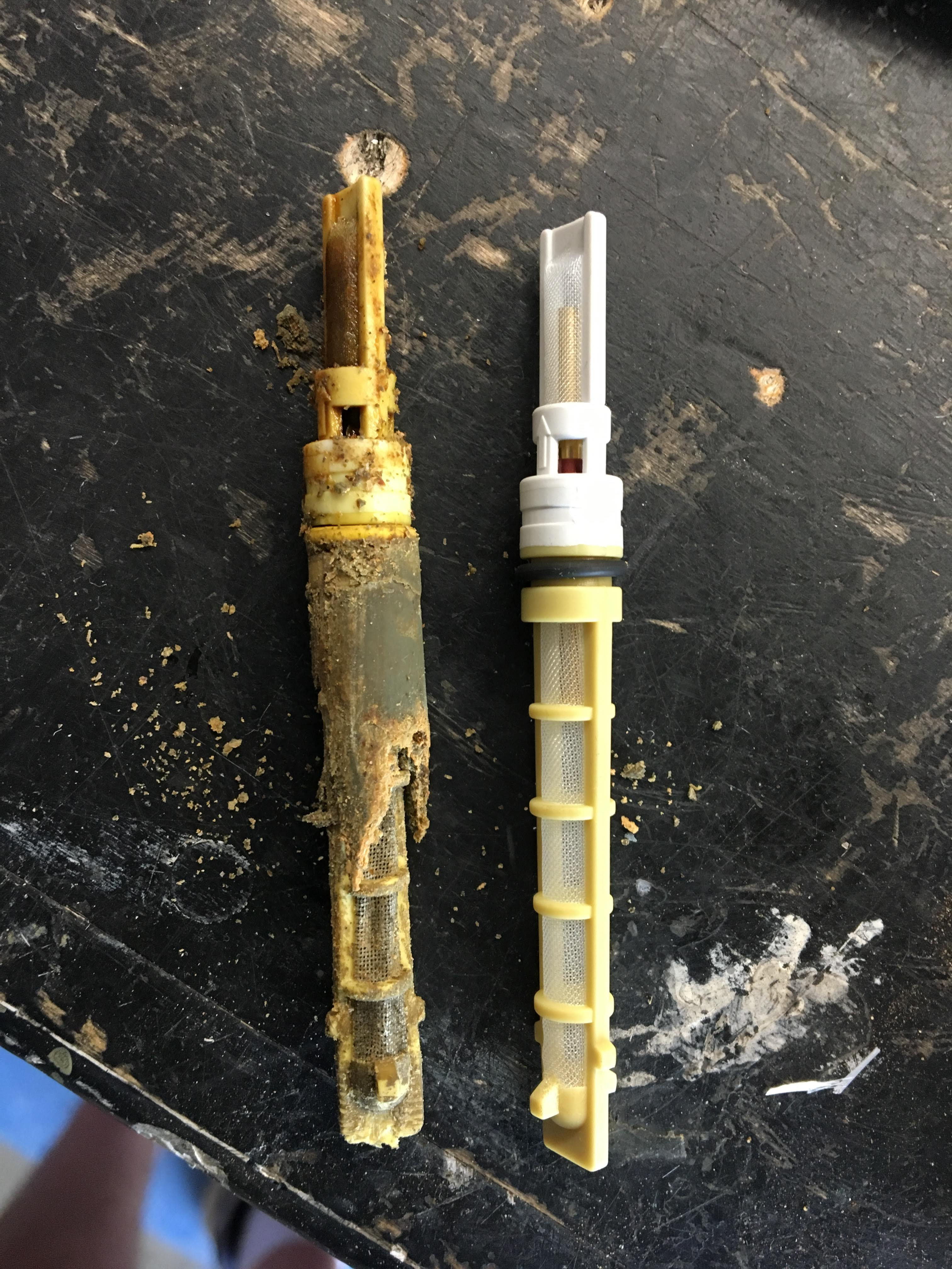

Good lord those "quick" disconnect AC lines are a nightmare to disconnect. I keep finding custt build up at the connections. I wonder if years ago I put a can of R134a that had some kind of stop leak in it. Also the orifice is a ***** to get to.

You wanT to put the Orfice tube in, seat the orings but leave the nuts loose until you get the hard lines seated into the evap.
Once those lock, nip down the nuts with either open end or crows feet.

That makes more sense to me. That line for me was under so much tension it took about 20 minutes of pulling and working to get it out. I also love that the nut has holes on either side for penetrating oil. Luckily this one came apart pretty easily.

Ugh those quick disconnects SUCK. Such a pain to release. I bet that orifice tube is nasty, mine was caked up with so much garbage. I guarantee someone used stop leak to try to fix the evaporator leak, but of course it won't work since it couldn't get past the orifice tube.
