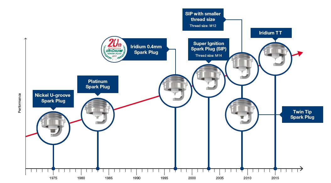

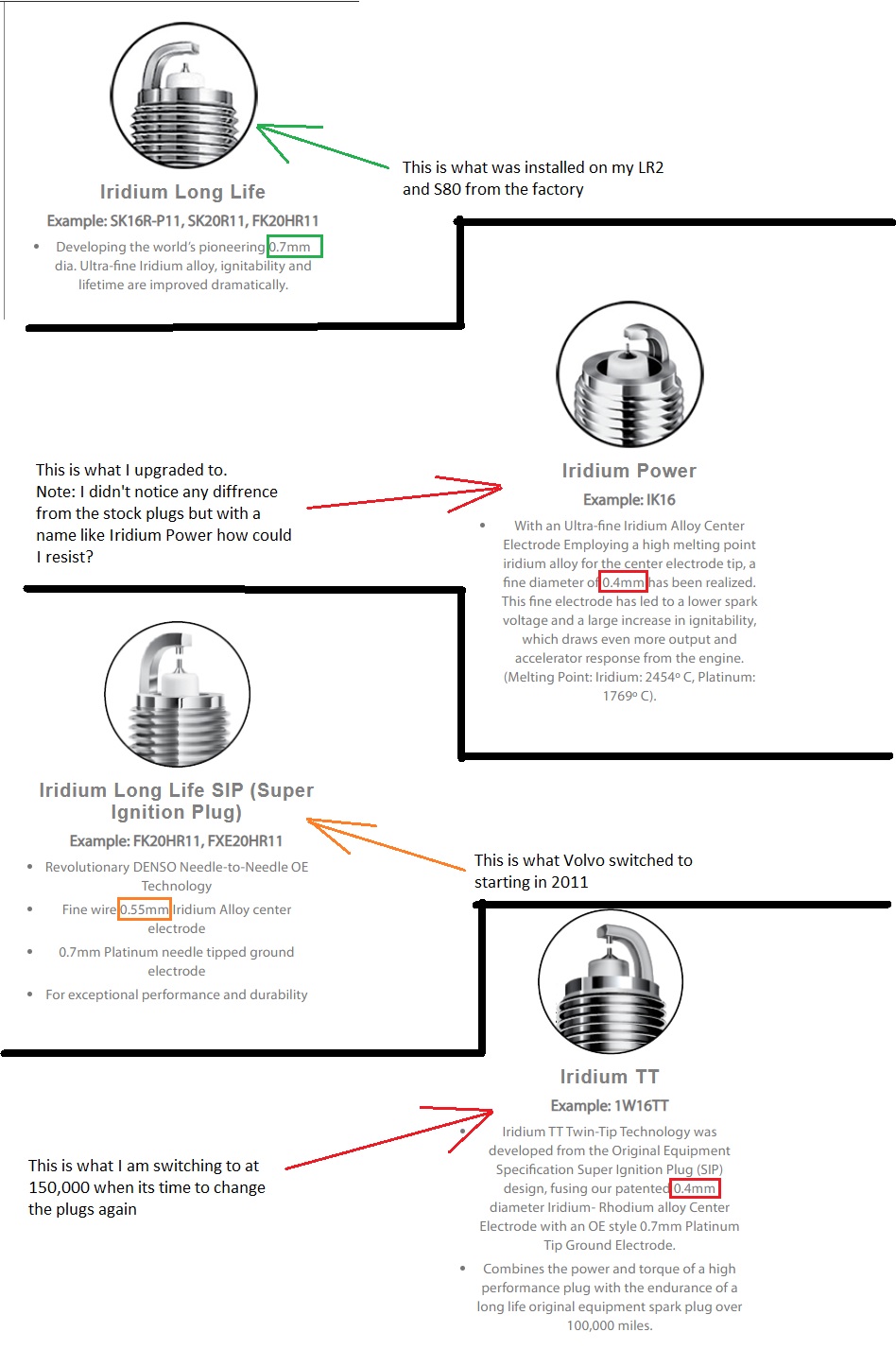

chitownV wrote: 23 Jul 2020, 21:41 Good work. Oh I am not disagreeing with you, even FCP carries it. I am trying to understand why Volvo would have separate types of spark plugs for early models, then 2011+ have a different set of spark plugs.
The answer to you question is availability
In 2007 the Denso SIP was still new and unproven
So the Engineers in the Premier Automotive Group chose the simpler fine tip Iridium.
This was the conservative safe choice.
By 2011 something changed the minds of the Engineers.
Note: the 3.2 design didn't change significantly
So for me I am choosing to use the latest design that was qualified by the Volvo Engineers.
Having said that any of the spark-plugs from the picture in the post above should work fine.
My Goal is to make it to 300,000 mile on the original coil packs and original catalytic converters.

Though I have not used the newer Denso plugs, I can agree based on the specs. NGKs and original Volvo branded ones too. Buy from FCP and you can warranty them when the time comes.pgill wrote: 24 Jul 2020, 10:05 Having said that any of the spark-plugs from the picture in the post above should work fine.

Based on my personal experience owning two 3.2's and from what I've read on the forums any of the Denso Iridium or Denso Iridium Twin Tip will work very well in the 3.2
If you prefer you can buy the Spark Plugs in the Volvo Packaging and pay a little more
(as you can see from the picture I posted above the Volvo Spark Plug has the Denso Part number on it)
Based on my personal experience with my friends Toyota the Denso Iridium Twin Tip are helpful in eliminating the Catalytic Converter efficiency code (P0420)
I can't say for sure why the TT's worked but if I had to speculate it is due to superior ability to ignite a lean mixture.
The ECU adjusts the mixture and it checks the response of the O2 sensors before and after the catalytic converter.
So for my $$$ I'm getting
IKH20TT
or
FK20HQR10 --> (you can buy these in a Volvo box p/n 31286359, just remember your Volvo is a 2011 3.2 or newer)
Note: there is nothing wrong with the regular Iridium spark plugs
I change mine every 50.000 miles
