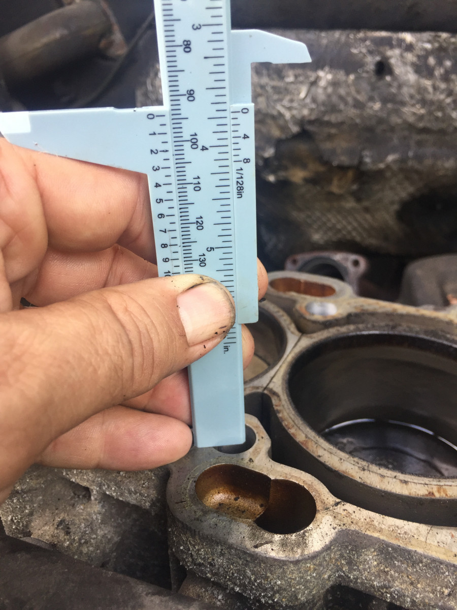

I snapped a picture from a long block I had lying around to get an idea of thread depth
Approximate 94 mm
Approximate 94 mm

Pump some good penetrant into both of those stud holes on #3, fiddlemaster
Kriol, Liquid Wrench, PB Blaster
