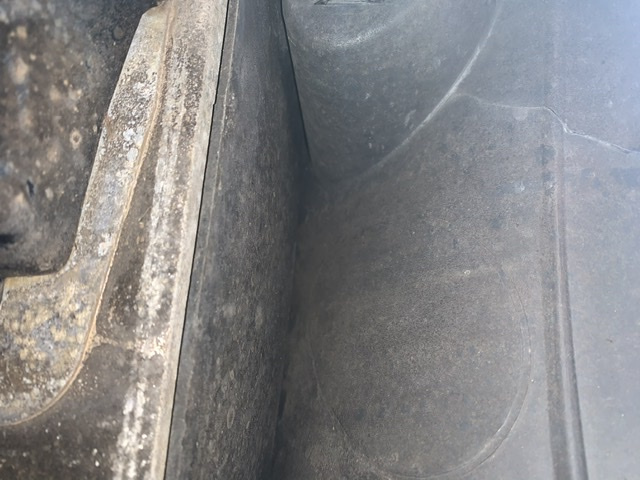

It’s kinda hard to see the outline of the circle, but it’s there.
I was hoping maybe someone who’s done this before could chime in. Volvo got smart with these foglamps on the 70s series, they were a breeze to do in that car and required no cutting of the bumper.
Not sure why the picture is posting sideways I e tried it a few times now. In the shot, the “right” side is the bottom of the bumper.

I see them, good pic. I know the two circles because I considered doing this in my 96 at one point. However I never checked if a factory-fogs bumper has anything similar.

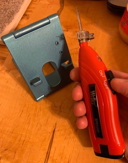

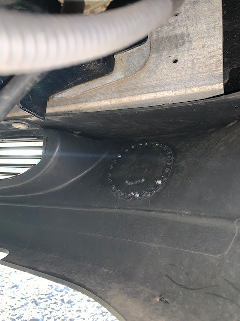

I was determined to find a way to cut these holes without pulling the front bumper off. I could not get a drill anywhere near the circle indents except along the bottom. Plus, the bumper is really curved and the drill bits had a hard time gaining initial purchase.
Looking around, I found my Weller battery operated soldering iron. After testing it on some similar plastic types (bumper seems to be ABS; not too hard), I determined it was a good fit. I put blue painter's tape on the outside of the bumper in the general area. Punching the holes with the soldering iron went slow; the angle of attack is still wonky but it did the trick. The tip kept coming off when I would retract it, so I put a small cable clamp on it. The soldering iron is just hot enough to slowly melt through the plastic, but doesn't seem to be hot enough to cause flames or even adversely affect the paint in the surrounding areas where I missed with the blue tape:
Warning: This should be obvious, but if anyone else tries this, do remember the soldering iron is HOT! Don't burn yourself. Work slow and pay close attention to what you are doing.
Not having anything to base the size off of other than the OEM trim rings (which are hard to measure being an irregular oval-ish shape), I opted to keep the holes just on the inside of the inner ring of circles on the inside of the bumper. Once I get the basic cut-out done with a cordless rotary tool and sheetrock cutter bit, I will use the drum sander attachment to round out the cavities little by little until they are big enough to install the trim rings.

- Soldering gun with tip held on with small cable clamp. Test piece right behind it. Takes a few seconds.

- foglight1.jpg (106.79 KiB) Viewed 1841 times
- foglight2.jpg (113.74 KiB) Viewed 1841 times

Make a hole start with the soldering iron then a thin hacksaw blade or a loose jig saw blade would go through like butter. Or, my favourite tool of late, a Dremel and an excuse to go to the store and buy yet another bit, amidst eye rolling from the Admiral.
