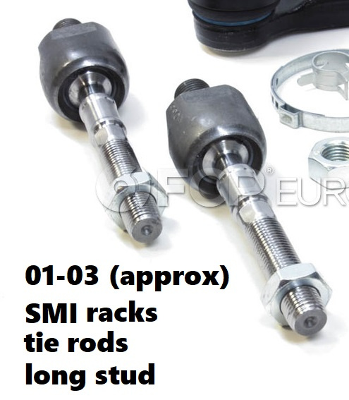

Same for L&R, just different between the different models of racks. I believe these also need blue thread lock
01-03 with SMI racks appear to have longer threaded section, compared to 04-07/9 with ZF racks. Not interchangeable because the toe cannot be fully adjusted.
01-03 SMI https://www.fcpeuro.com/products/volvo- ... it#fitment
mid 04-09 ZF https://www.fcpeuro.com/products/volvo- ... it#fitment
