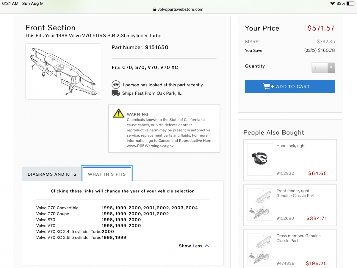

abscate wrote: 08 Aug 2020, 03:31 I’ve forgotten the Colonial translation of “slam panel” Cookeh....
I do apologise, I tried my best to use the correct Americanisms. P/N 1372541 for the 850s, though oddly this brings up nothing on volvopartswebstore. It is the fibreglass panel at the front of the car that the hood latches into, the headlights, washer motors, and horn bolt into.
EDIT: Found it, after much searching. P/N: 9151585, superseded by 1372541 (1372542 for the option without holes/fasteners for the headlight wipers). I've still quite no idea what this would be referred to stateside though.

Called a ‘ front section’ you Volvo. I fruitlessly searched for it in the Body section, but of course could find Cookeh 850 front section because....
He used a part number
Posts: 35299
Has thanked: 1505 times
Been thanked: 3818 times
Found it for the 1998 1999 2000 only
Part 9151650
I’m going to put the one I harvested into safe storage as it’s $600 new
