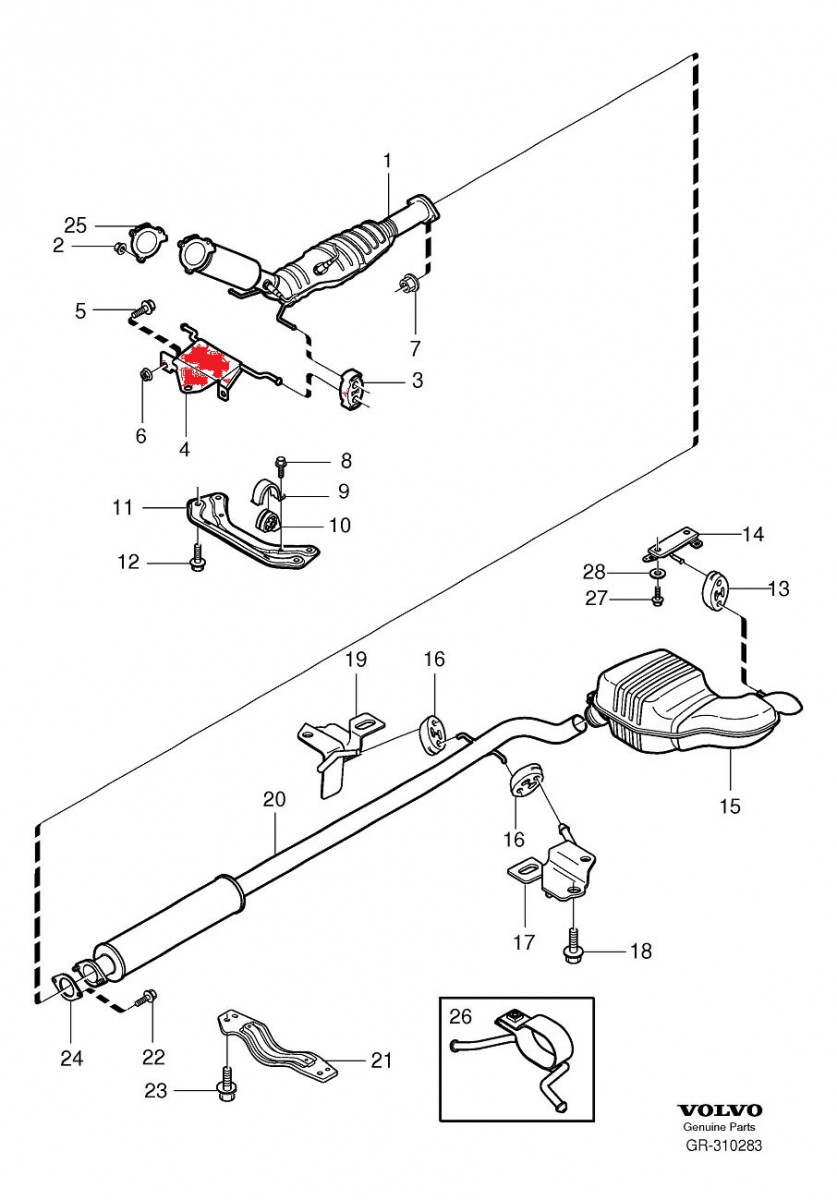

xHeart wrote: 18 Apr 2020, 18:38 Cleaned off rust on the hanger and gave it a hight temp rust prevention coating. The two retainers are good, no crack or tounge damage. Inserting 2 rubber rollers as spacers around the hard brake line.
This part is subject to an update says VIDA. Looking at your subframe you dont need to drill holes to update new style bracket..lucky

darrylrobert
Posts: 472
Joined: 06 Mar 2020, 06:25
Year and Model: 2001 v70xc M58
Location: australia
Been thanked: 27 times
Post by darrylrobert »
Sorry part number 4 is the updated bracket. its attached to the subframe instead of that (part 4) crossmember. The crossmember then only supports one brake line.
VIDA lists this part as a recall item or similar. Not sure what the design problem is, i replaced it because one of the (item 10) rubber mounts was torn. I had to drill holes into the subframe which wasnt easy.
Its definatly more secure than it was before, if your mounts are not torn then i wouldnt worry.
