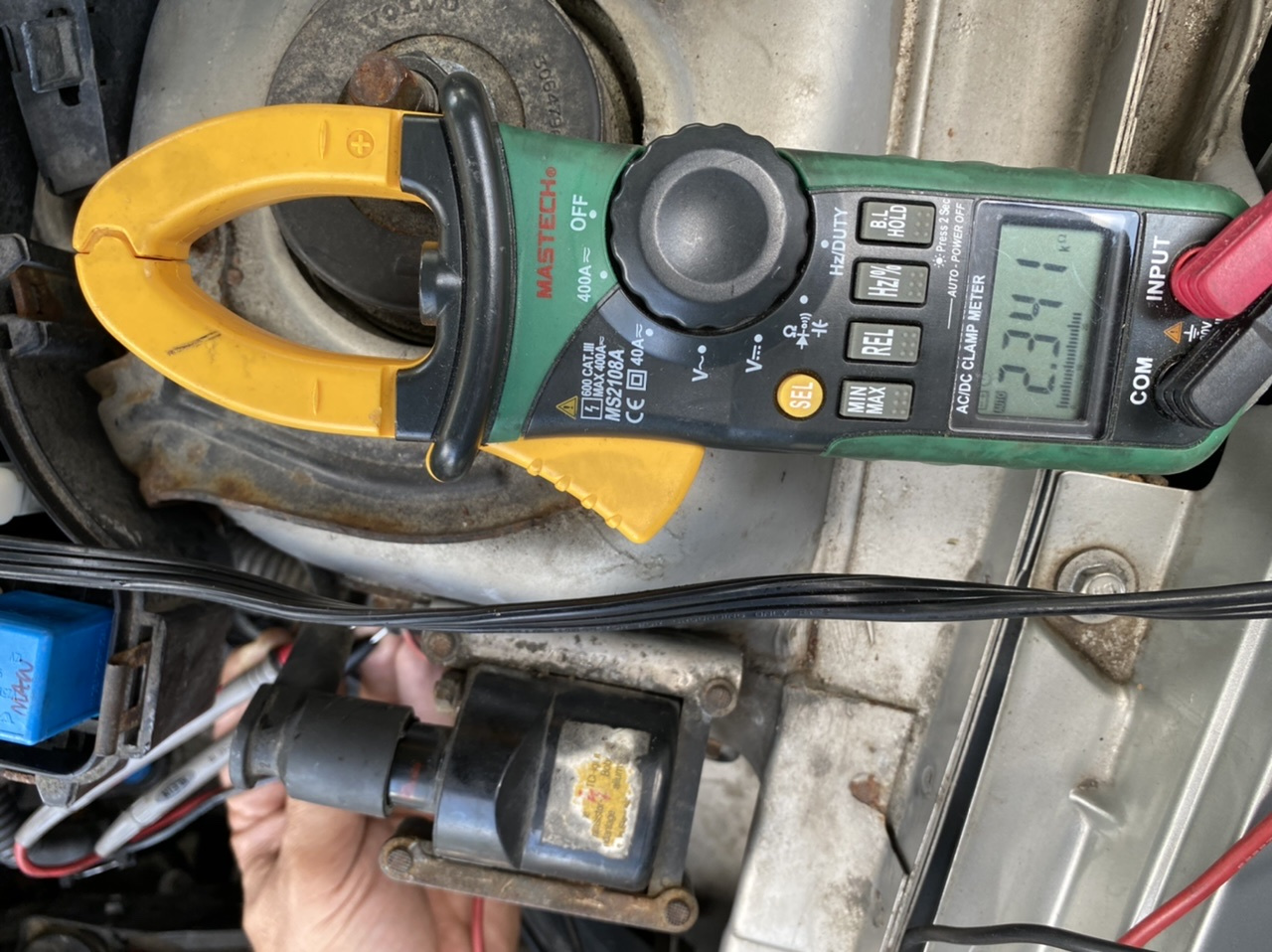

Coil module checking
At threaded pins on coil primary 1.1 ohm, sounds right
At connnector, 2 kOhm.. sounds wrong
And at secondary 15KOhm Sounds high 2x
Will check specs
Will check specs
