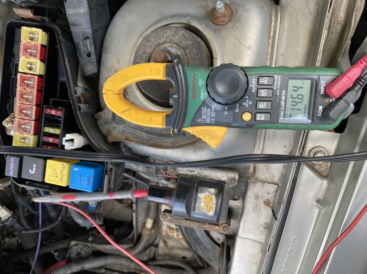

Coil module checking
At threaded pins on coil primary 1.1 ohm, sounds right
At connnector, 2 kOhm.. sounds wrong
And at secondary 15KOhm Sounds high 2x
Will check specs
Will check specs

Clutch switch. I can start my 95/94 with the clutch fully engaged. So no need to push the clutch to start.
Three things needed to fire an engine, air, fuel, and spark.
You have spark at the plugs so they should fire. It's possible that there isn't sufficient spark at the coil. Mine went bad and did the same thing. Just swap quickly with a known good.
Thoughts: make sure your maf isn't melted after that front fire... Not speaking from experience or anything. If it is just unplug it.

You have spark at the plugs, BUT do you have spark at the proper time in the cycle? This has a distributor, right? Did you remove the distributor doing work? Try using an old timing light to check proper spark timing. Distributors can be tricky to get proper spark timing.
