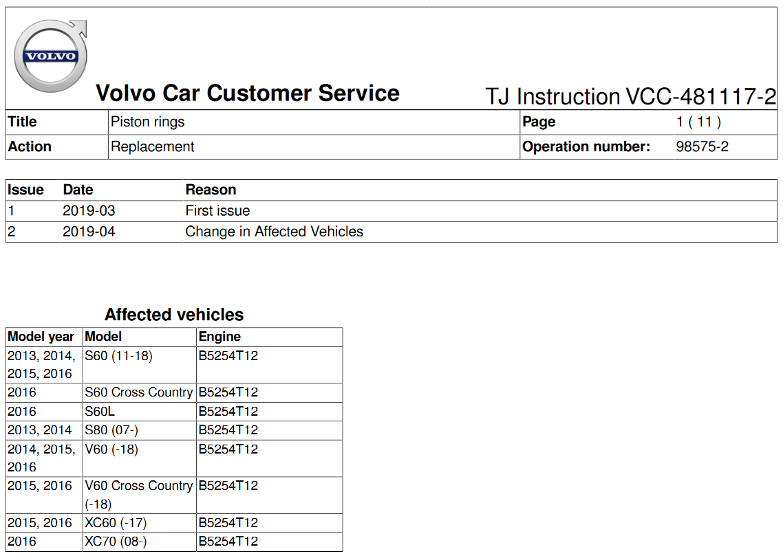

Oil Consumption issue? See if it applies to yours. The oil can only leak, go into the radiator or out through the piston rings.
https://forums.swedespeed.com/showthrea ... on-Lawsuit
Technical Journal - NHTSA
Apr 16, 2019 - Lubrication and oil system/Excessive oil consumption. VST Operation ... 2016. V60 (-18). B5254T12. 2015, 2016 V60 Cross Country. (-18).
https://static.nhtsa.gov/odi/tsbs/2019/ ... 4-9999.pdf
