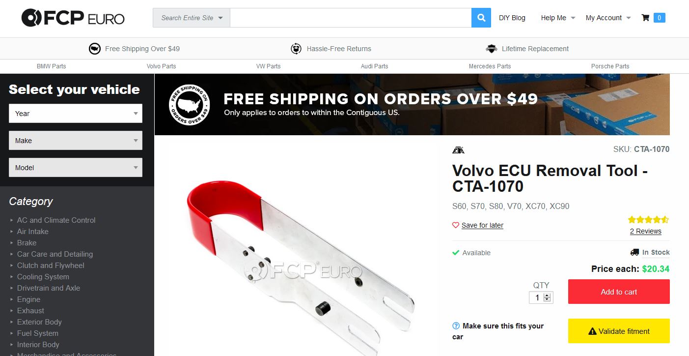

This is the tool for ECM and TCM.
Sudden codes and pour drivability!

Thanks! I just did an FCP order today, this wasn't on my radar when I made it. It going on the list for the next order.
