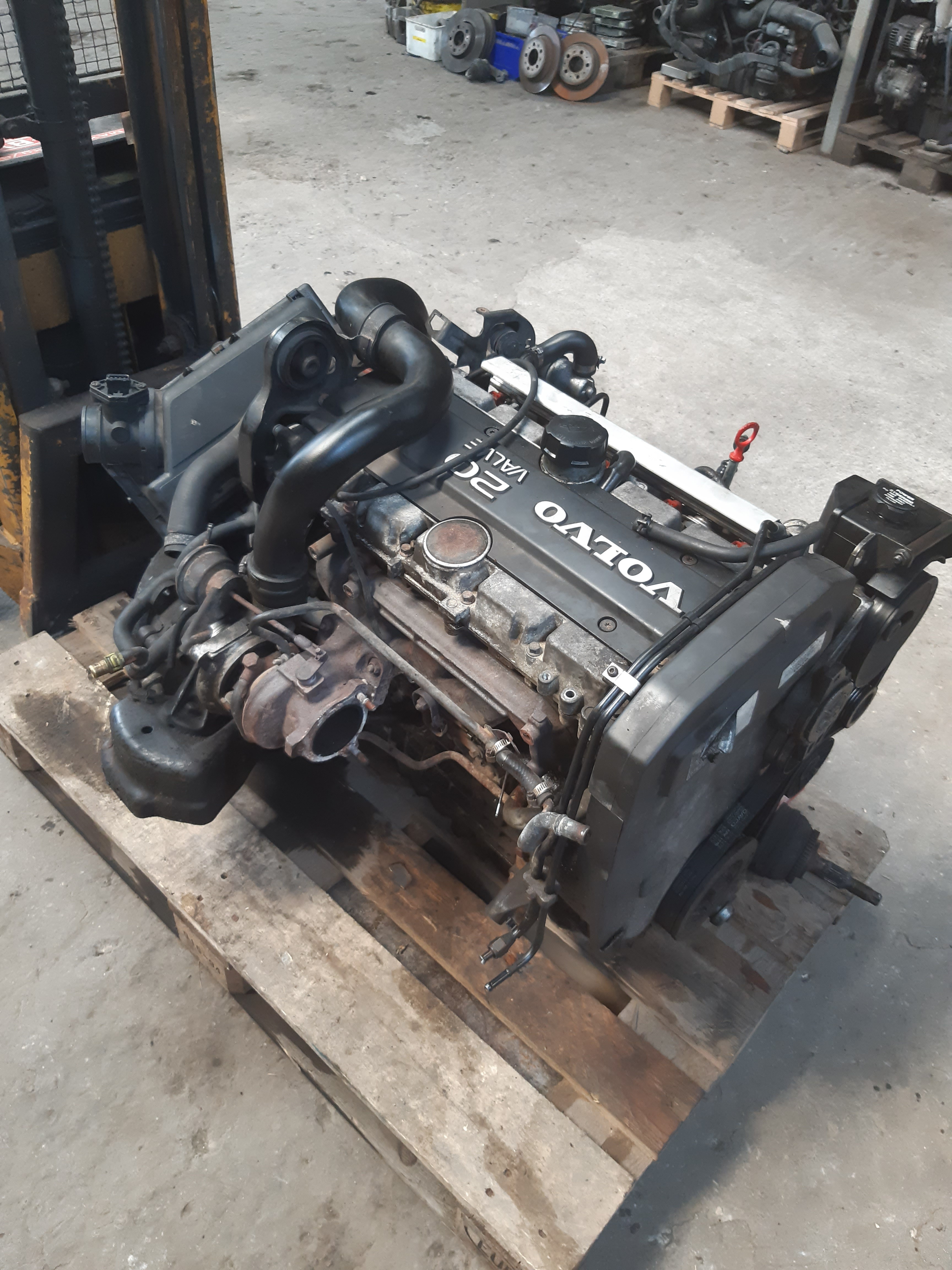

I bought a Volvo 850 T5 (2.3) from a guy I know well because I needed the engine for my own project car. The T5 was driving really good and pulling like crazy so that engine was kind of approved :) Besides that it also has a very low mileage.

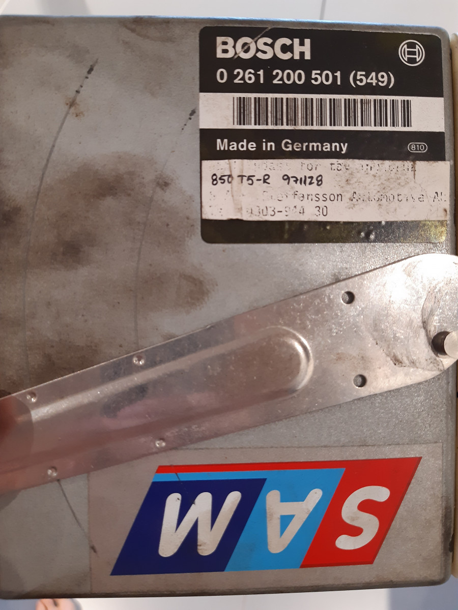

Anyway when I unmounted the engine I discovered that the engine was a 2.5 instead of the expexted 2.3! Obviously it has been replaced at some point back in time BUT the very interesting part is that the ECU was the 2.3 :shock:
Sensors and stuff like that I see is the same on the outside but still, how about ignition points, compression, volume and all of that.. how can this ECU work together with the 2.5 ?

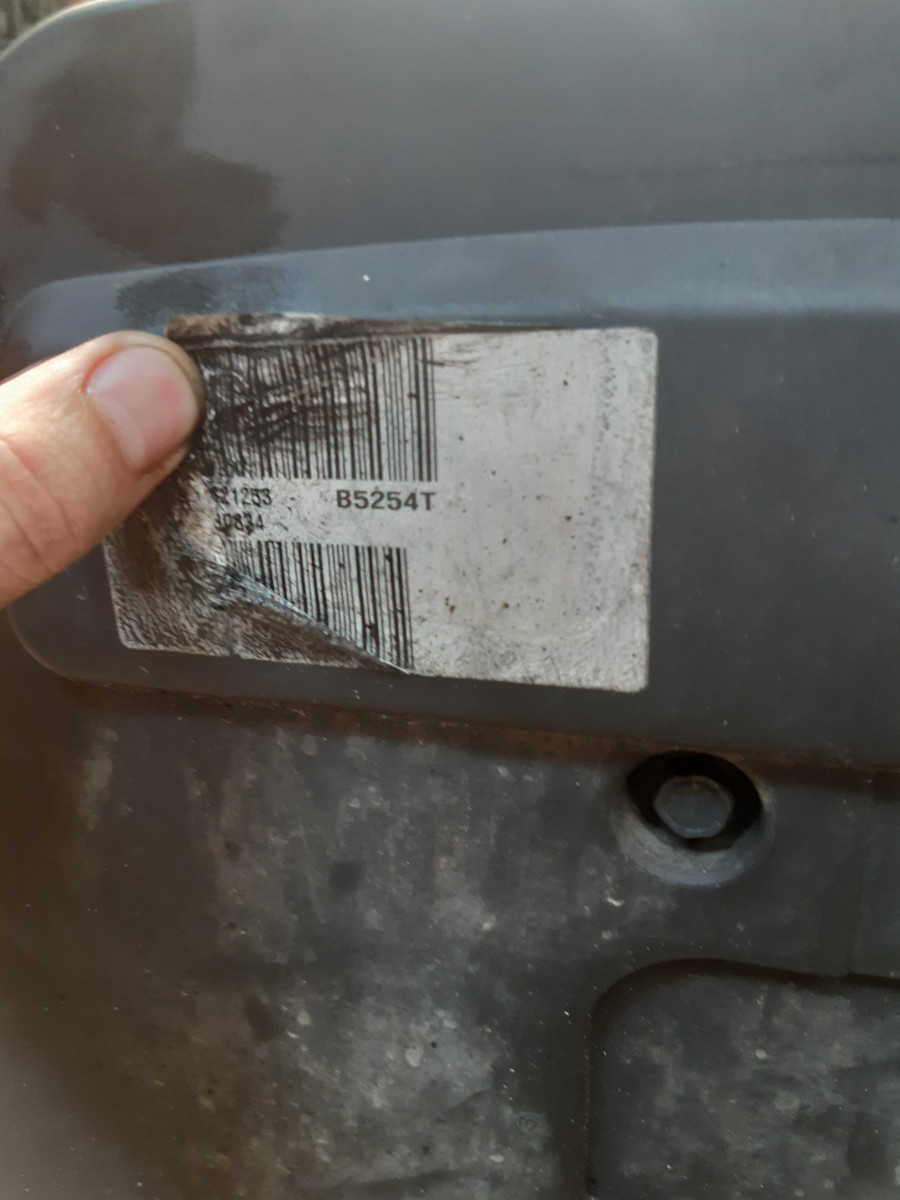

I did control the engine code on the block itself and it does say B5254T

So we call that the 2.4 low pressure turbo here in the US. The 2.5T is the later low pressure turbo used in the s60 etc.
The biggest difference between your current engine and the original engine is slightly higher compression 9.6 vs 8.5 IIRC, and slightly larger pistons 81mm vs 83mm IIRC.
Someone probably just pulled the engine, swapped the intake, exhaust, turbo and injectors and popped it back in there.

However...Looking at that "SAM" sticker on the ECU and a quick Google shows that *may* be a tuned or chipped ECU (Sam Steffansen), but it doesn't look like he's active any longer. Opening up the ECU would show if it's been altered in any way.

Looking at the engine picture it's also visible that the injectors are red which are the stock ones for the 2.5T
"SAM" was the Volvo team that tuned the 850 for the race track back in the 1990's and can be considered as the former Polestar :)

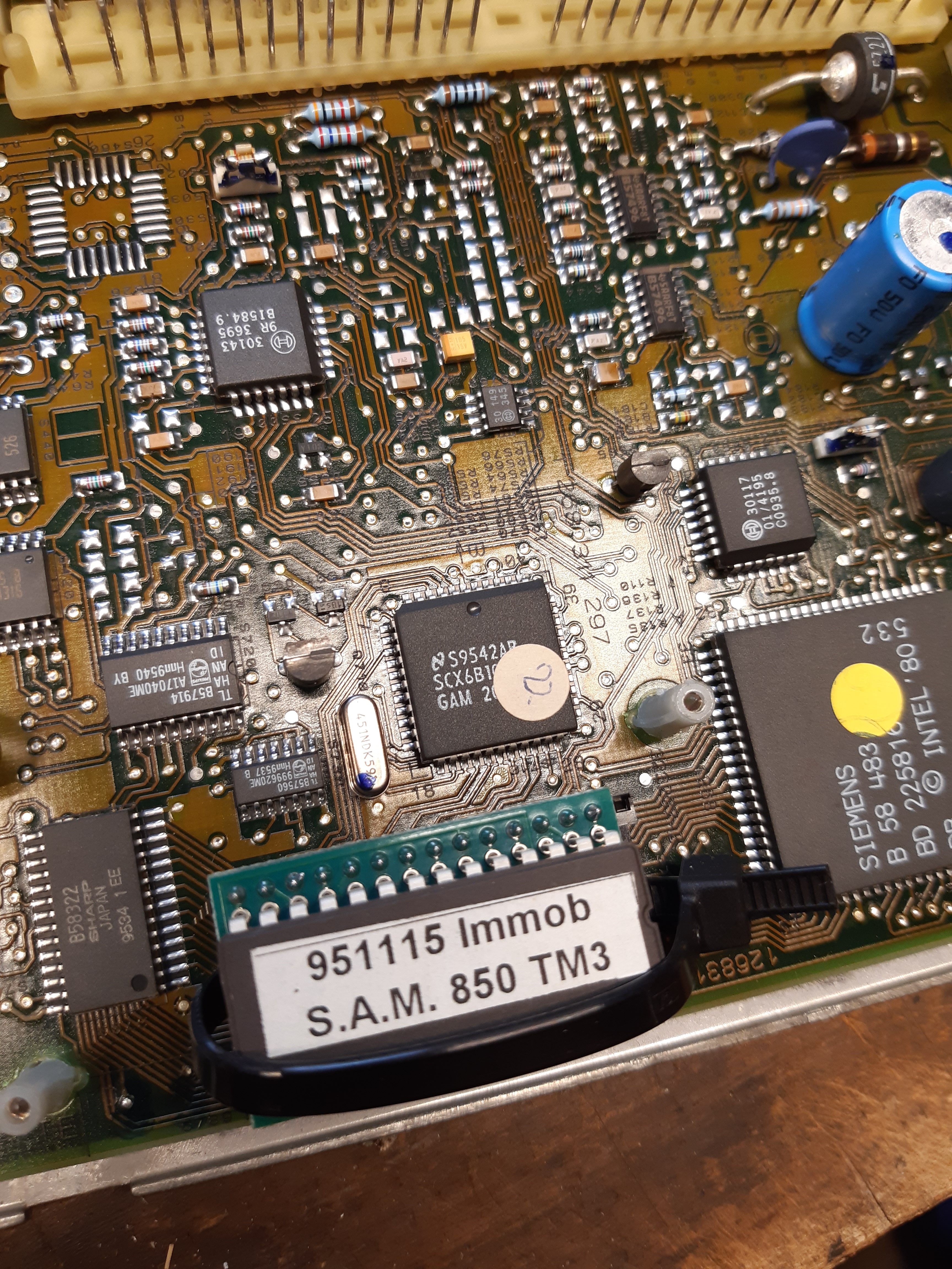

I did that with another SAM ECU once and the original chip is replaced with a socket where the tuning chip is mounted. That's basically what SAM was doing as a business back then. Attaching a picture.
