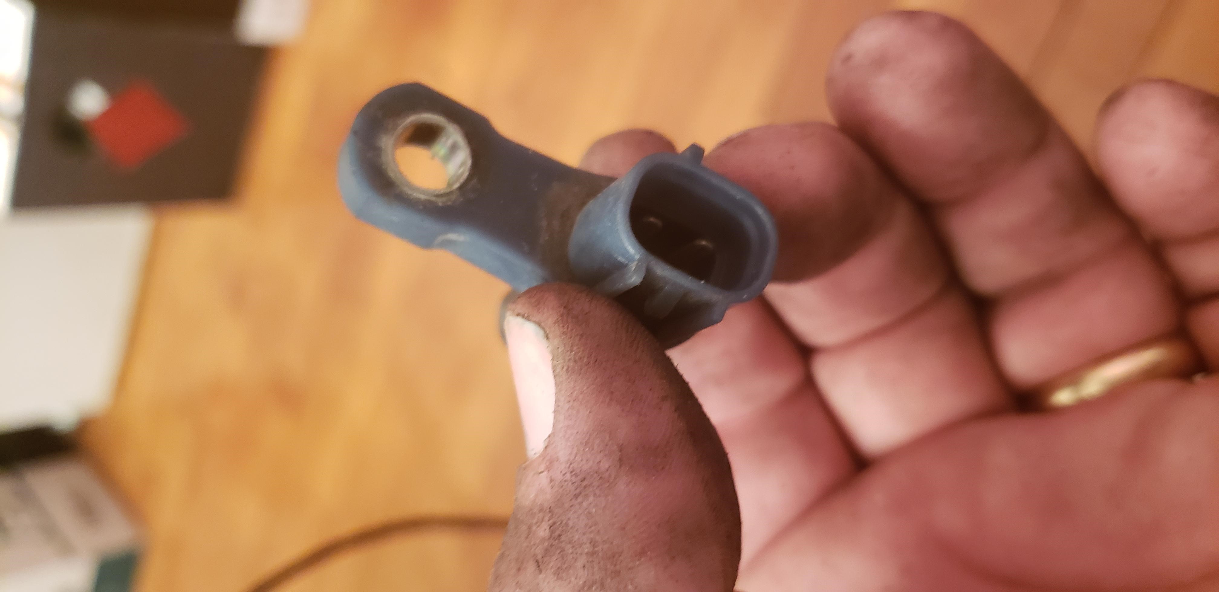

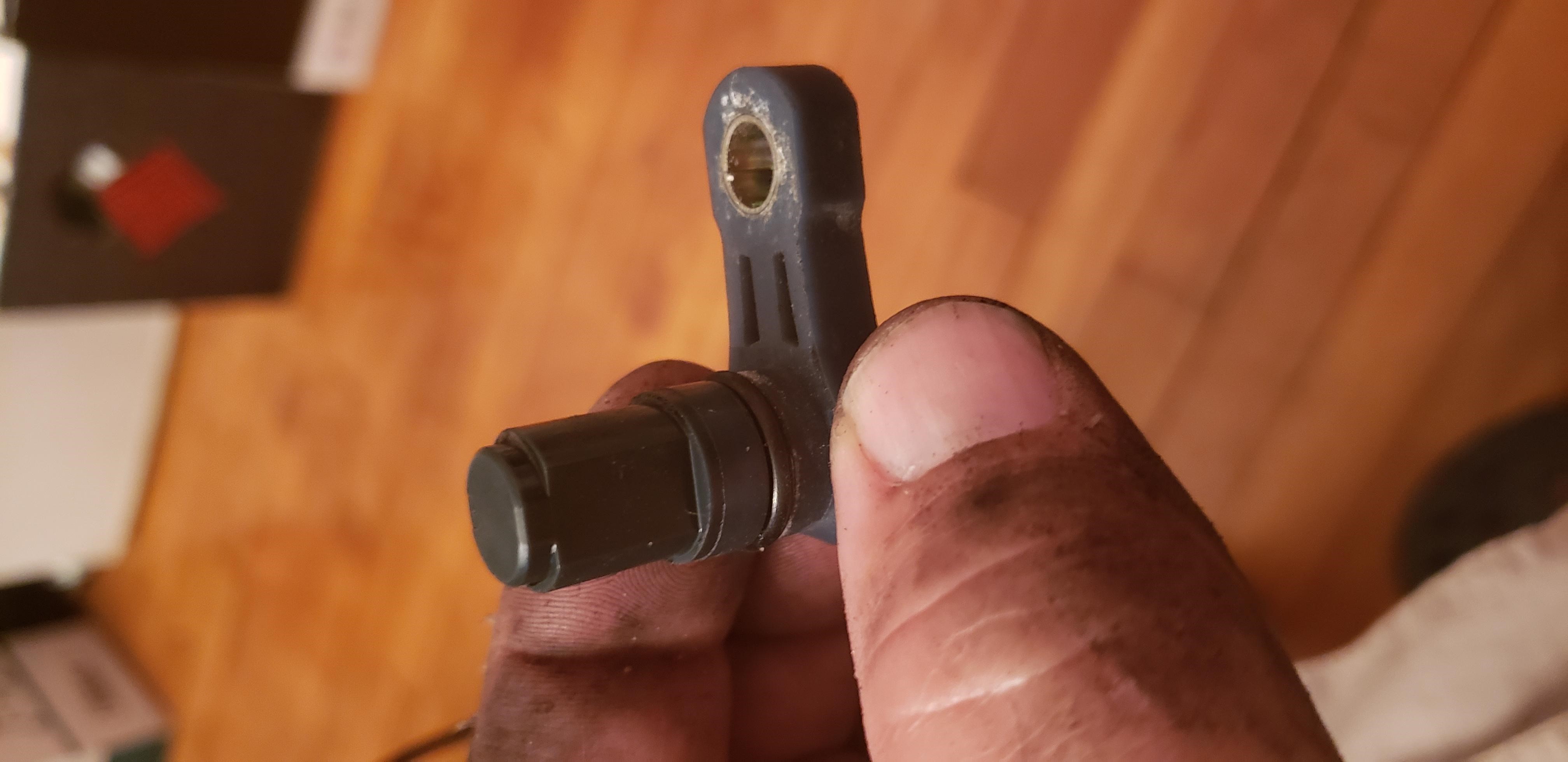

I think I've narrowed this down to crackshaft position sensor. Just idiot proofing myself here...I pulled it, but it looks a little different than what's available to order online.
Came off of where transmission meets the block, under the airbox, beween firewall and neutral safety switch. I'm like 93% cofindent this is the right sensor, but the ones online have a 90 degree turn at the connector instead of straight on like this one.
Resistance test is way off.
This would explain the rough running I've been having, the sudden death in the road, and the failure to start.
