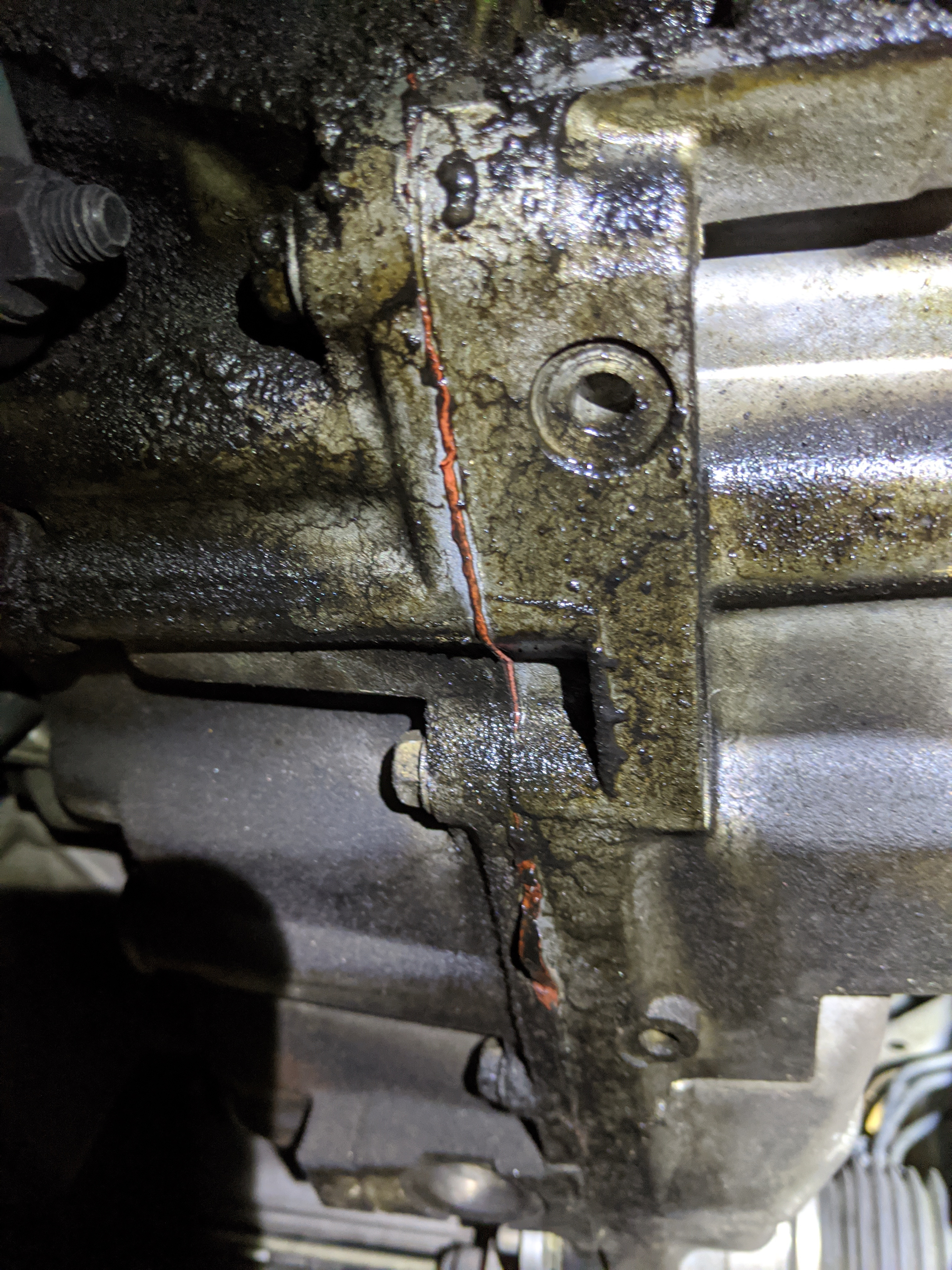

Today I drained the tranny gunk and refilled four times until I was happy with the result. 12 and a half quarts of Toyota T-IV fluid. I really hope that's the right stuff. Ha.
I'm really miffed at the shop I took Ben to for the PPI because they did not mention the transmission had all that gunga on it. I'm not sure if there's a leak or what. The level was fine and I didn't see any neon arrows. The filter tube wiggled a little so it could be the o-ring or the gasket on the pan I haven't looked up the name for yet. When I change the oil I'll hose the area down with brake parts cleaner and see if it's recurring or maybe the PO missed a lot when trying to add ATF. His aim wasn't the best with the oil either.

That’s probably either a seeping rear main seal Or the turbo drain line o ring (cheap but a bit of a hassle ) . That might be a couple years accumulation so you may even find a high-mileage oil synthetic will slow it

If it is a seal issue the AT 205 could work.Starbuck wrote: 16 Aug 2020, 06:23
Thanks Abscate! I'll put coils and your pipe thing on my list of parts to accidentally buy. I did notice there's oil on my turbo too. That shop and I are having words soon.
https://www.amazon.com/ATP-AT-205-Re-Se ... 771&sr=8-1
It took care of a mystery seepage which never drip in the driveway. It was probably leaking before the transmission work as it was a mess like yours, The car also had oil burning smell through the vents when I first purchased it and is gone now.
