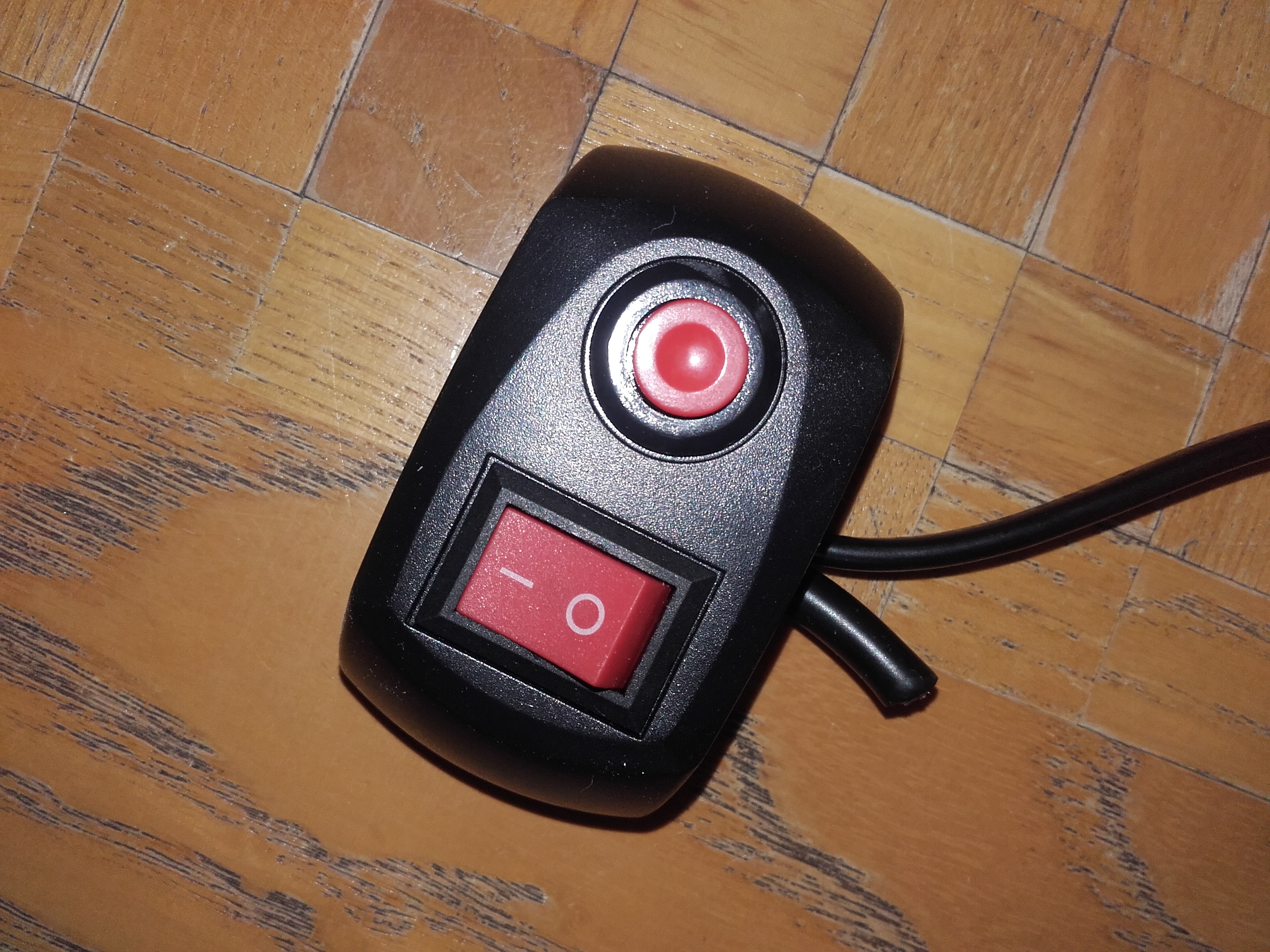

Then for the wiring and switching part: After inspecting the switch-unit that was provided with the lightbar, I decided that I did not want to use this because of the way it looked (cheap) and started looking for a way to switch the lightbar from the dashboard.
This is the original switch.
The lightbar has two switches: one switch to switch it either on or of, and a tapping switch that allows you to choose different flash patterns.
