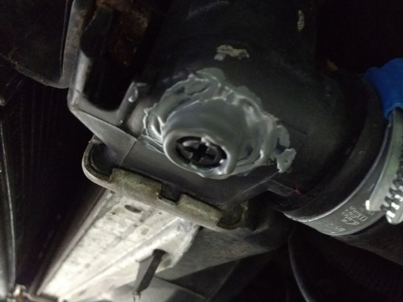

And when you get it, JB Weld it! :lol:

Did you do that because it was still leaking? Or just in case?
