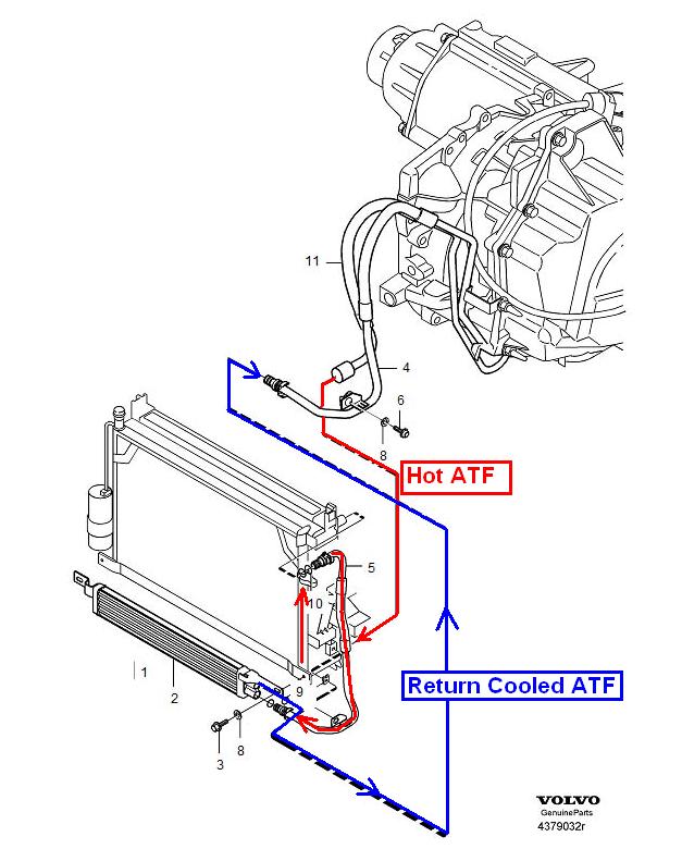

Try doing a test-fit by pulling your bumper off and checking mounting position, clearances, and how you would route the lines. I'd agree, second one looks better. If you have a junkyard available, you could also pull a trans cooler and the lines off of an XC90 and mount that (which is what I just did). This might be helpful:
And when you go to refill your ATF:
And some other useful links:
ATF Cooler install on an XC90 (should be similar):
XC90 Cooler on an S60R: https://forums.swedespeed.com/showthrea ... ofit-Guide

The hayden cooler its very expensive in italy for the expedition charge from the usa and i cant find an xc90 at the yard.
I think to mount the 2 cooler whit a metal plate bent and holded by bolt at the metal frame under the bumper. And plumb it by cutting the tube add a magnefine filter and barbed 10mm/3/8 joint whit other idraulics tube.
