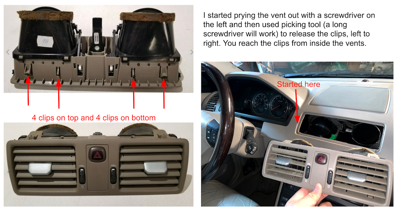

Step1: Take your center vent off
Once you understand how this is mounted, it's not too hard. Start on the left and pry with steady pressure, but then use a thin screwdriver or other tool to reach inside the vent and release the clips. I did this from the left, so you'll release the upper and lower leftmost clips first and then work your way right. When the vent comes out, be sure and unplug the hazard switch .
Removing the center vent.
