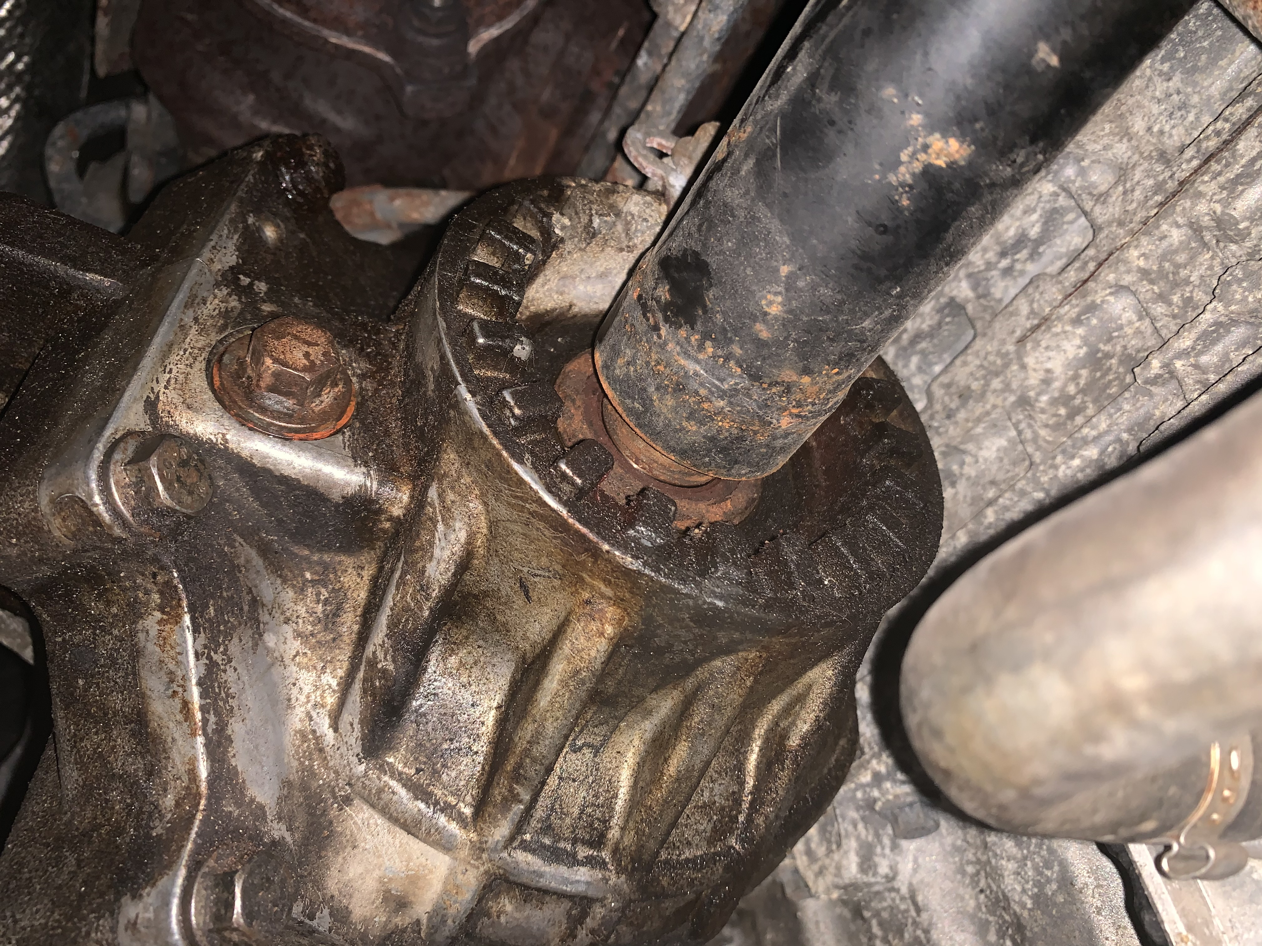

Have you checked your fluid levels? That bevel gear looks like there is a leak. Not saying it is the issue, but prudence says check the level.
As to the issue, check the front CV joint on the drive shaft, they get stiff with age and need to be cleaned and regreased or replaced. The center carrier bearing also fails and causes vibrations.

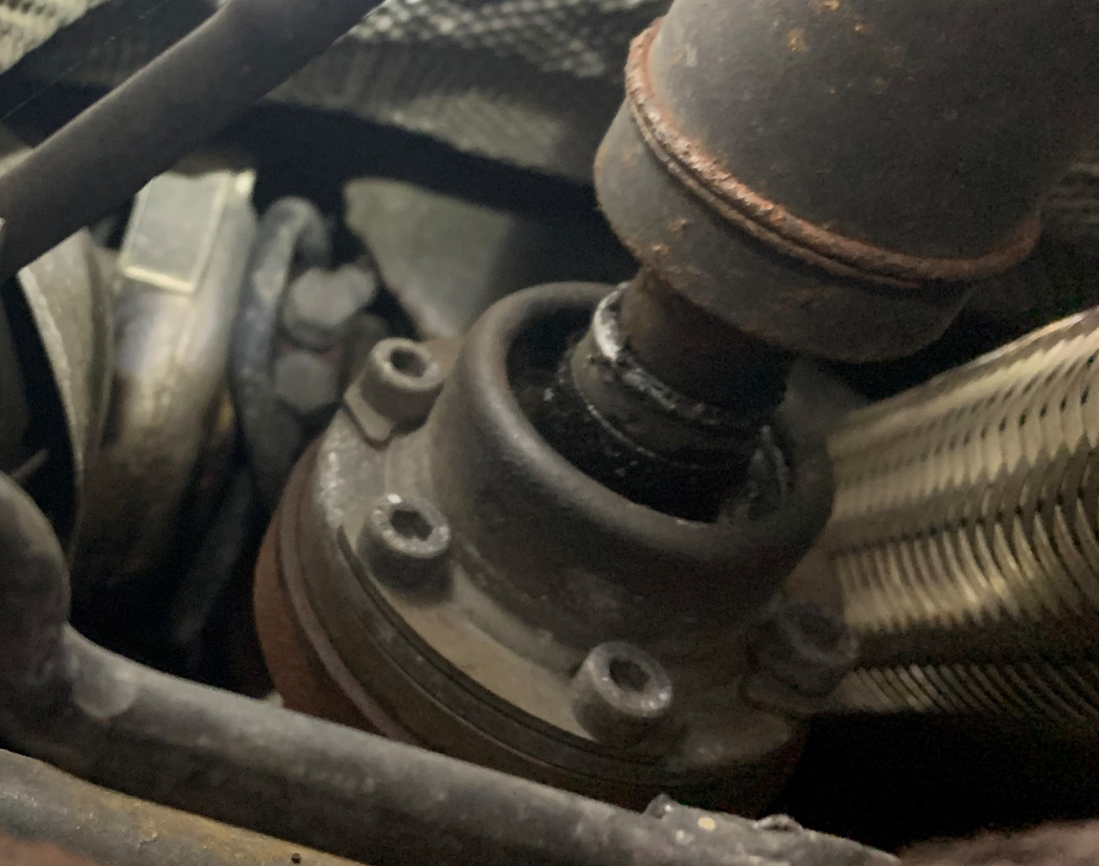

I just attempted to inspect what I believe is the The front CV joint on the DRIVESHAFT (Photo attached). There was no boot so I'm unsure if this is the correct part. If it is , it doesn't have a ton of play, but it definitely has seen a lot of snow and salt in the past 17 MN winters.

Good call on checking fluids, I actually checked the bevel gear (and to my surprise based on the grime stuck to it) it was at a good level and the fluid looked clean. It looks like there is some sort of oil leak dripping on top. I'm also trying to diagnose the root cause there but my current focus is the vibration.

Before that I would check your Bevel gear output flange. Try to see if it is loose and moves around excessively, if so there is likely bearing failure and internal problems. Also see if you can turn the propshaft by hand with the front of the car jacked up, this will test your collar sleeve and bevel gear input shaft which may be valuable to know for later if you decide to fix your AWD.

The boot on the front driveshaft CV joint is “inverted”.
You may want to suck out the contents of the bevel gear (oil) and see how much was actually in there.

Propeller Shaft: I'm a little confused as to what I should be looking for here, Just for loose connections or bearing? Is there a a certain part to be checking?

Bevel Gear: out put flange: I'm a little confused as to which part is the output flange, is that the part that connects to the CV Axles or the propeller shaft?
