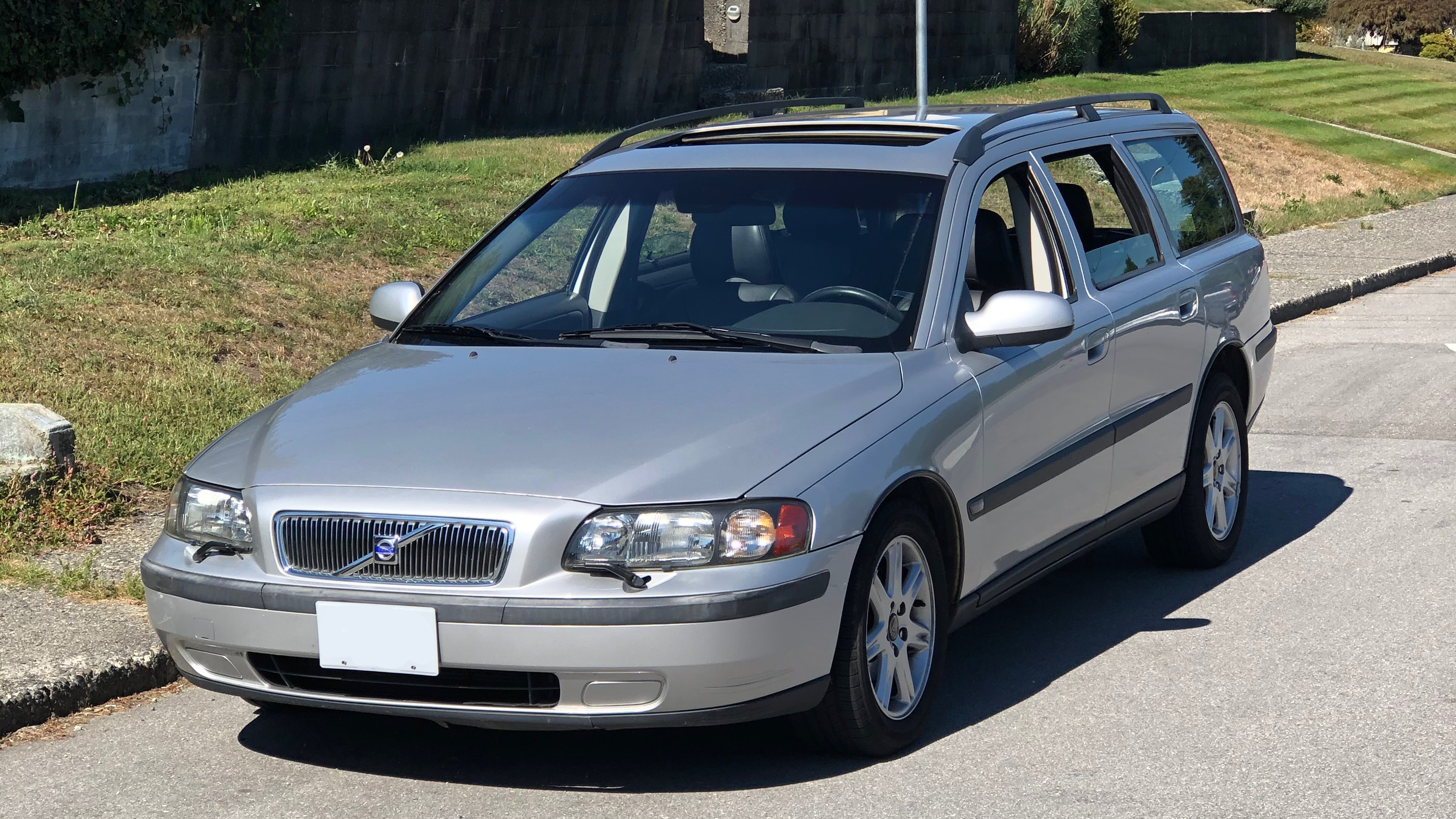

Here he is! We named him Vincent Vega

Thats a beautiful car for $1800 bucks. I can't really help you though. There's plenty of members here that will probably be able to help you once they see your post. Probably wouldn't hurt to be on the Swedespeed forum as well. Best of luck with it.
