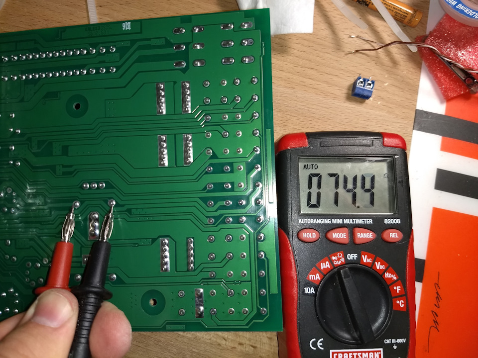

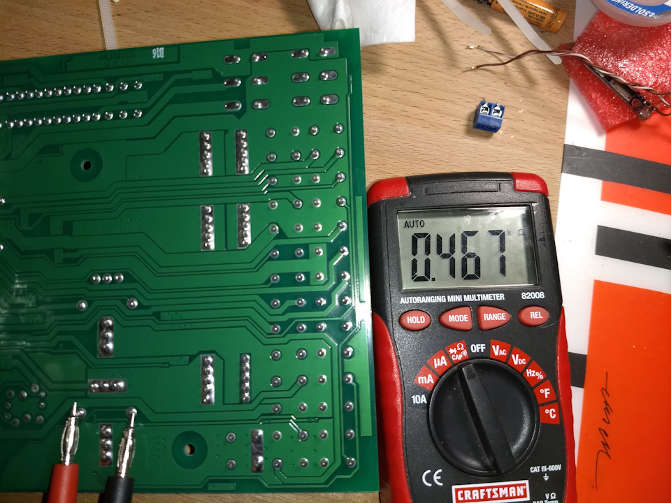

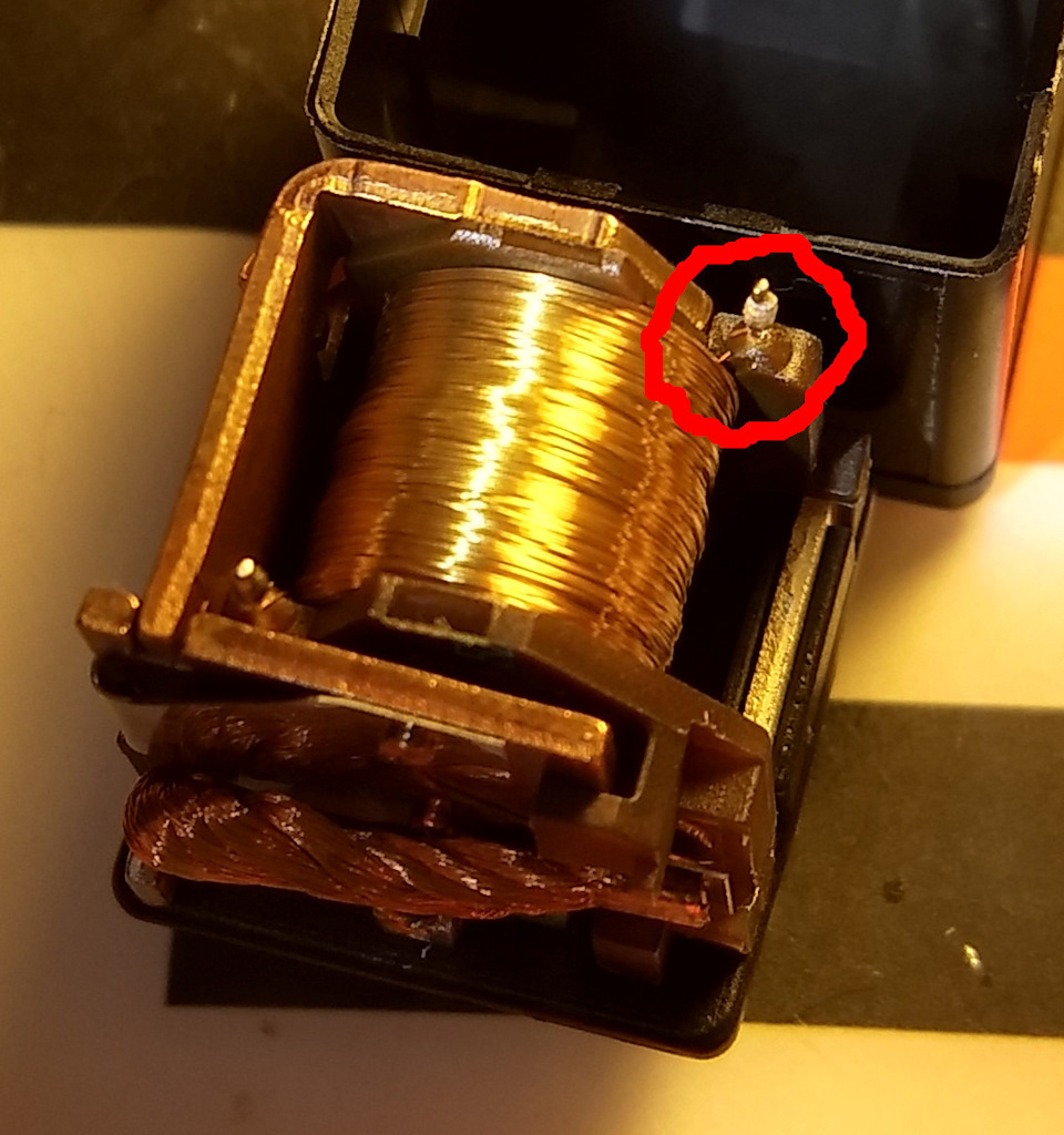

PEM? A fuel pump controller? They fail more regularly than CEM because Volvo in its eternal wisdom put it under the chassis, open to all road moisture, salt and grime. There's TSB to relocate PEM into trunk. Good news is it is easily replaceable, no software reload required.
Two big CEM relays are Tyco V23134-J52-X455. Tyco is no more (acquired by TE). You can't easily buy this relay, only Chinese knock-offs that you should avoid. I think this is the replacement: https://www.onlinecomponents.com/te-con ... 31463.html I've got 4 of them just in case, but sourced a used relay from the donor CEM for my repair.
DIY is easy. You need a multimeter and hot air gun. Find the bad relay. Good relay has resistance of 74 Ohm (90 Ohm coil + 470 Ohm resistor in parallel):
Bad is 470 Ohm (broken coil):
Heat it up with your hot air gun, it will fall down. Clean the pads, insert new relay, use hot air gun and some soldering+flux to solder it back.
