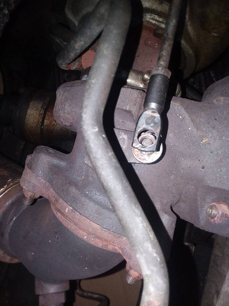

heres what I did 3 years ago.
Sleeve goes over the original waste gate pin, threaded coupler drilled out to fit over the sleeve.
Tiny hairpin retaining clip no longer required.
other pic shows how much pretension I used to keep it from rattling around on the wastegate pin.
