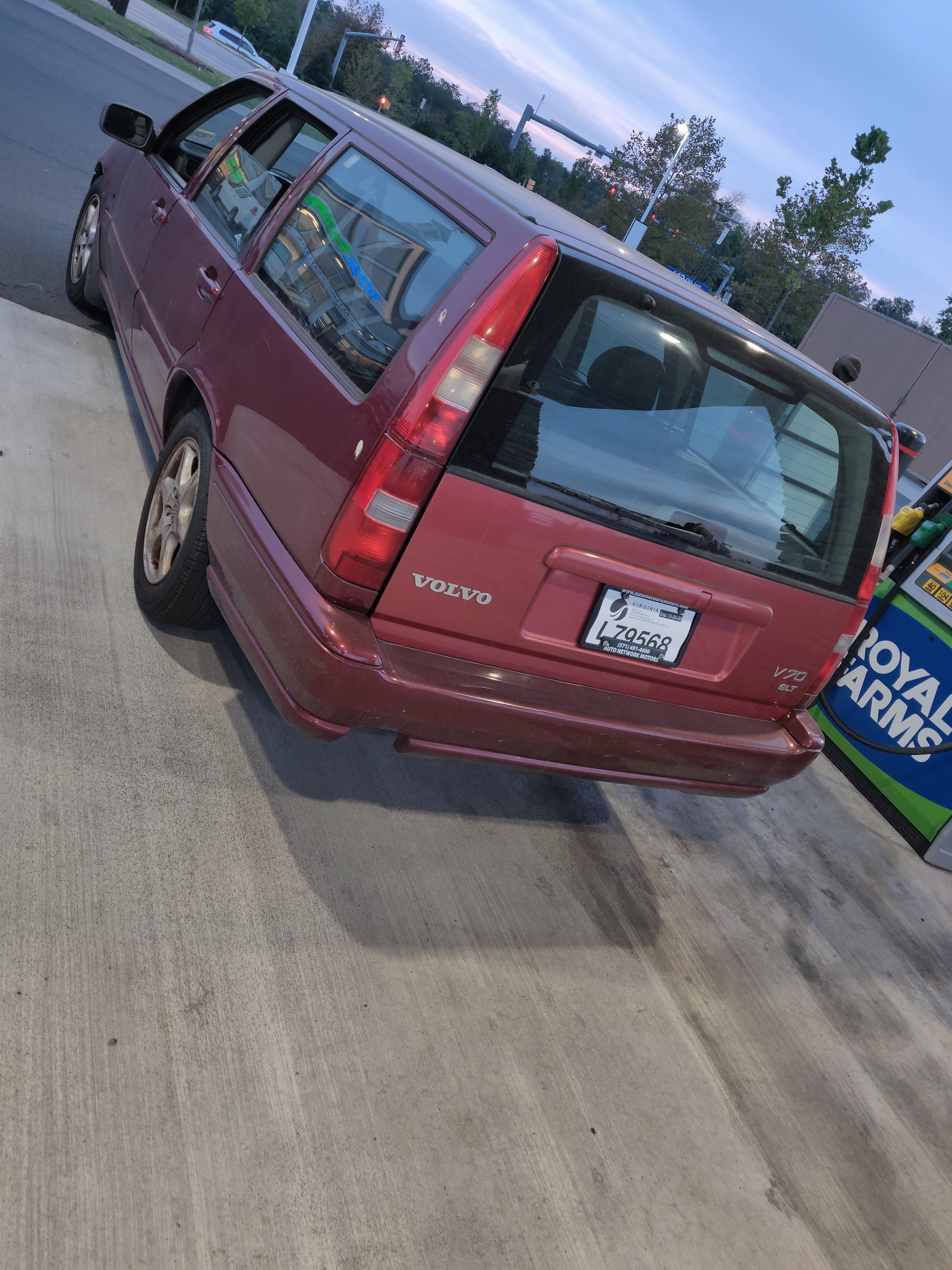

Wanna stage zero this, and make it my daily
Right after I bought it, filling up with gas

Awesome choice my friend. I have the same exact car (98 V70 manual Coral reef red)
I get excited looking at your car now, even as I simultaneously gaze at mine outside my window... volvogasm.
