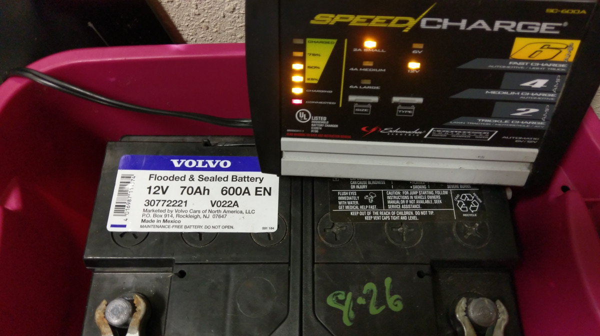

I got it fully charged but the electrolyte is out of equilibrium. Which is expected after a deep discharge, 13.48 V after 6 hours of rest. It will work itself back to equilibrium over the next couple of weeks as the stratified electrolyte diffuses. I will leave it on float charge. The little bit of gas that is produced will help mix and diffuse the electrolyte.bmdubya1198 wrote: ↑27 Aug 2020, 09:09 You may be able to save it, I was actually able to save an AGM battery from my brother's new E34 project that was at 2 volts. It's actually held a charge after sitting for a week.
