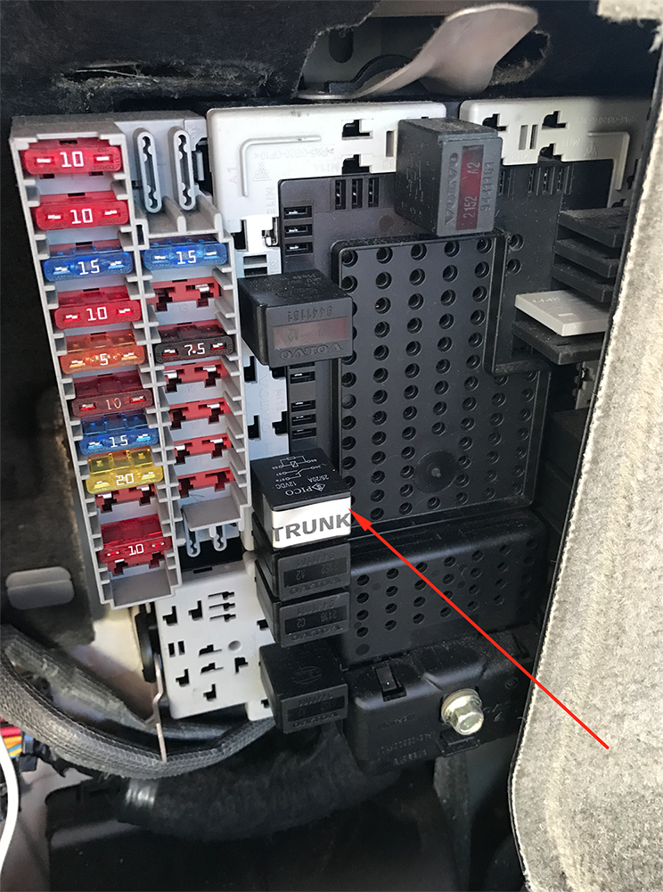

Sorry for the delay. Here is a photo of the relay which is behind the panel on the driver side in the trunk.
- trunk relay.png (1.44 MiB) Viewed 2830 times

I have the same problem V70 2002
how do I find the relay that I need to replace?
do you have a name for the relay to search on?
haha nevermind, you posted a picture
relay 1247 B2
941161
ugh, can't find this relay based on the above
relay 1247 B2
941161

You could try pulling them out one at a time and using your remote to activate the unlock feature of the trunk and when you don’t hear the click anymore you’ve pulled a right relay. You can find a duplicate relay in the fuse panel in the engine compartment also just a test.
