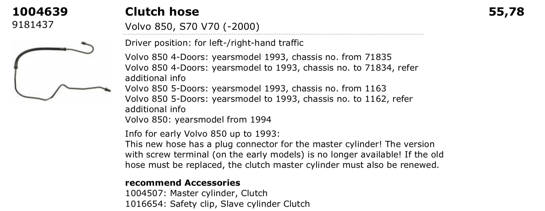

Finally, it dose't work. So, the Master cylinder is new, the salve cylinder and pedal cylinder are new, the oses from the pedal to the MC's reservoir, from the ABS Unit to the reservoir and from the slave cylinder to the reservoir have been replace by some strong ones, and it still doesn't work After approximately 25- 25 pedals pressions, the piston of the slave cylinder stays in extension and the pedal sinks deep into the bottom of the crankset and does not come back.
I've decide to change the last part of the circuit which is the hose going from the salve cylinder to the pedal cylinder.
I'm sure this hose is the OEM one and must be the problem. After that, if it dosesn't work, I will have no idea.

If you used a soft hose not rated for about 1500 PSI, then I am not surprised you had a problem. A soft, low pressure hose would expand or even work loose at the connections. The hose should look like a brake hose at the wheels. Sorry I do not have specific information.

Thanks so much for the reply. This is the hose I've used to replace all the 3 hoses.Strong ones. I will bleed brakes tomorrow because I had to extract the master cylinder to access to the clutch line of the pedal.Tomorrow the truth will be. I have ordered the hose between the slave cylinder to the pedal cylinder; So, with that, the all "circuit" will be brand new.

Moment of truth. The only part i didn't replace yet...

Hy Buddies,
I 've replaced the hose and putted the slave cylinder on its right place to work well. The first pressure on the fork made coming up lot of bubbles in the reservoir. So, today I will know. The four parts are brand news ones, pedal clutch cylinder, slave cylinder, master cylinder and the hose. So, it must be okay.

R U ready Comedy Partners ?
Finally, the guilty has been found... Can you hear my tears of joy running through my old baby face ? The hose : check the hose ! Why didn't you check the hose first ? So. I've recovered the clutch has it was before this (rather) long incident. I didn't test the car yet, I will do it tomorrow to see if everything is alright.
i will replace every hose of this amazing car before snow time. And if I have a extra at Christmas, it will be for the heater core.
Thanks to all members who have support me during this bad time. I will check this post "solved" after tomorrow 's test.
