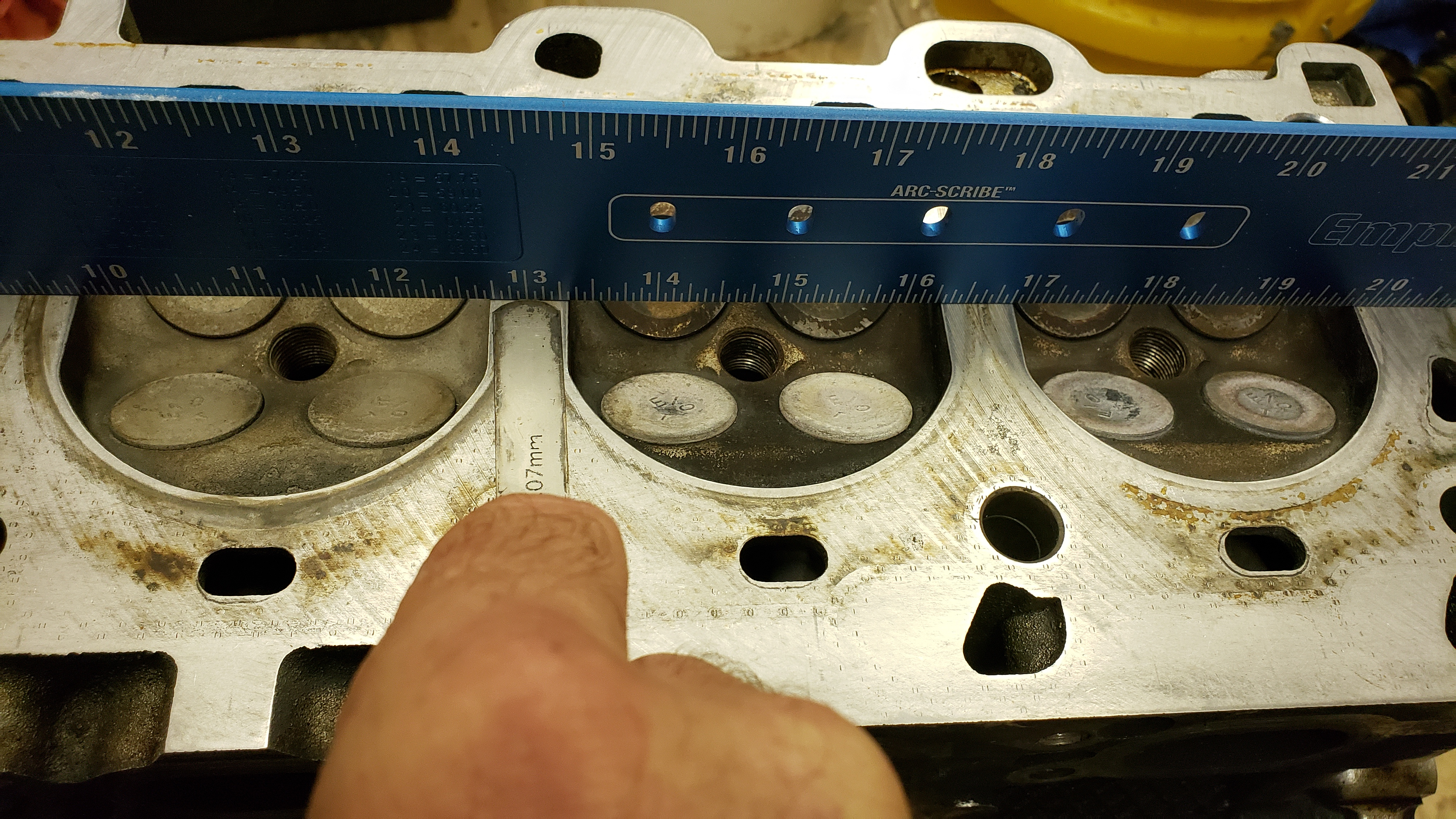

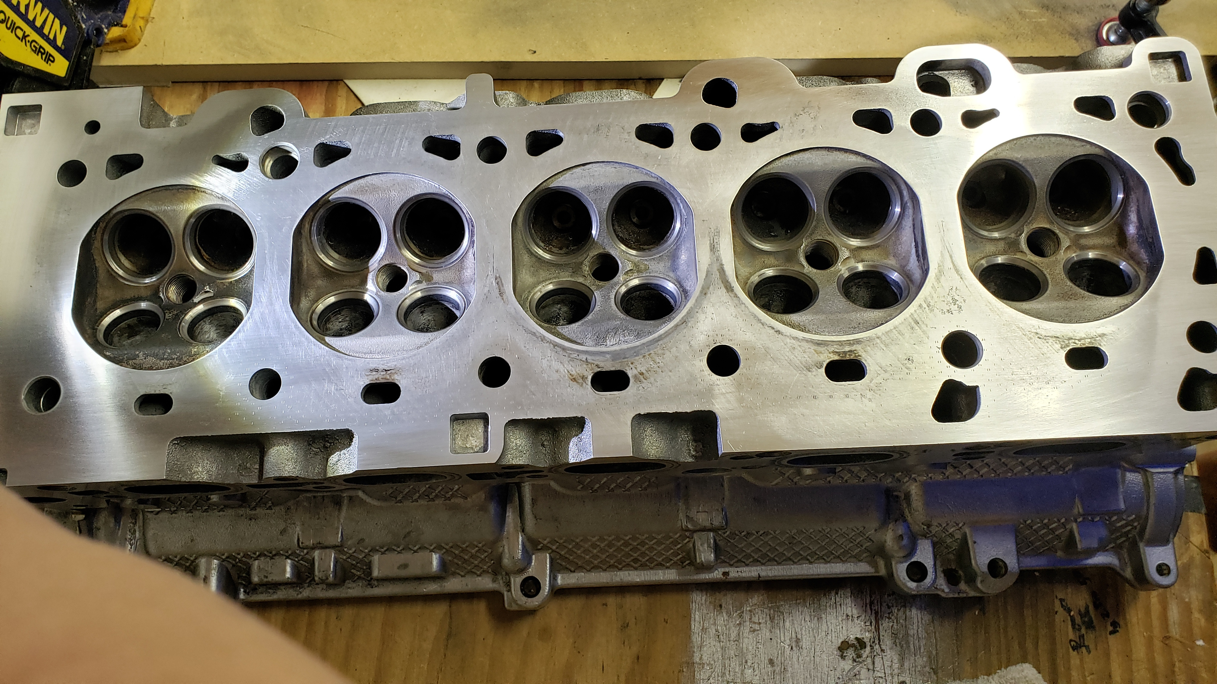

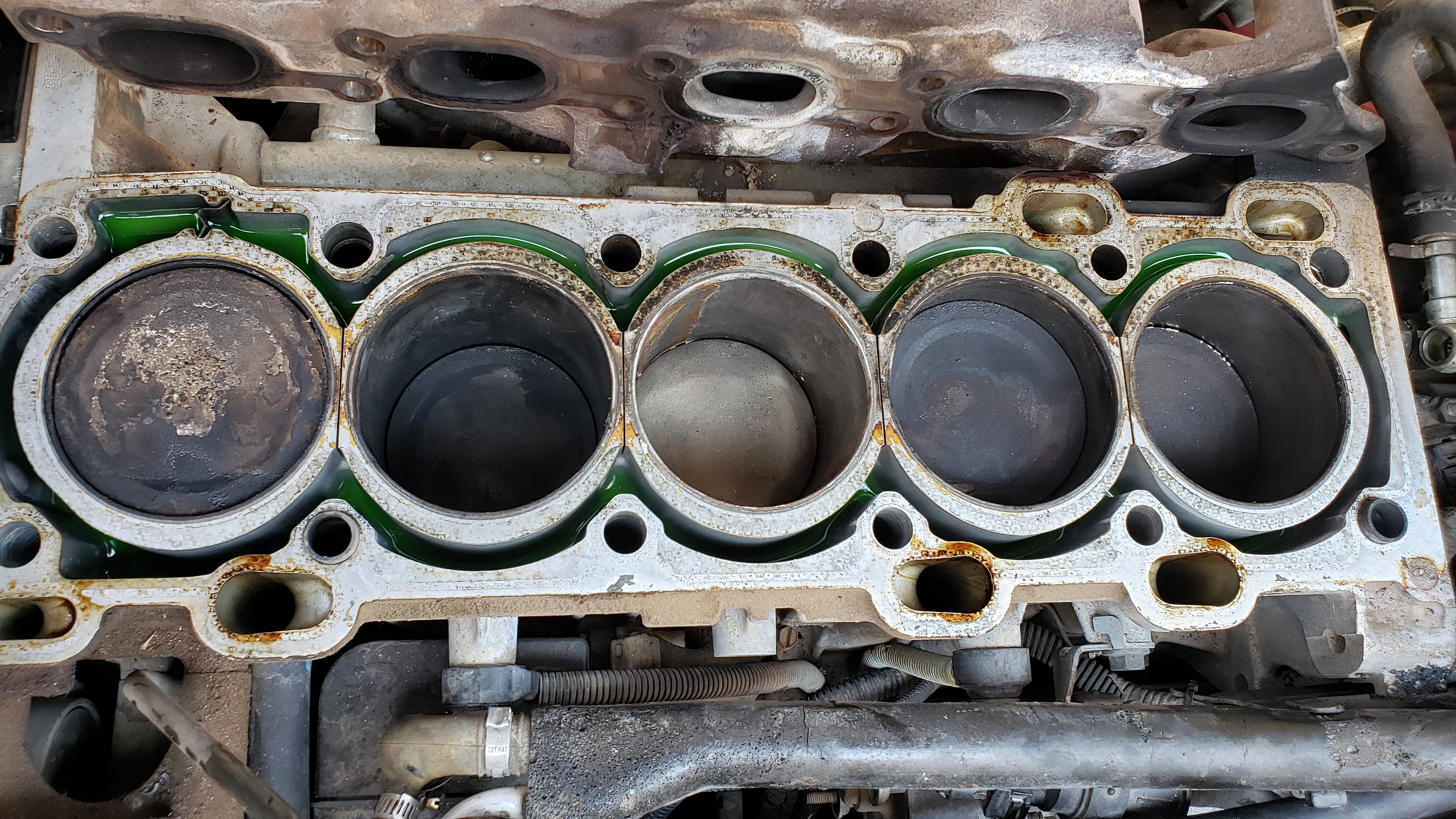

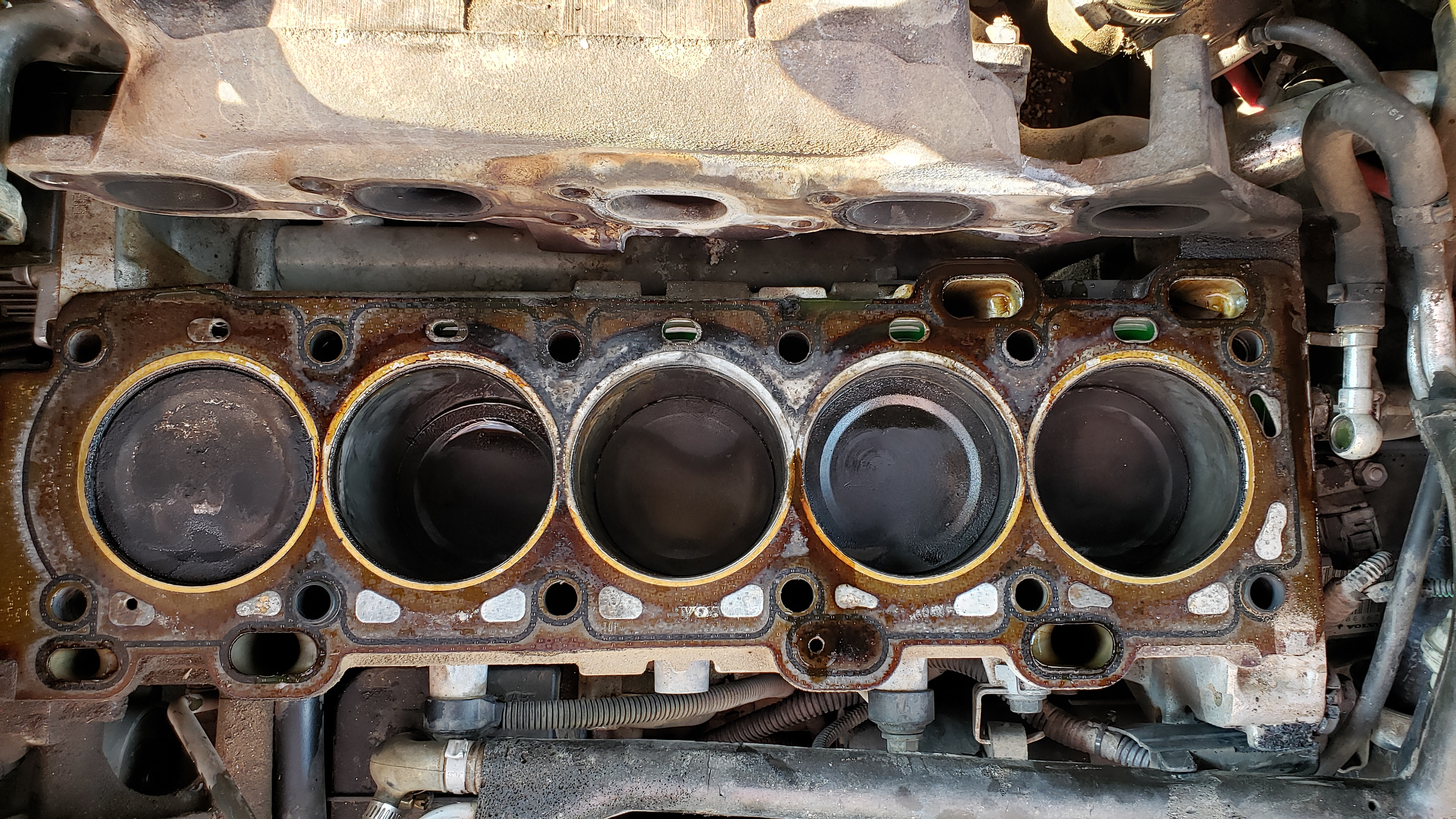

Well I did it. In my driveway. Yes, it was only a bad head gasket.
It looked pretty bad. The "leak" around #3 appeared to have been the worst but, 2 & 4 were a close second.
I feared the warpage had ruined the head. Luckily, when measured with a straight edge, it was only .22mm L & .08mm W.
Within spec but not great.
I used a plate and sandpaper to nudge the gap down to .05mm L & .00 W.
She's back together and running better than when I got her.

Volvo horns awarded for removing 6 thou of warp with sandpaper!
That’s dedication !
Did you use new head bolts? That’s recommended by Volvo but I’ve always wondered if they are truly in the deformation limit
