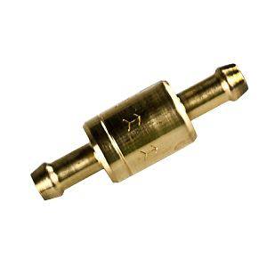

1. the location I choose to add a after market check valve is the under the passenger side wheel. Use quick disconnect tool disconnect the fuel line.
2. Do not , Do not use the ball check valve,
Image I tried this first, and it failed.
You need to use spring type check valve.

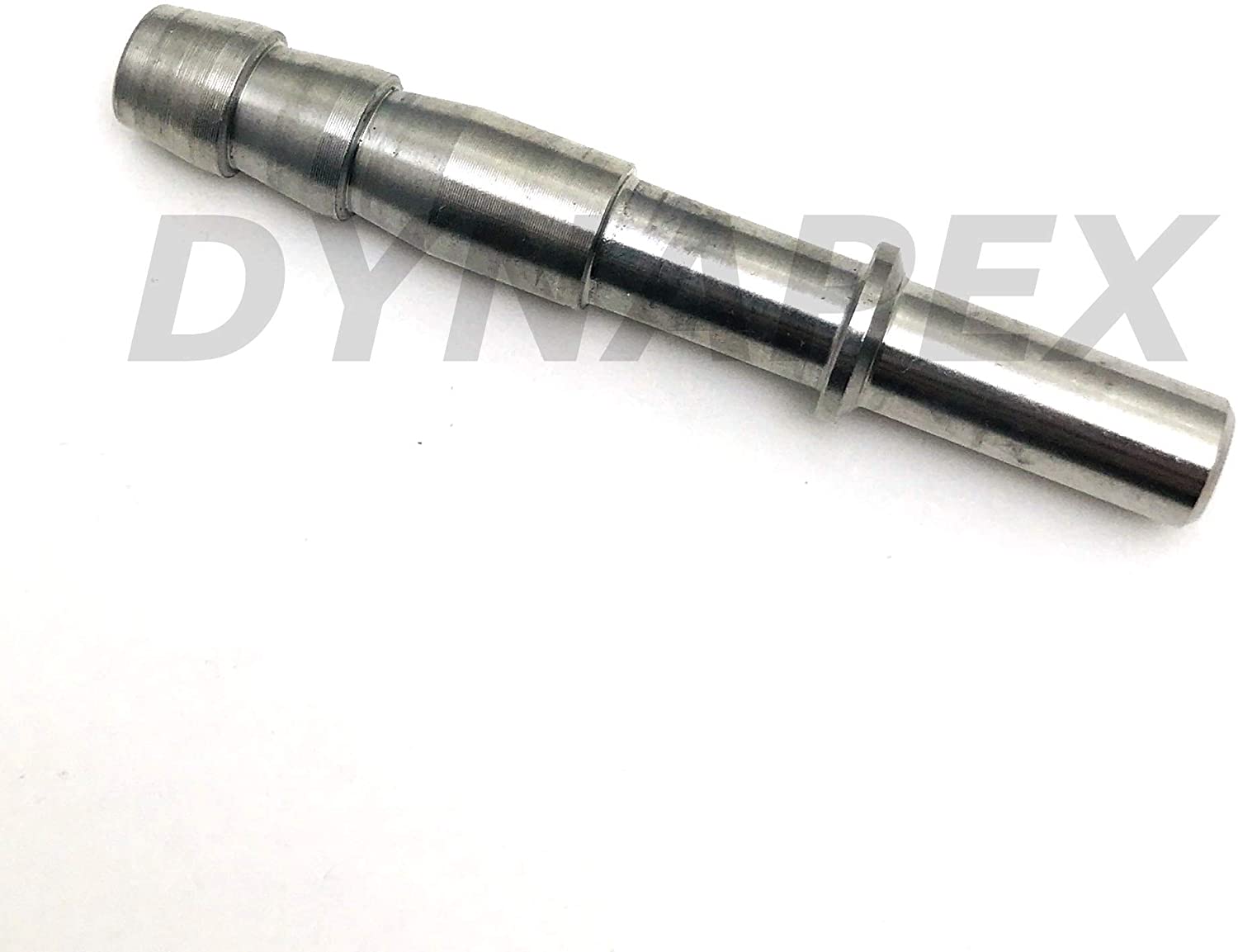

other than this you may need a connector:
So the size of the fuel line connector is 5/16" 9mm .

ball check valve: do not use this type
spring check valve
spring check valve
connector
connector

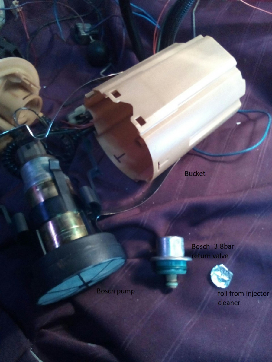

thanks where did you source the valve from?..problem with trying to repair the intank check valve is removing the valve (think its molded in the plastic?) second is buying a replacement, i emailed bosch 1 week ago and no reply.

thanks, if you have "fixed" the problem installing your own one way valve that is great, however i personally would be finding the real problem and fixing it. At first i thought adding a one way valve was a great idea but if an injector is leaking then its not going to fix the problem and you are changing the design of the fuel system, for safety its designed NOT to hold pressure above 3.8bar, you really need to add an inline one way pressure valve. Good luck

Yes @ darrylrobert is right, my add on check valve blast out the fuel line. Later one website said this kind of one way valve only can apply to return fuel system. Do do this. It could cause big accident catch fire and burn the car

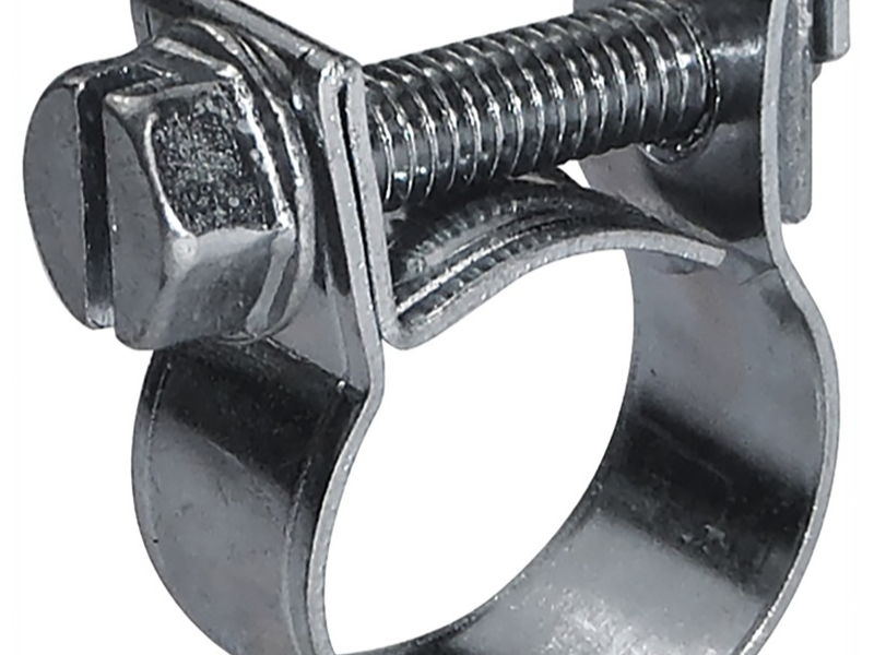

So some update. I removed the check valve. And put a straight hose on the section I disconnect. Why? because the Barb to bundy connector I can't take it off. So I have to leave it there. After a while I check the fuel hose, the auto zone fuel hose. It was cracking. After so much research, I found out, fuel hose have two kinds : carbonator hose and injection hose. If you don't ask specifically, the autozone will give you the carbonator hose which handles maximum 50 psi. The volvo runs around 55 psi on idle. So after a while , of course, the fuel hose crack. You need to go to Napa to get injection hose. You also need to use fuel hose clamp instead of worm clamp. The fuel injector hose can handle maximum 225 psi. So I put every back together, just use the right hose this time. It works so far so good.
Use this metal type otherwise you stuck there.
Quantum inline check valve
check valve.jpg (7.16 KiB) Viewed 1678 times
fuel hose clamp
fuel hose clamp
hose clamp.png (541.62 KiB) Viewed 1678 times
NAPA injector hose 225psi
injector hose.png (136.26 KiB) Viewed 1678 times
