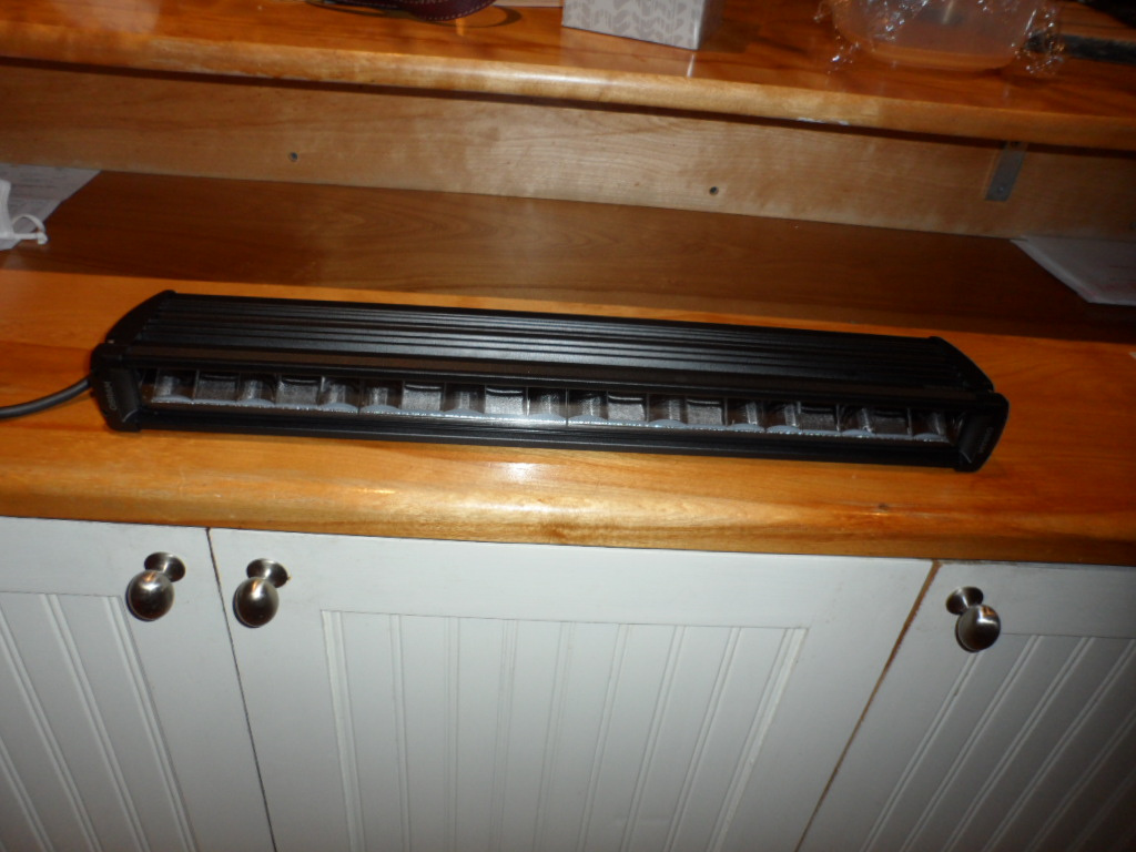

2004 XC70. I live in northern VT. Nights are dark and the roads are empty. I want to be able to see farther down the road at night than the stock high beams provide for. Recently purchased this Osram LED light bar designed to be driving lamps. Got my advice from Daniel Stern Lighting. If you don't know who he is and want ANY advice on automotive lighting he is THE MAN.

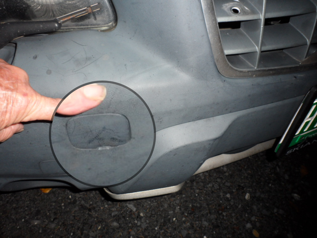

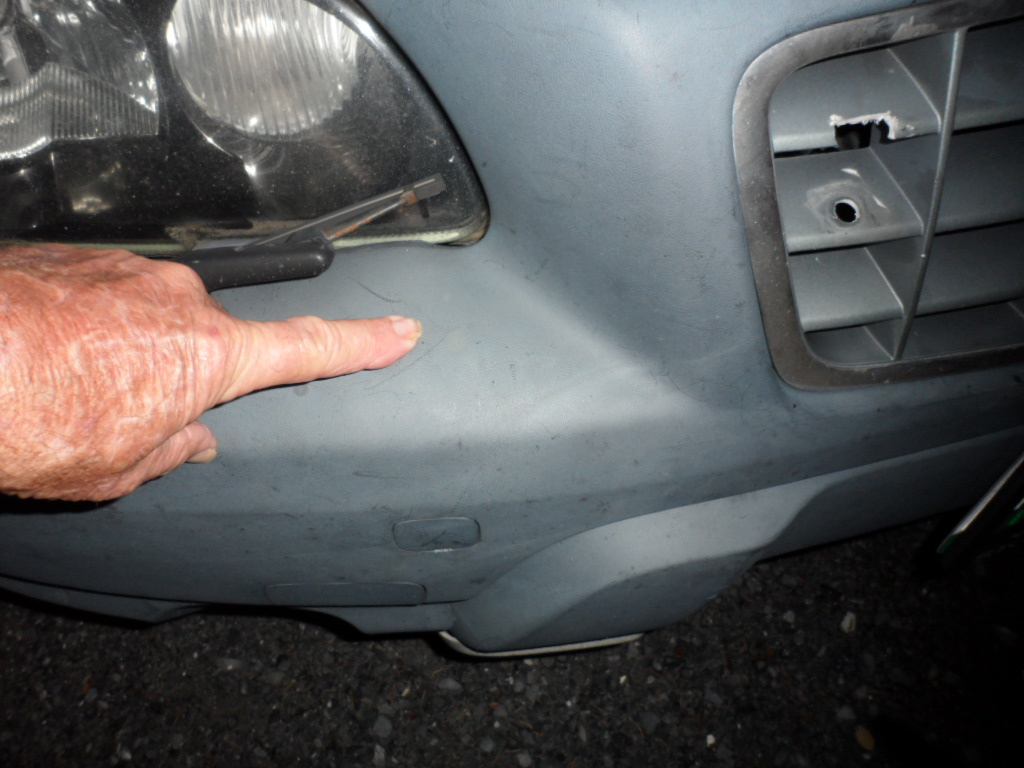

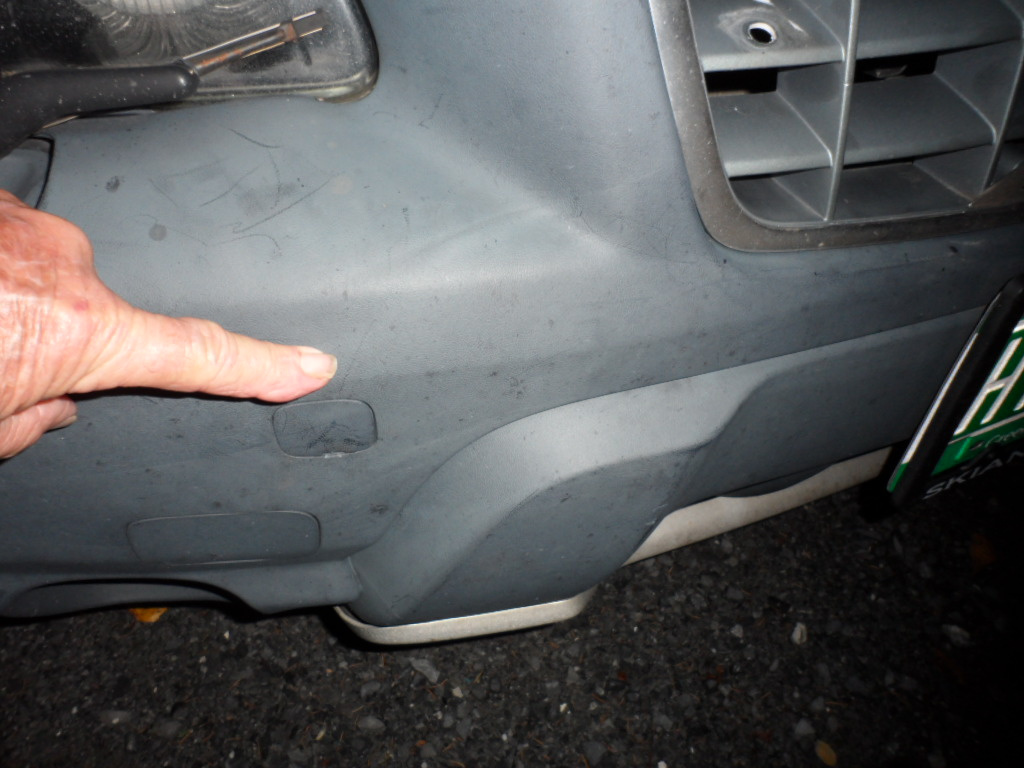

I am trying to figure out the mounting of the light bar. I am thinking of using the two bumper bolts behind the caps that are under the headlamps. Would mount an L shaped bracket to each one that would extend out over the top of the bumper. Then attach a flat bar to each one across the front bumper in front of the grill. Then mount the light bar to the flat bar.
My question is, can I cut through the top of the bumper where I am pointing on top of the bumper just behind the plug in the front of the bumper in the photos to insert the L bracket down through the cut so it can then be bolted in place with the bumper bolt.
The cut would be small, just big enough to insert and end of the L bracket through it. More like an incision.
Advice on mounting a LED Light Bar

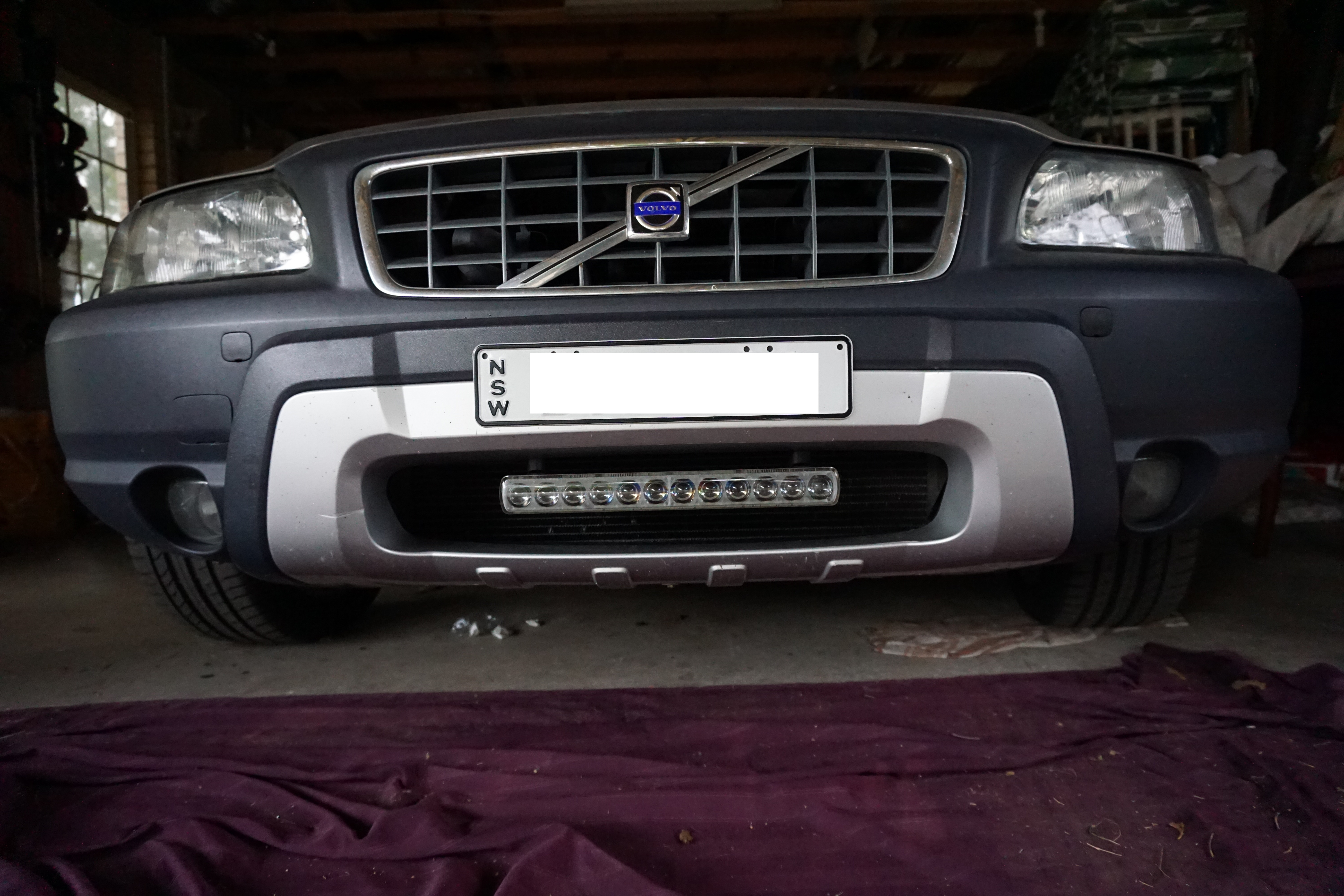

Ive installed my Hella light bar in the grill (cant find a pic) by cutting the grille and used the horn mounts and made a bracket. I first installed it down in the mouth (pic), i liked the performance of the light but didnt like it down there. EDIT strict laws in my state in regards to things sticking out infront of your car.
In regards to your question i think it would be possible, i assume you want extra stability?. i visited a car store while i was in Sweden and was thinking of buying the bracket that was popular for attaching additional lights but i picked it up was heavy, made from steel Not aluminum, that would put me over my baggage limit ..im surprised the bumper can hold that much weight.

I would make a bar that mounts to the actual bumper cover mounts that are hidden behind these plastic plugs (one on either side).
I made a mounting bar for dual light bars & mount it here. I’d need to measure, but I think my bars are 24” long each, something like that. I stripped out the one hole but the other is still good so it doesn’t shake much unless I’m on washboard gravel roads.

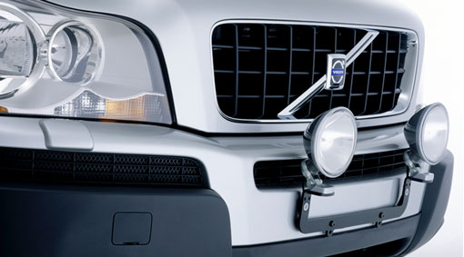

Just a thought here - the euro fog light mounting bracket mounts behind the license plate, sticks out left and right, with uprights for the lamps. Maybe that could be adapted. You want aux lights to be as low as practical. Unless of course you're a race truck in Baja.

Pete, How did you make that set up? And how is it secured to the mounting bolts?

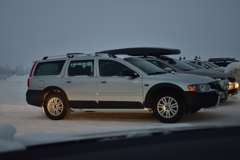

we call this a nudge bar, looks good on this Swedish xc70 i spotted as a light bar.
