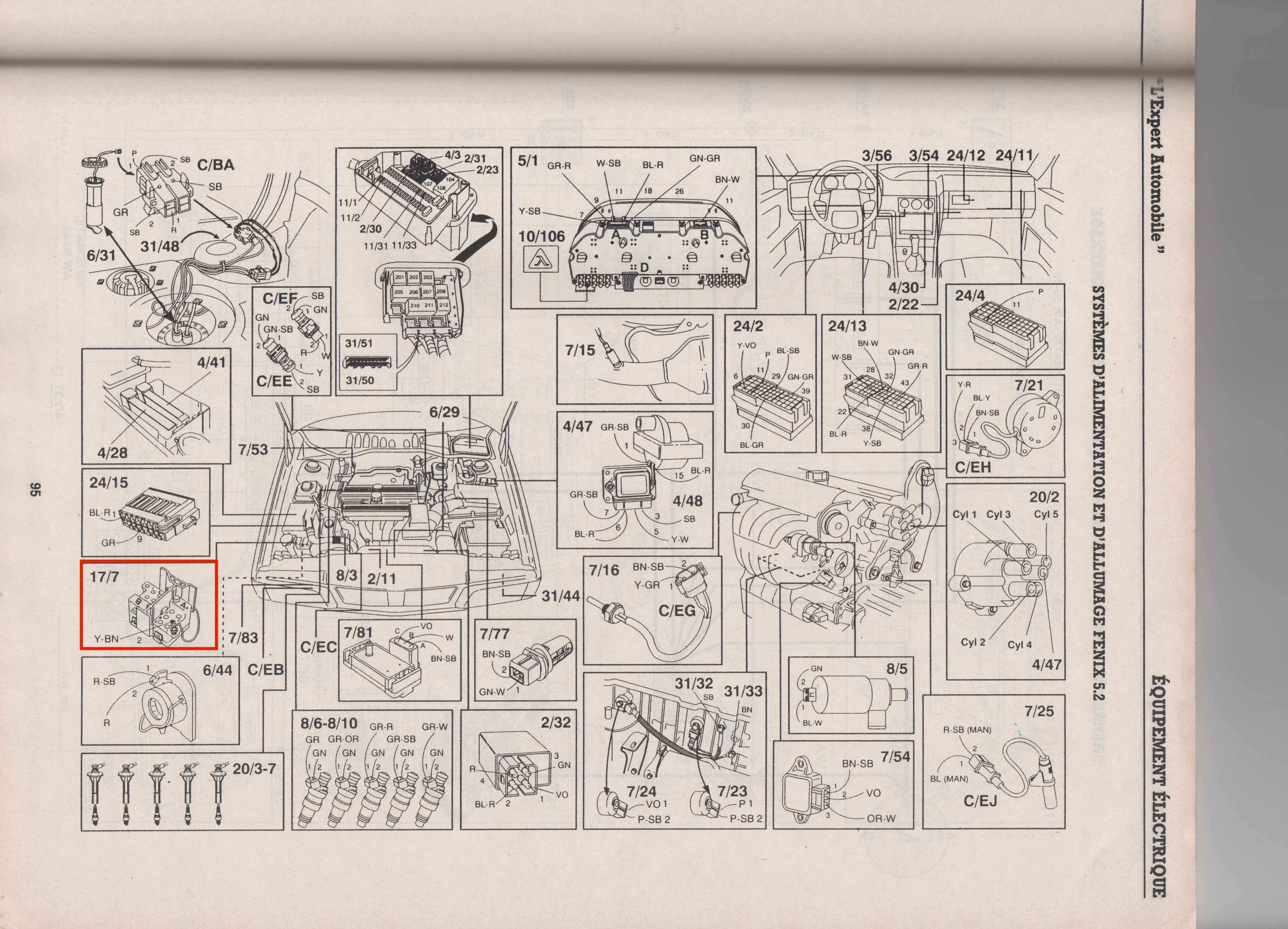

So, I progress in bring help to Blue. Here are 2 boards, extracted from my 850 book. The thing I don't understand is on the "b" board, why I only see the "A" unit and not the "B"one, If I didn't make a mistake.
On the 1rst board is written : 17/7 : diagnostic switch A only.
May someone explain how to proceed ? I would like to test the wiring from the OBD unit. Manov
- Posts: 36149
A and B are the two sides of the ECU electrical connector, one connector with two sides
ECU 4/41
ECU 4/41

Salut abscate,
Thanks for the light... It means that on the two sides of the connector, the power comes only when the pin is plugged so ? And if so, what could be the reason to have non power then ? A cable cut ? Where should I plug the multimeter then ?
