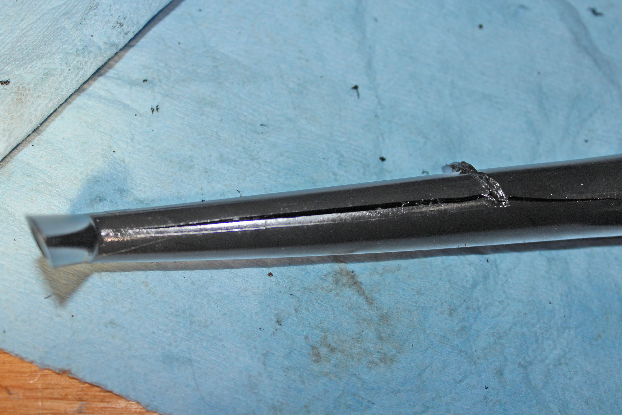

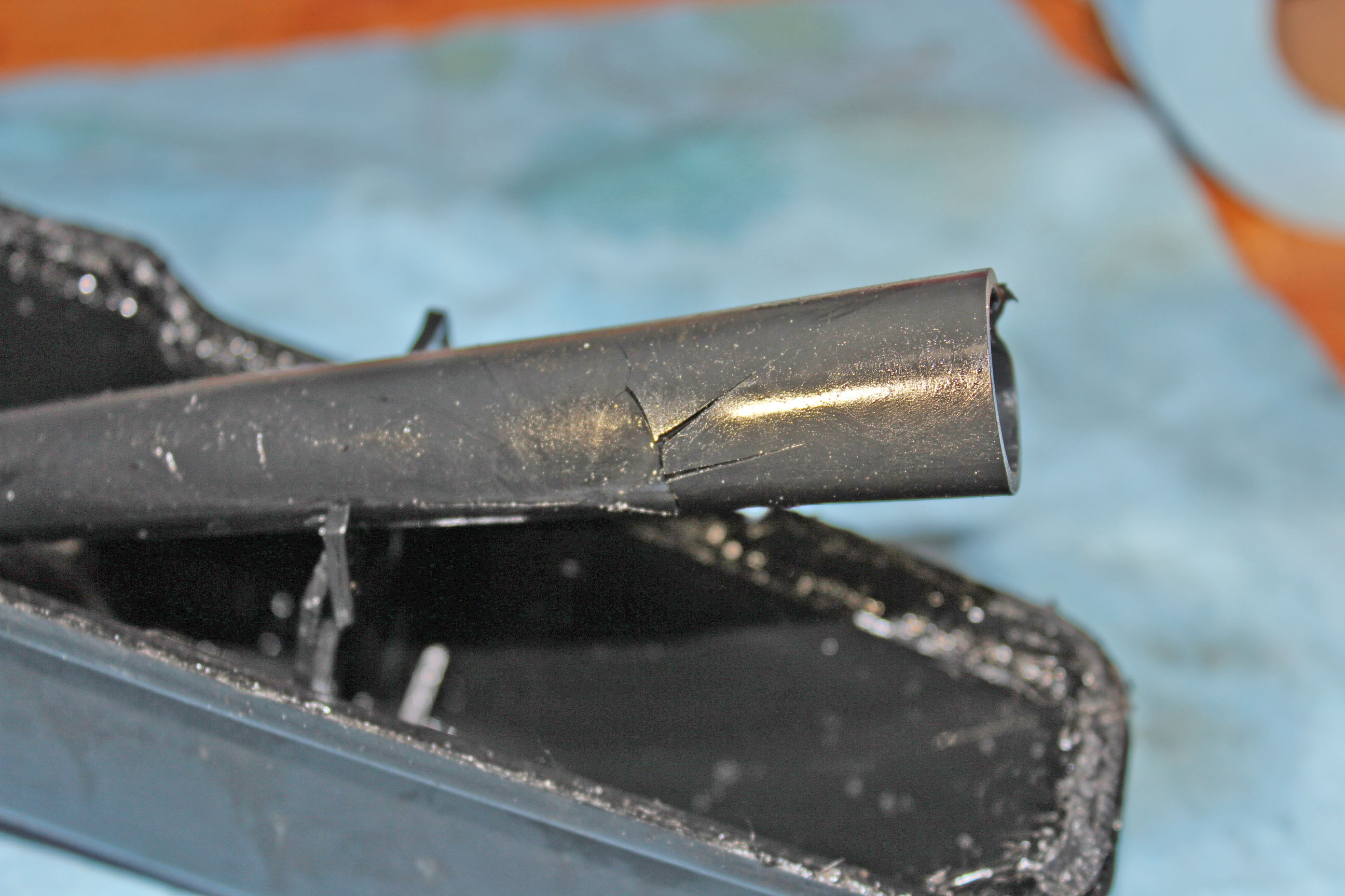

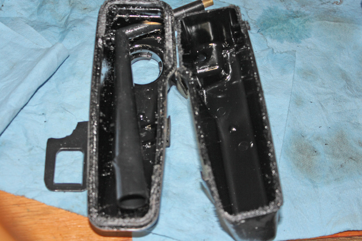

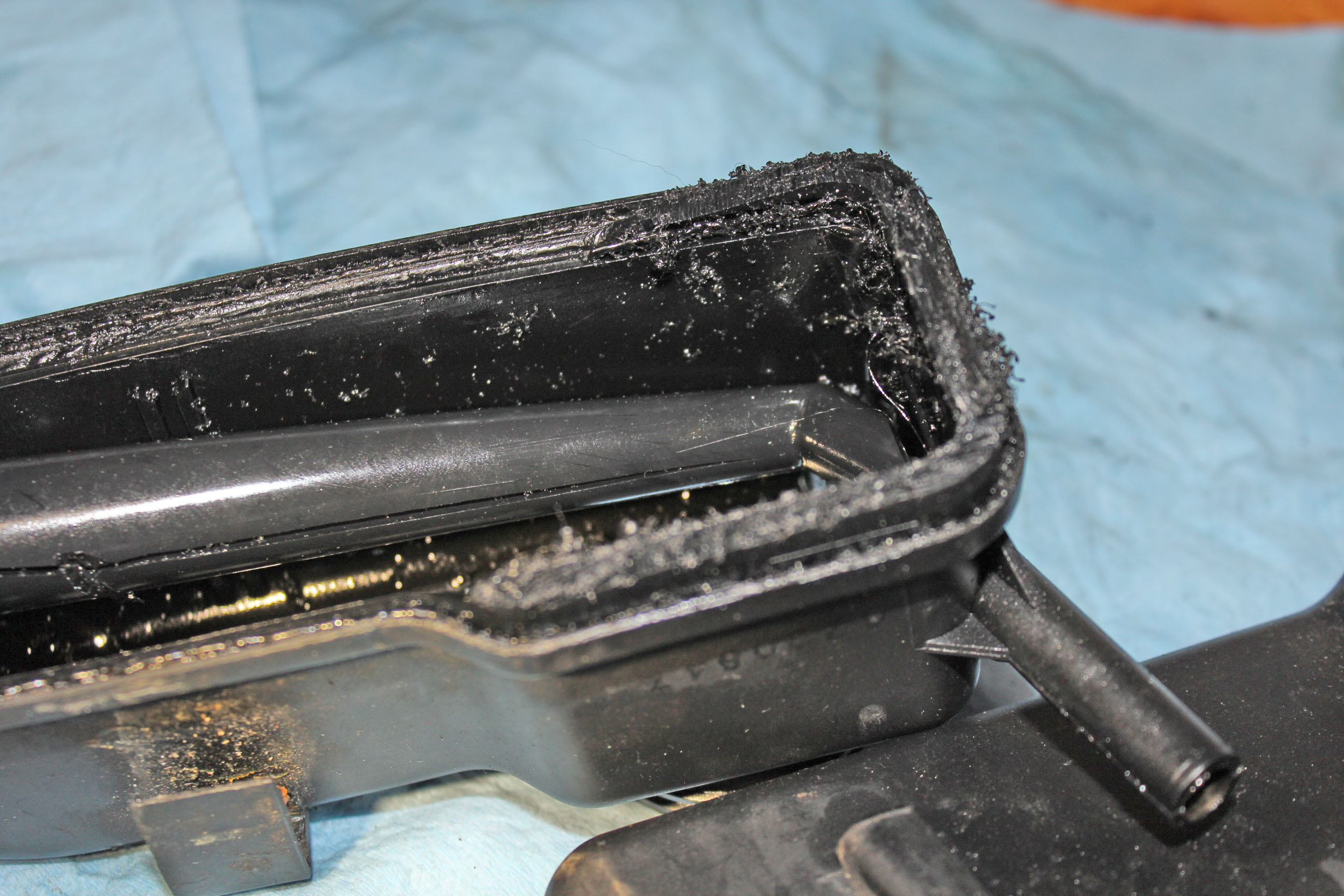

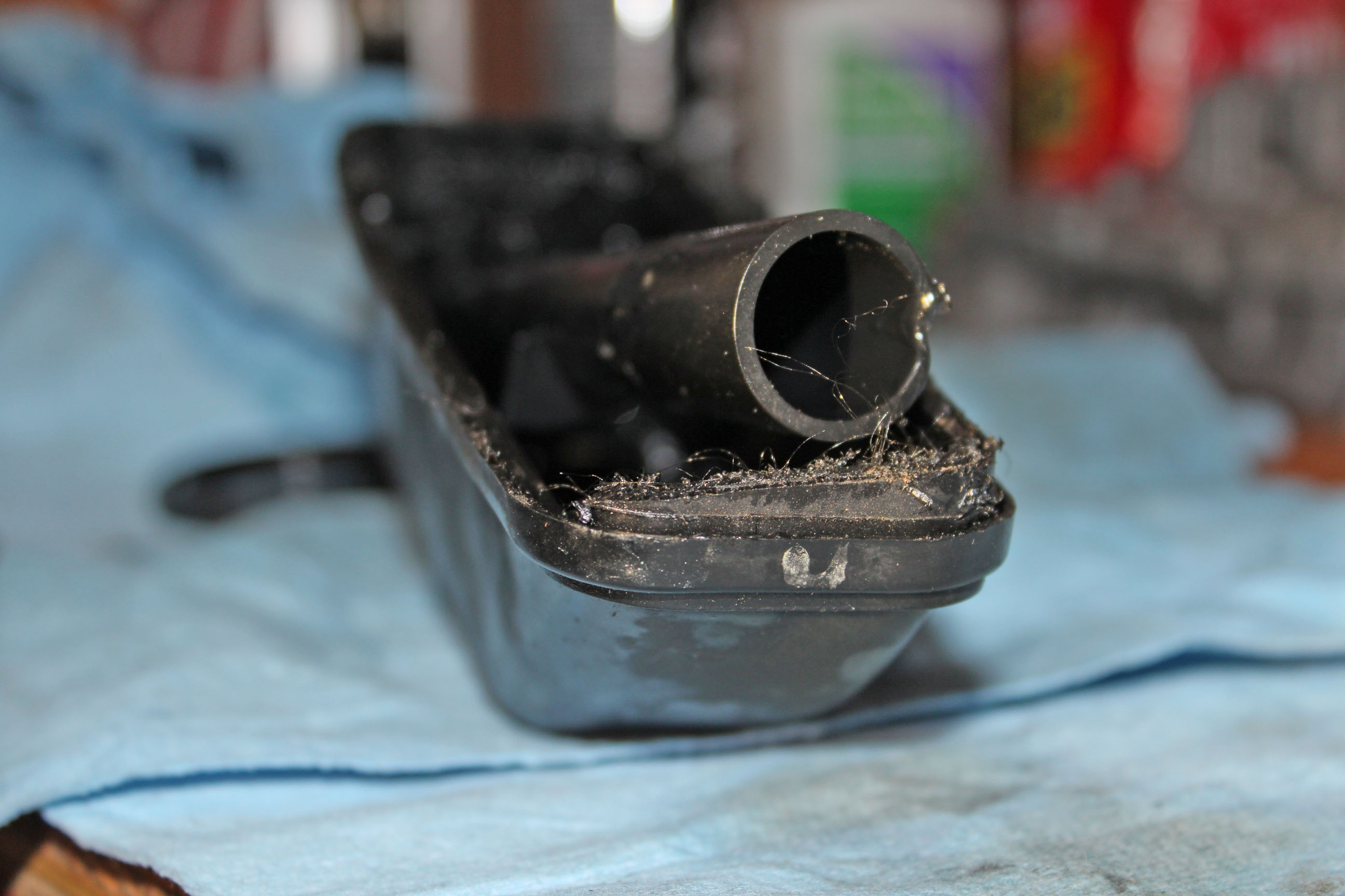

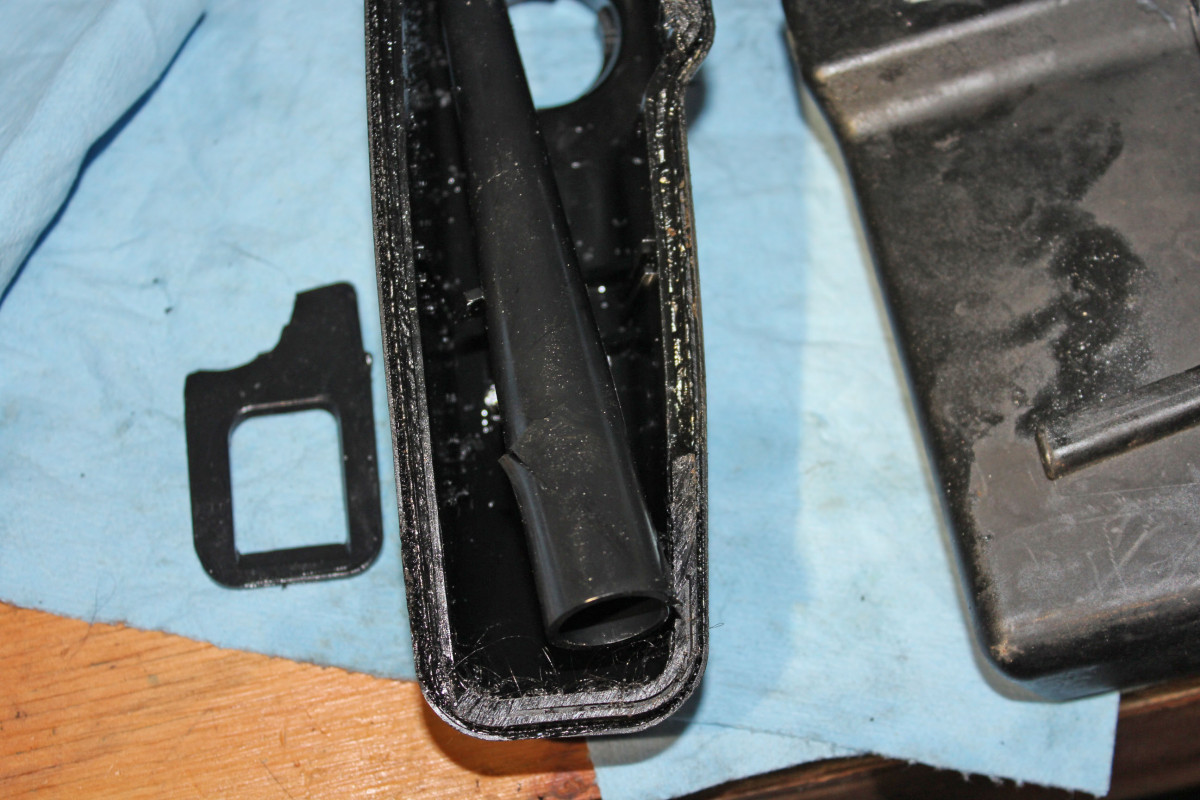

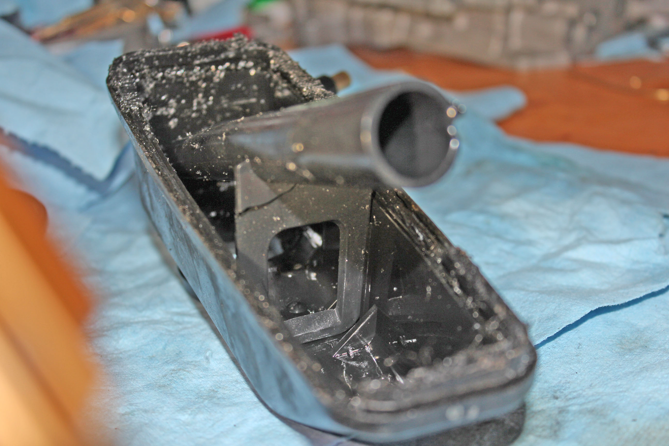

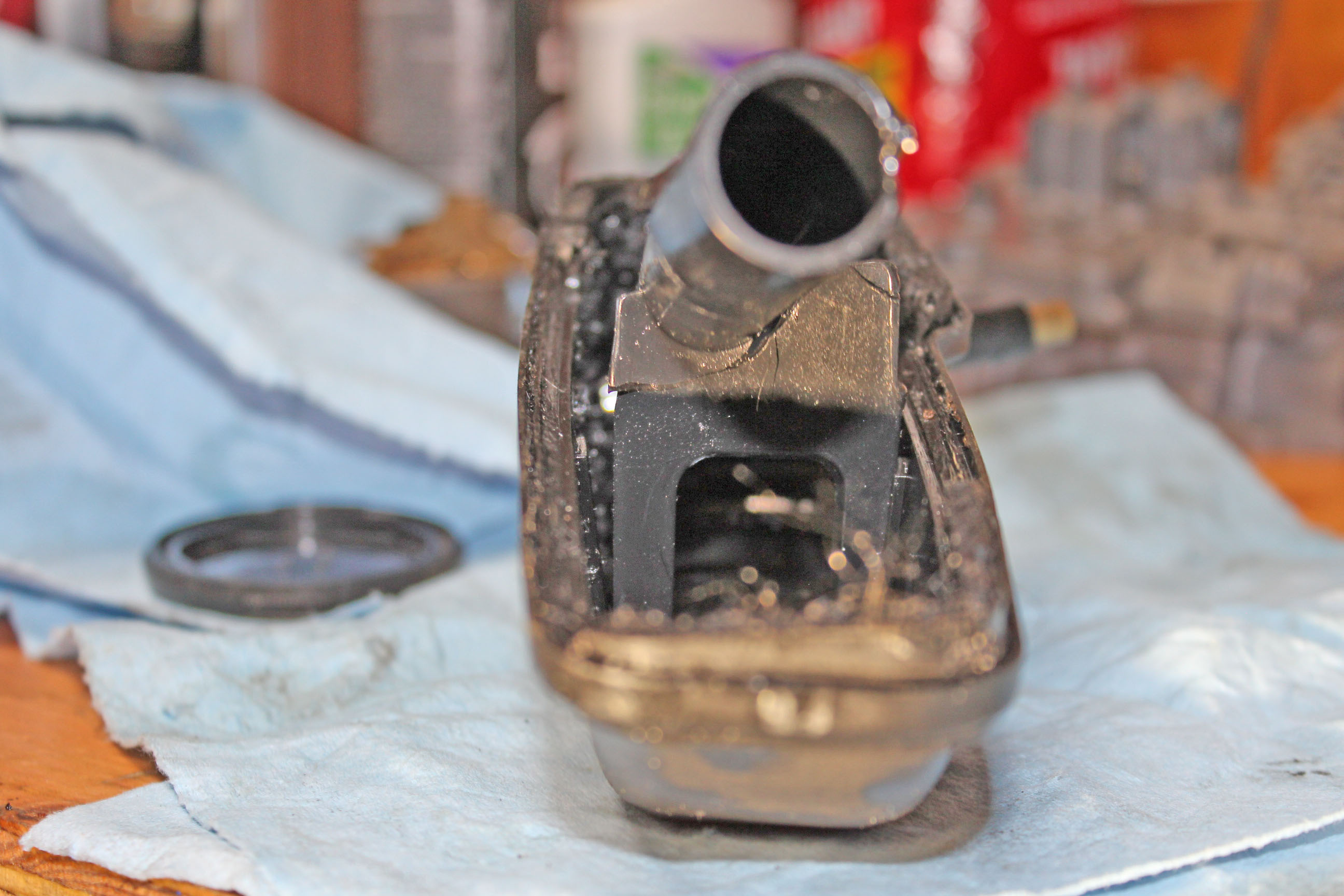

Yes, I did have a bad reservoir. Just installed a new one and fluid is now free of air bubbles and no more pump noise.
The bad reservoir had something rattling around in it so I cut it open and you can see from the photos there's a support plate for the return tube that broke and was floating around in the reservoir This divider plate keeps the end of the return tube down low in the reservoir. With the plate broke the return tube can raise up (it pivots) and I suspect it was floating above the fluid level allowing air to enter the fluid. It looks like the PS reservoir was redesign sometime in 2005 and now the return line enters at the bottom of the reservoir. You can also see in the photos the return line tube also was cracking on the side.
Thanks for the info about the reservoir, cheaper to replace than the pump and I would have still had pump noise if had replaced the pump.
All the photos shown are with the cut in half reservoir upper half turned over so viewing upside down.
Edit update: I found a crack in the return line tube inside the reservoir that runs almost the length of the tube. Some of the crack is above the fluid line and likely why air was getting into the fluid. Added a couple of more photos showing the cracked tube.
Broken piece pulled out and shown on side. Note the return line can pivot on the metal tube insert so end of the tube opening was at a higher position within the reservoir with the broken support piece.
Broken piece as I found it, return line tube in incorrect position.
Return line tube in correct position.
Broken piece in place, return line tube in correct position.
Crack in return line tube within reservoir.

I'm glad I was able to save you money and hassle of replacing the pump! Thanks for those great photos!!! I know when I first posted it was the reservoir you had to think I was nuts :lol: :lol: :lol: June
