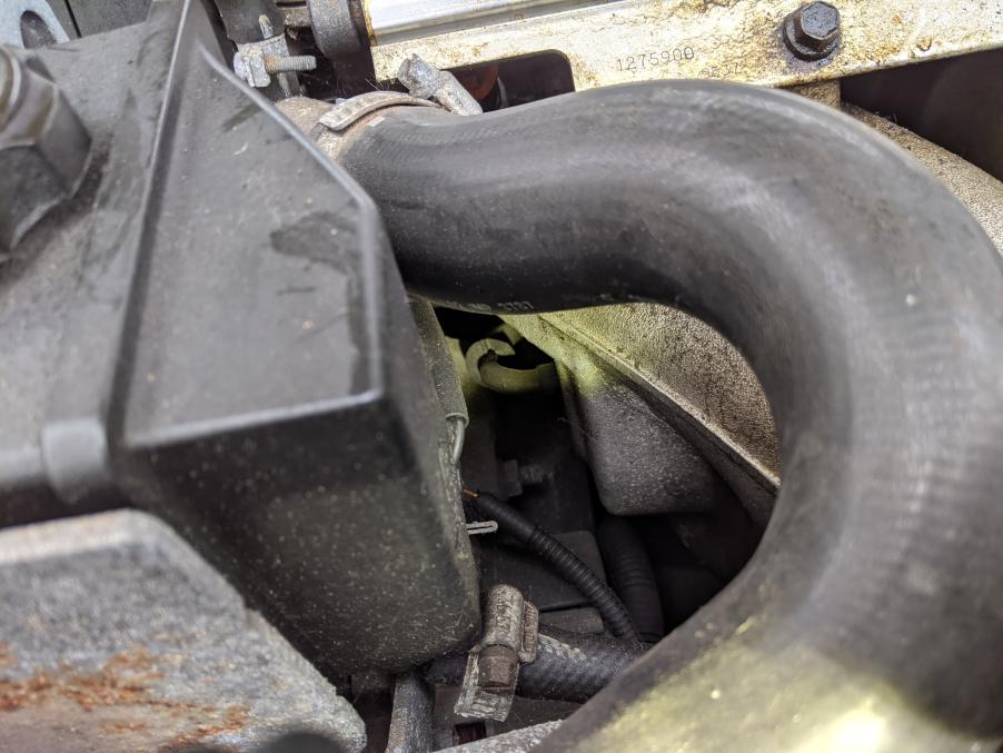

Abscate, good idea on the pictures. Here's one of the hose I was talking about.
It's the passenger side of the intake manifold, with a tear on top of the larger hose. It runs 1-2 cm deep. I felt around and believe I could feel the "end" of the smaller hose through the tear, so I'll definitely investigate this today.
ALSO, I cleaned the Idle Air Intake Valve. The cleaner took a lot of buildup away and I noticed a smoother, fuller swing in the valve. It may have improved the idle quality in the engine, but it still seems to die after a good 10-15 seconds of idle.
I'll be investigating the throttle body and cleaning it today as well.
