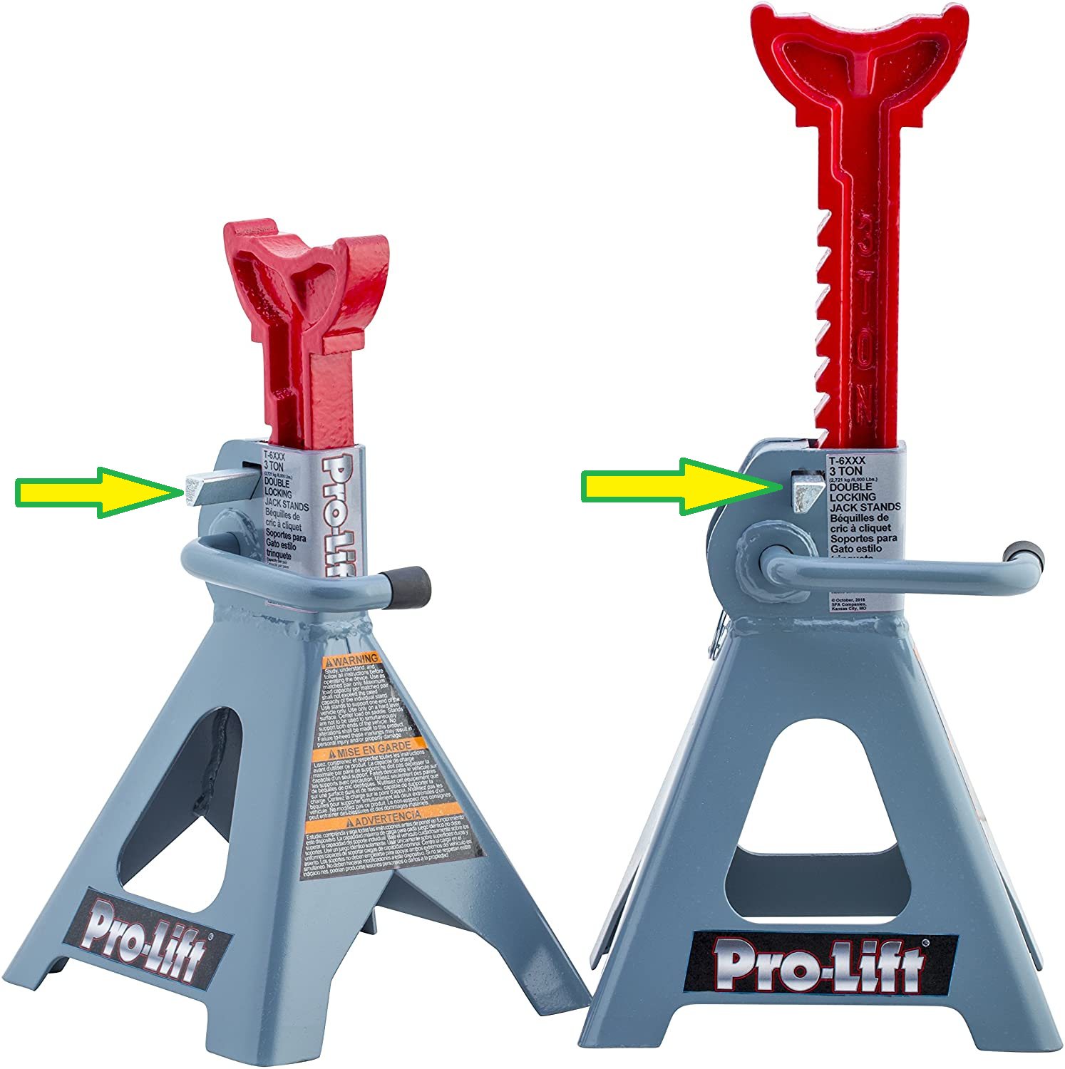

Remember, weight capacity is for a pair. A 3 ton pair is 1.5 ton capacity for each stand. I don't think you missed it though there was a lot of info and none of pictures were clear, so here is the Double Pin Jack Stand again.
https://www.amazon.com/Pro-LifT-T-6903D ... 190&sr=8-4
Costco just started selling these again. Would have been okay with these but they weren't available a month or two ago. It was $129.99 two years ago and $99.99 when on sale. You don't have to return the item anymore for a price adjustment if it goes on sale within a short period of time after your purchase. I once received a $500 difference / refund for a massage chair I purchased online for my parents. They made the adjustment over the phone.
https://www.costco.com/3-ton-profession ... 22458.html

After all the years of getting by with a $20 Jack it's time to give the arms and legs a break so I opted for the larger units.
I have 2 from Costco, one for each side. Both my son and I think it works faster, safer and get much more height than the QuickJacks I returned to Costco. They were $30 off when I purchased them so was the same price as the current aluminum unit for $149.99.
https://www.costco.com/cat-3-ton-low-pr ... 07254.html
Even if the Jacks are more than HB here is why I would still buy from Costco. Today, the Vitamix motor quit. I called Vitamix and gave them the serial number and they said Costco still owns it, meaning it's still under Costco's warranty. The unit automatically get a 7 year warranty and I am 3 weeks from 7 years so the manufacturer is sending out a label for me to ship it back for warranty repairs. The unit actually started working while I was on the phone so there is a thermal protection but the Rep said to go ahead and ship it back regardless and when returned she will include a $70 Voucher for purchase from their website. If the company didn't honor the warranty Costco still would.
With 4 of these stands I can easily maneuver and never feel unsafe regardless what I need to do. Beating myself up with unsafe and short stands all these years. Amazon is gouging as they were $45.99 not too long ago.
