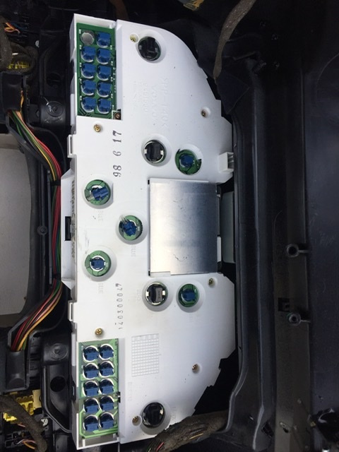

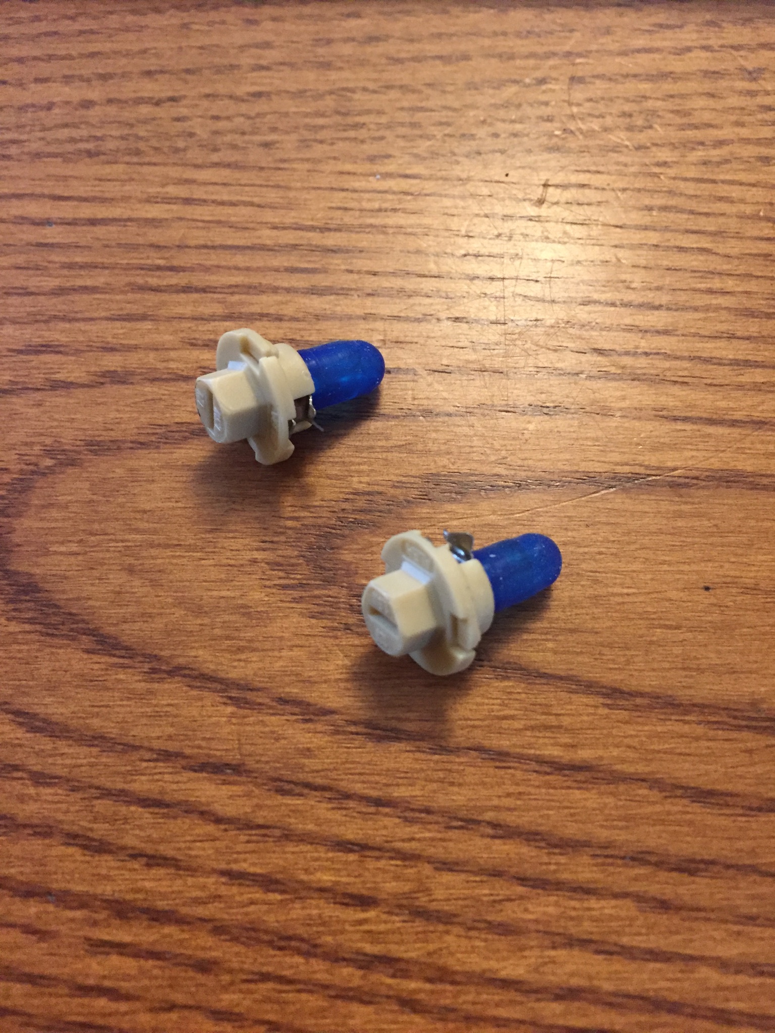

Replacing burnt out ones on Abbys car
I found no part numbers but markingALBA 12V 1.2 Watt
By luck,a fellow Benz enthusiast recognized them and is pretty sure these will work as replacements , stand by for update. I’ve ordered fromFCP

Those look just like the bulbs in the dash on most P80's. I have not found any with the blue coating on them. Honda also uses a similar bulb.

T3 neo wedge?

That's what I thought. These do have nice little hex heads that the regular neo's I had don't have.

Somehow I had four of these in stock. No idea why I ordered them or for what.
I found anOsram number for them, for under a buck.
