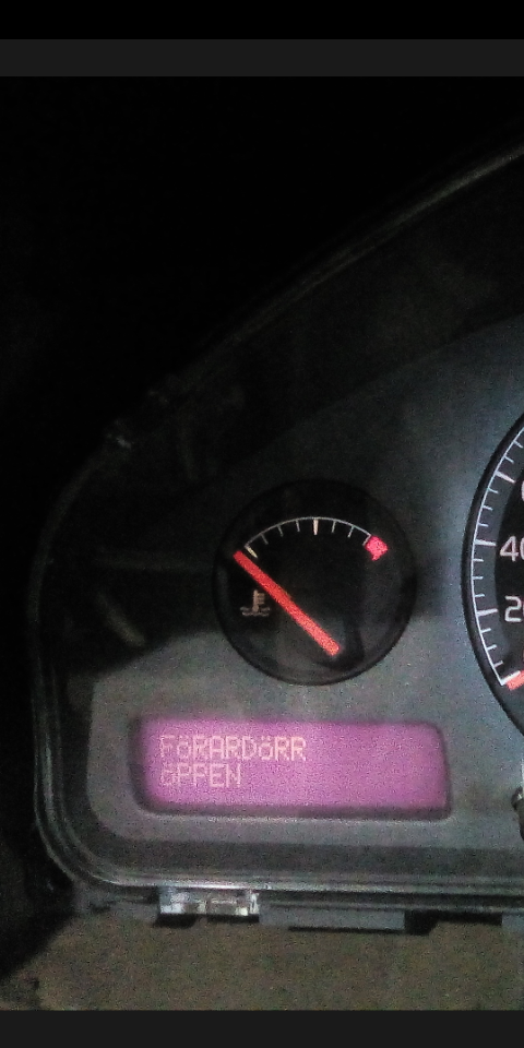

I have a Swedish speaking DIM, i'll swap ya French is much easier to understand
