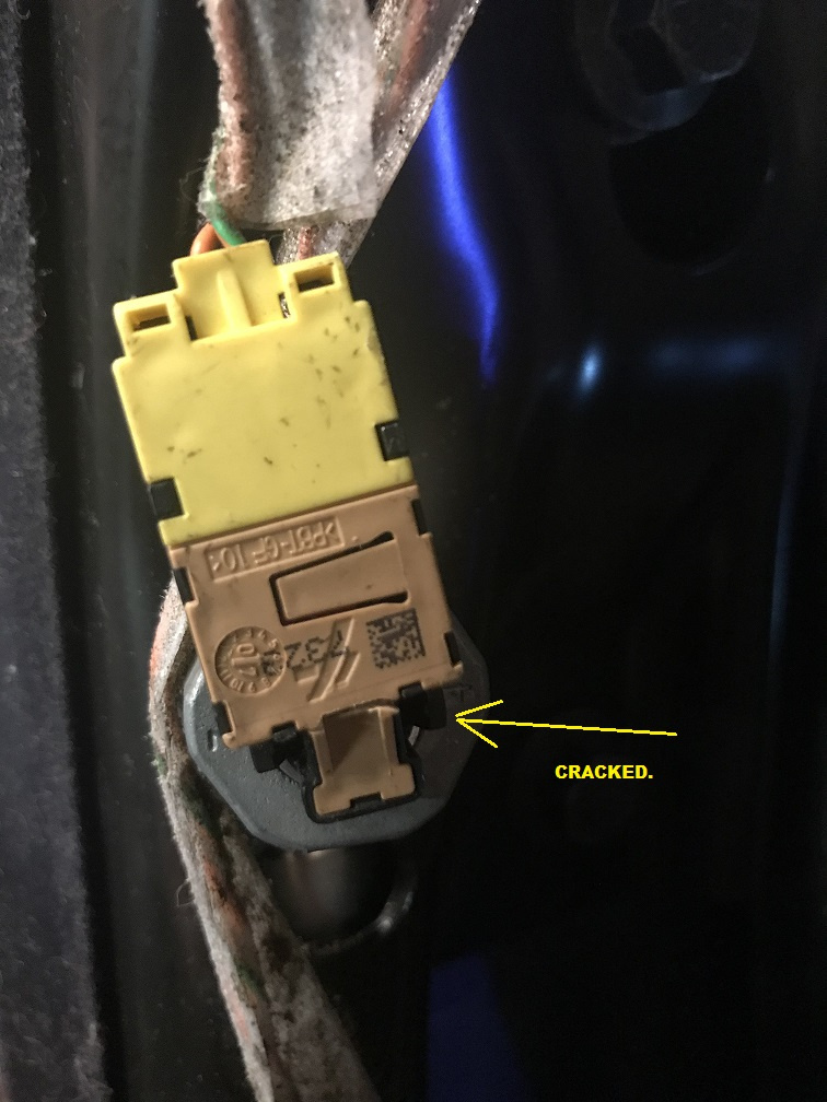

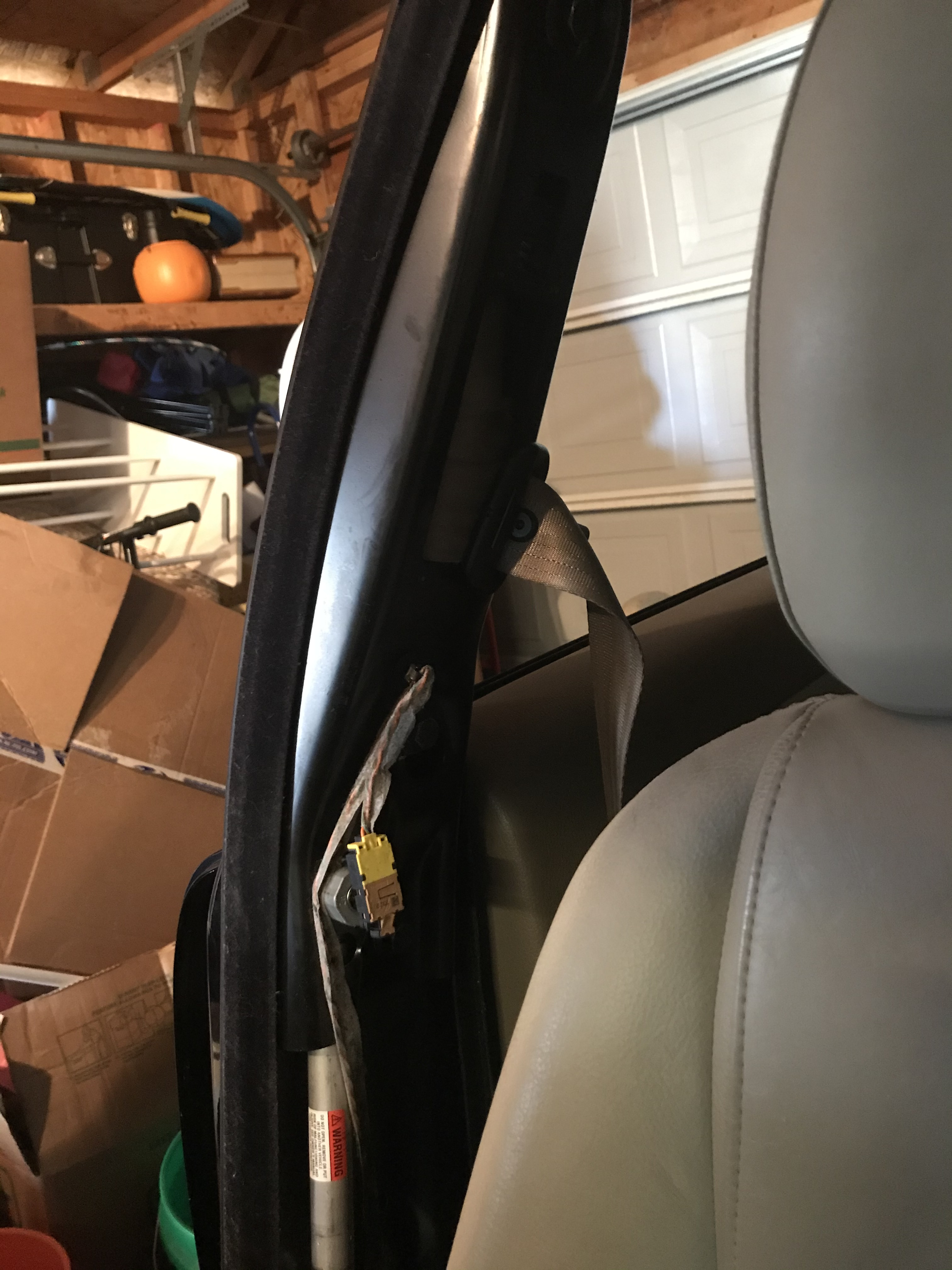

I'm restoring the interior of my '08 XC90. Upon reinstalling the front passenger seat, I bumped and cracked the part in the photo. I entered the part number(s) (PBT-6F10) on line and in my VIDA laptop program. Can't find it. I believe it's the igniter/actuator for the cylinder that deploys the side curtain air bag(s).
Input/help would be greatly appreciated. BTW, I am aware of the re-install protocol to avoid setting the airbags off.

Not sure if Volvo would sell it separately, but perhaps a local junkyard could have it ?

Pretty sure that's the seat belt tensioner/retractor.
