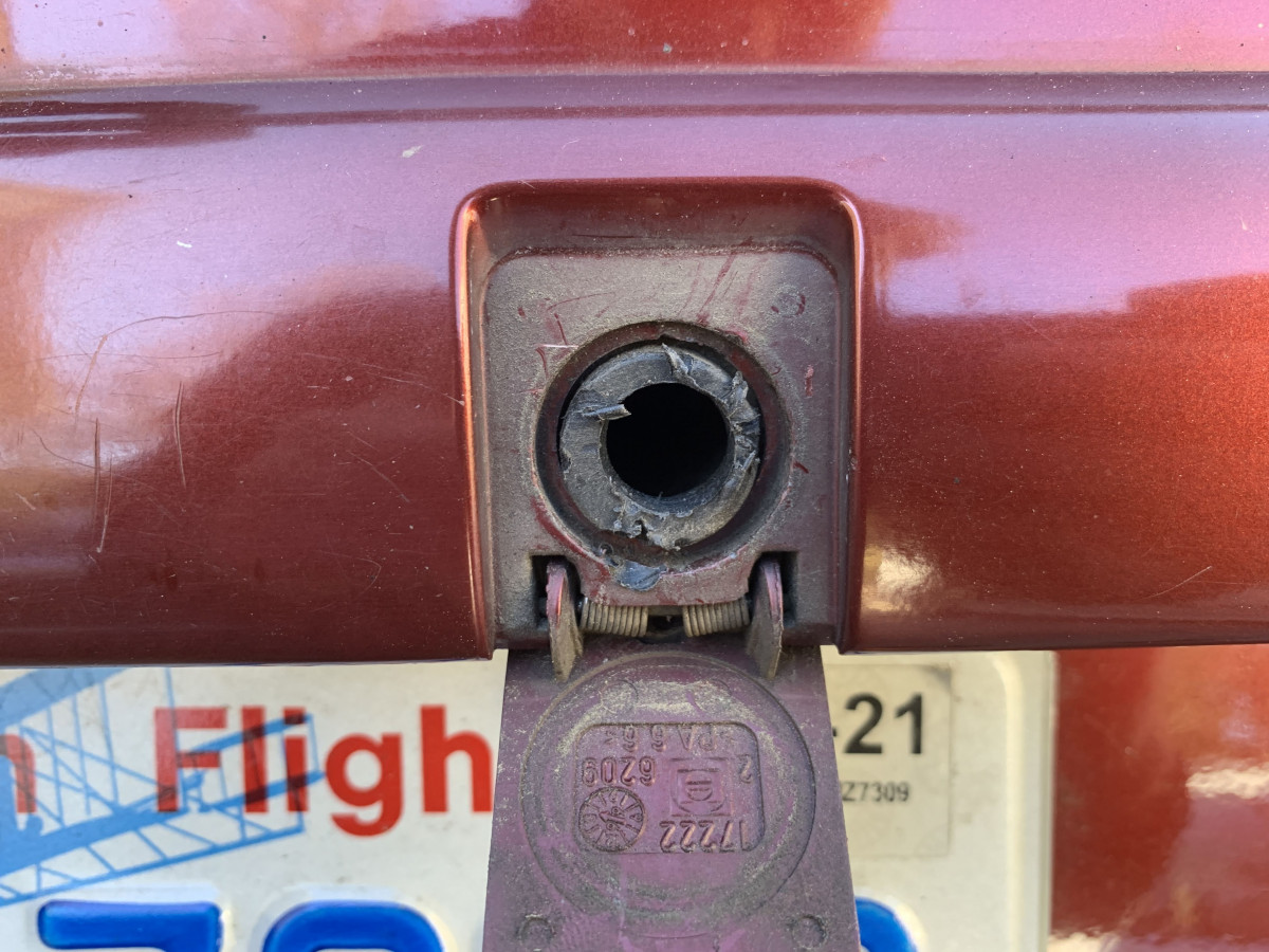

Had a slow moment yesterday and locked myself out of my V70R... I pulled the door handles to re-glue those little rubber pieces that always slip down when I pull the door handles. I was going to test the lock cylinder before putting it back together completely, but my brother and dad were around and distracting me working on his car. Naturally, I forgot to test the lock cylinder on the driver door handle after reinstalling, and ended up locking the car last night. Went ahead and tested it just after that, and sure enough, I hadn't lined up the rod properly.
Ended up having to drill out the plastic plug on the tailgate where a lock cylinder belongs (for whatever reason, Volvo didn't install lock cylinders on the 2000 models, or at least some of them after a conversation about this topic on here). So if anyone is looking to steal a P80, this method works pretty well! Now I need to find another plug.
If only I had a key fob for this car... this could have been avoided!

I'm glad I at least have a spare key for this car. I wish it could have helped me in this particular situation!kallekula wrote: 16 Nov 2020, 20:39 I keep a spare in a hidden magnetic little box on my car since I've been in a similar situation before.
