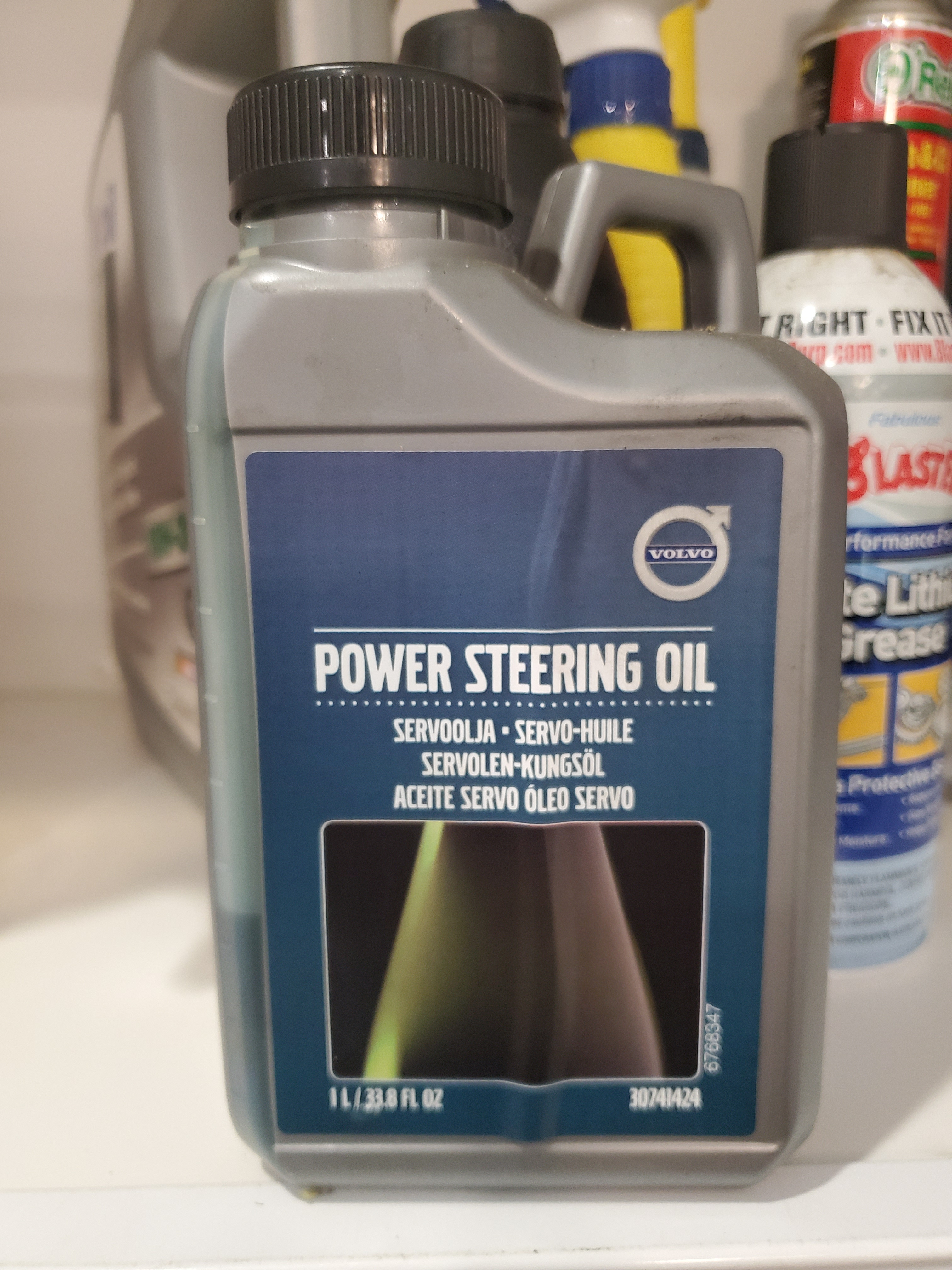

I've used both ATF and Volvo's own fluid. Didn't notice any difference at all between them, except the price of course.

I’ve used both in P80 and P2 steeering systems without ill effects
