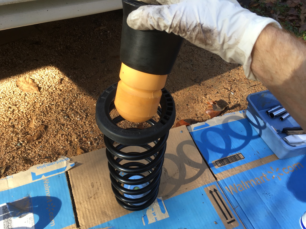

Next up was installing the new polyurethane bump stop with a new white plastic collet into the old black plastic cone. I used a deep 10mm socket to press the collet thru the stop and into the cone to lock it in place:
Then I placed spring anchor into the spring, and then placed the cone/stop assembly into the top of the spring. Be sure to have put the rubber collar on the top of the spring first. The collar has a cut out for holding the end of the spring... make sure to align the end of the spring with the cut out in the collar.

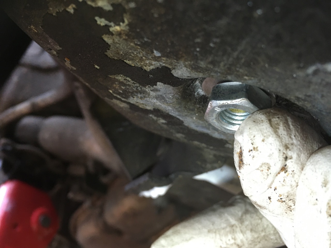

Then you attach the nut. I used a new nut and washer instead of re-using the original flanged nut.
Tighten it up a bit by hand to seat the anchor over the end of the spring
After you get the nut on and the threads started you can tighten it up with a ratchet. Final torque value was 29.5 ft-lbs (40N-m)

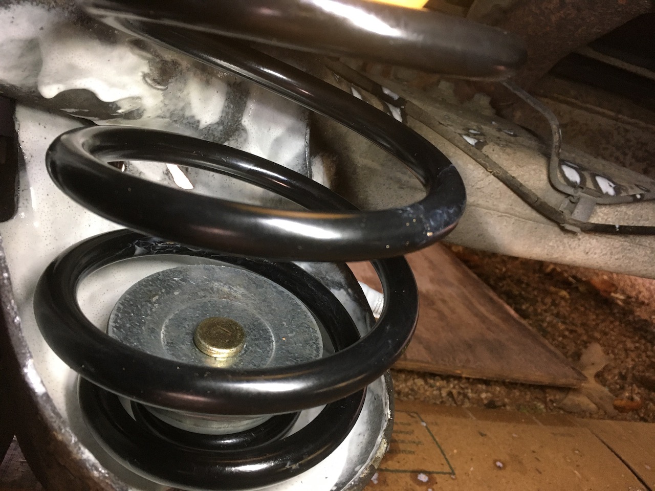

When you're done, from the inside of the spring seat the anchor will look like this, centered on the end of the spring and clamping it to the spring seat:
