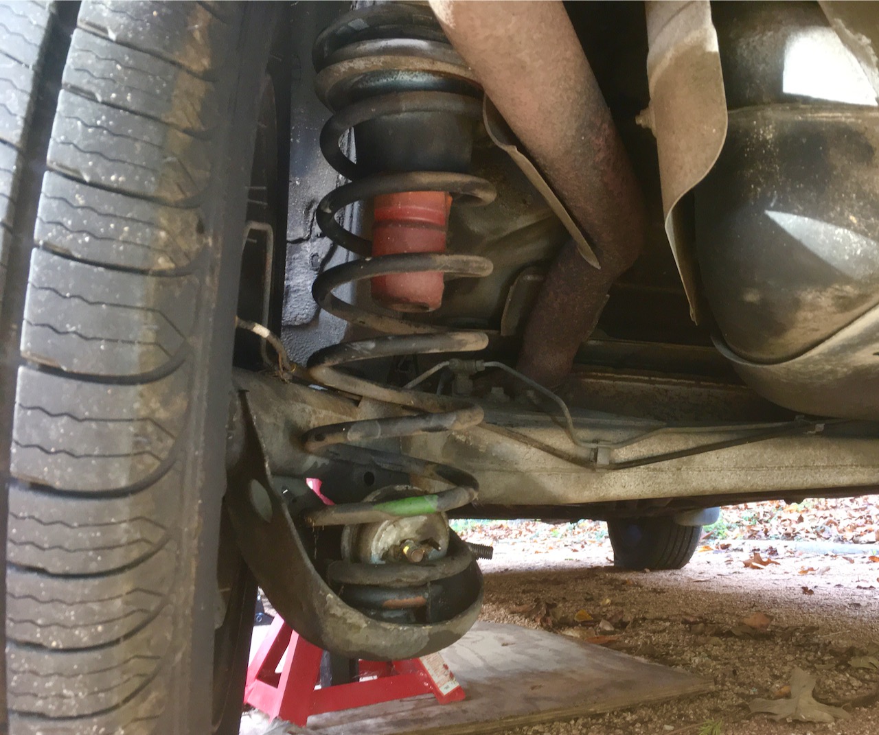

Next I jacked up the side of the car to lift the weight of the car off of the spring and placed a jackstand under the rear suspension:
Here's a close-up of the rear suspension being supported by the jackstand:
Once you have the side of the car lifted and safely supported, you can go back underneath to remove the spring. If you've jacked the car high enough, you'll see the spring is extended and ready to be removed:
Here is a close-up of the spring seat, the spring and the spring anchor. The spring is barely held in place at this point and is ready to be removed:

Then you lift the spring and push it into the lower spring seat. I did not need a spring compressor to push the spring into the seat. Place the anchor into the spring seat and align the tab with the hole.
From underneath the lower spring seat, you will see the threads from the anchor and the tab sticking thru the holes:
Then you attach the nut. I used a new nut and washer instead of re-using the original flanged nut.
Tighten it up a bit by hand to seat the anchor over the end of the spring
After you get the nut on and the threads started you can tighten it up with a ratchet. Final torque value was 29.5 ft-lbs (40N-m)
When you're done, from the inside of the spring seat the anchor will look like this, centered on the end of the spring and clamping it to the spring seat:
