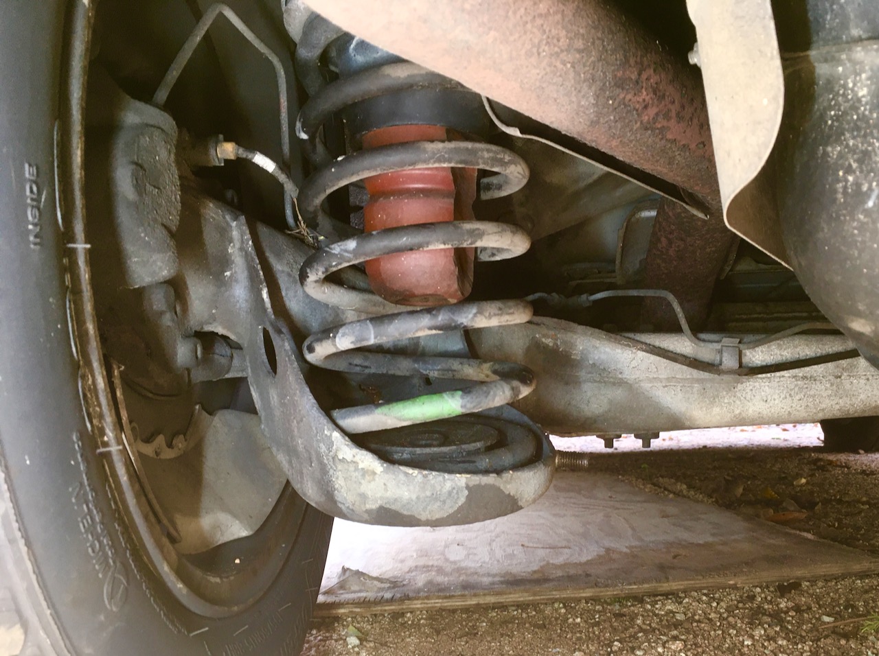

Here is the original rear spring on my wagon. This is Volvo part number 3546335.

It is interesting that when you compare the old and new springs, the original seems to be made of thicker coils.

Good eye on the diameter of the spring coils... I went back and measured with calipers. You were correct... the diameter of the original Volvo spring material is about 1/2 a millimeter larger.
Old original Volvo springs: New Lesjöfors springs: So far the new springs seem to be working well. The rear of the car is about 2-4mm higher than it used to be with the old springs. We did bottom out on the polyurethane bumps stops this weekend driving over a very deeply rutted gravel/mud road with little load in the back of the car, but that might be normal.
