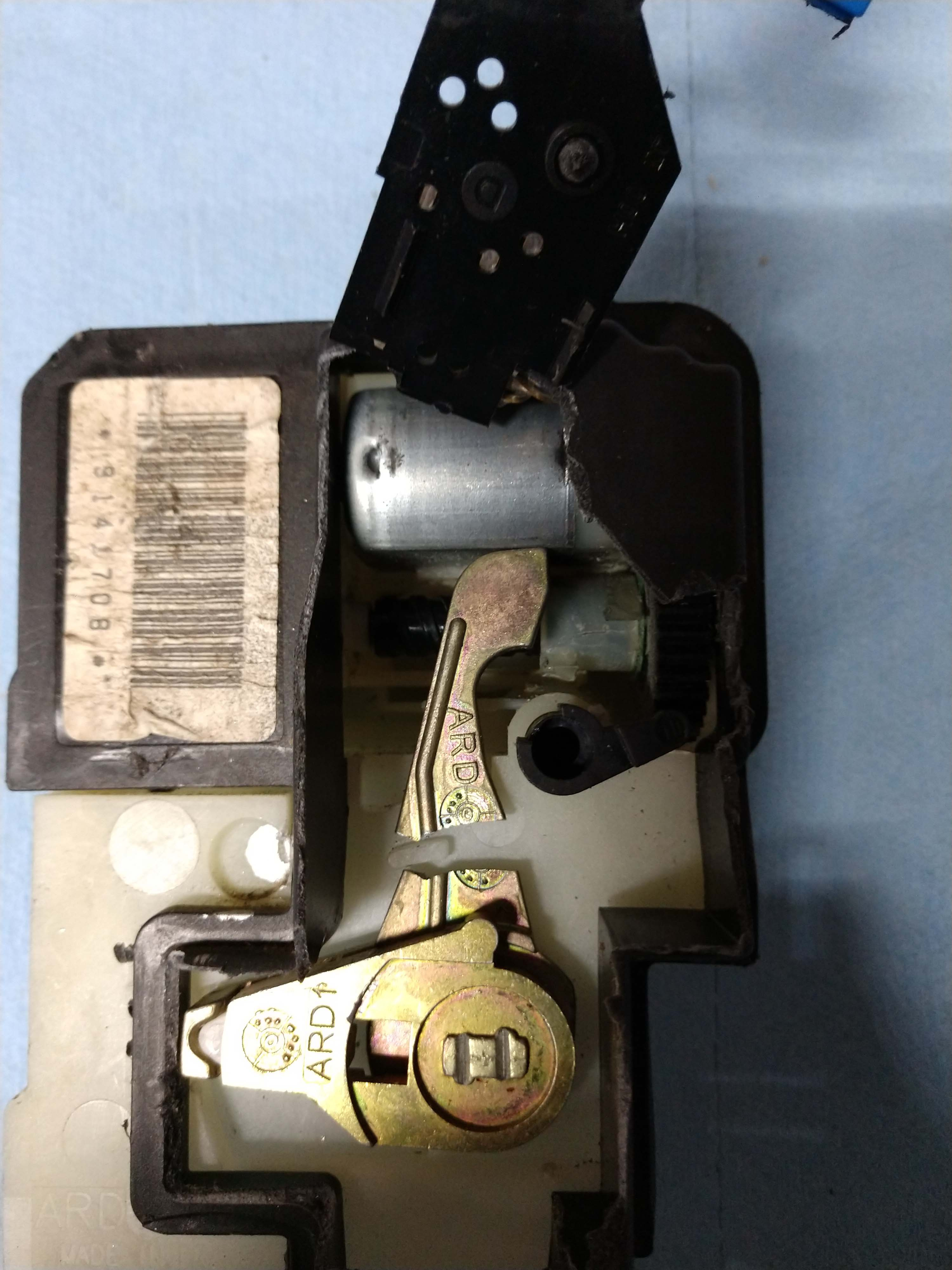

The other day I wasn't able to unlock the car door locks from the driver's door module lock/unlock button. Remote key fob worked okay but I noticed the right rear passenger door lock wasn't working; if locked it wouldn't unlock and if unlocked it wouldn't lock. I could hear and feel the lock activating but no motion with the door lock knob.

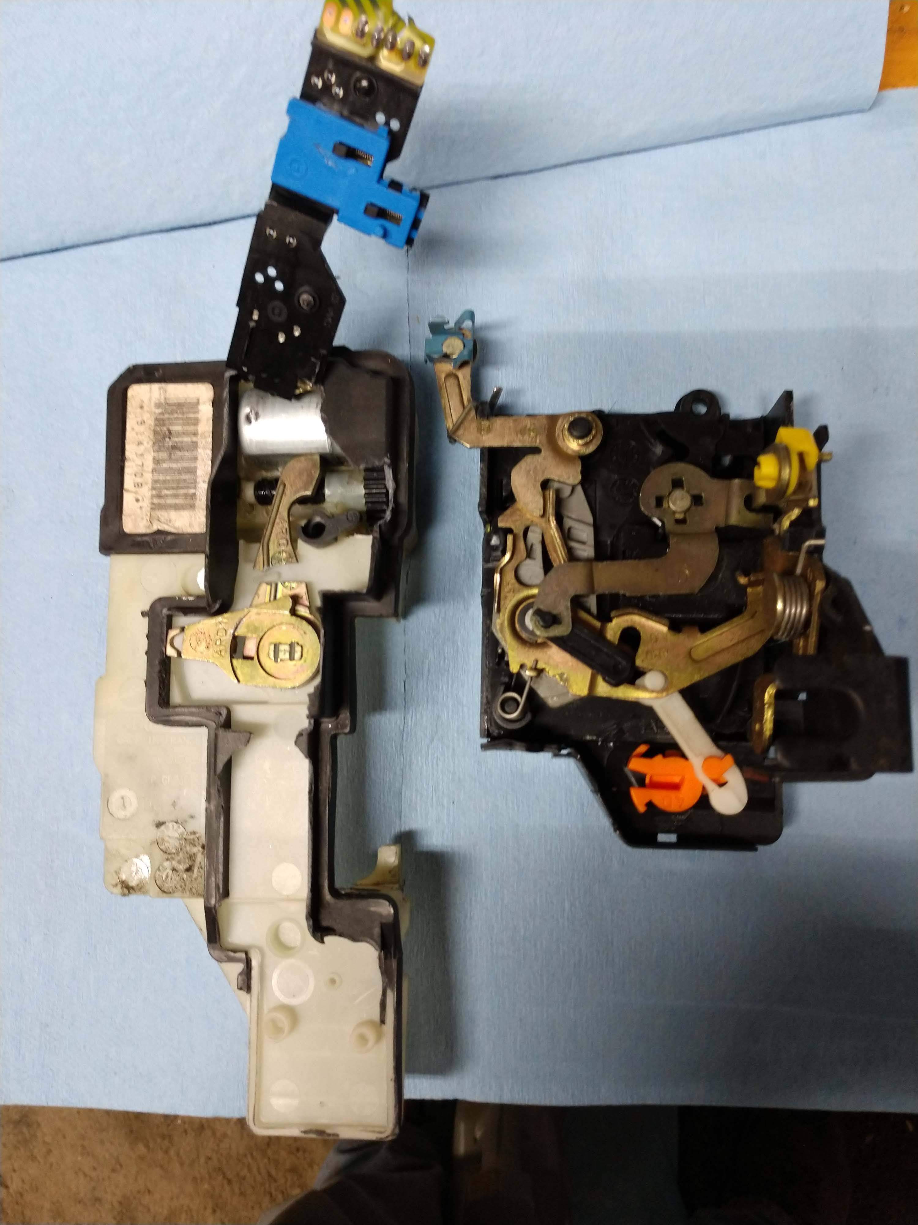

Removed and broke open the door lock assembly and found a broken linkage part inside. The broken lever transfers motion from the electric motor and worm drive to mechanically lock and unlock the locking hardware. These assemblies aren't serviceable so replaced with a salvaged part. There's more parts in the door lock assembly and complexity than I expected.

Good info. It is surprising such metallic part broke like that. Perhaps a manufacturing defect

I wonder what mine looks like inside. My left rear is doing the same thing with the lock, and for some reason I can't get that window to roll up or down (a problem I'll start a new thread on, unless I forgot to plug the rear switch back in.). Kind of neat to see the interworkings of the module, and I wish they were serviceable. I've fixed modules on Toyotas before, but they have bolts to take them apart for service.
