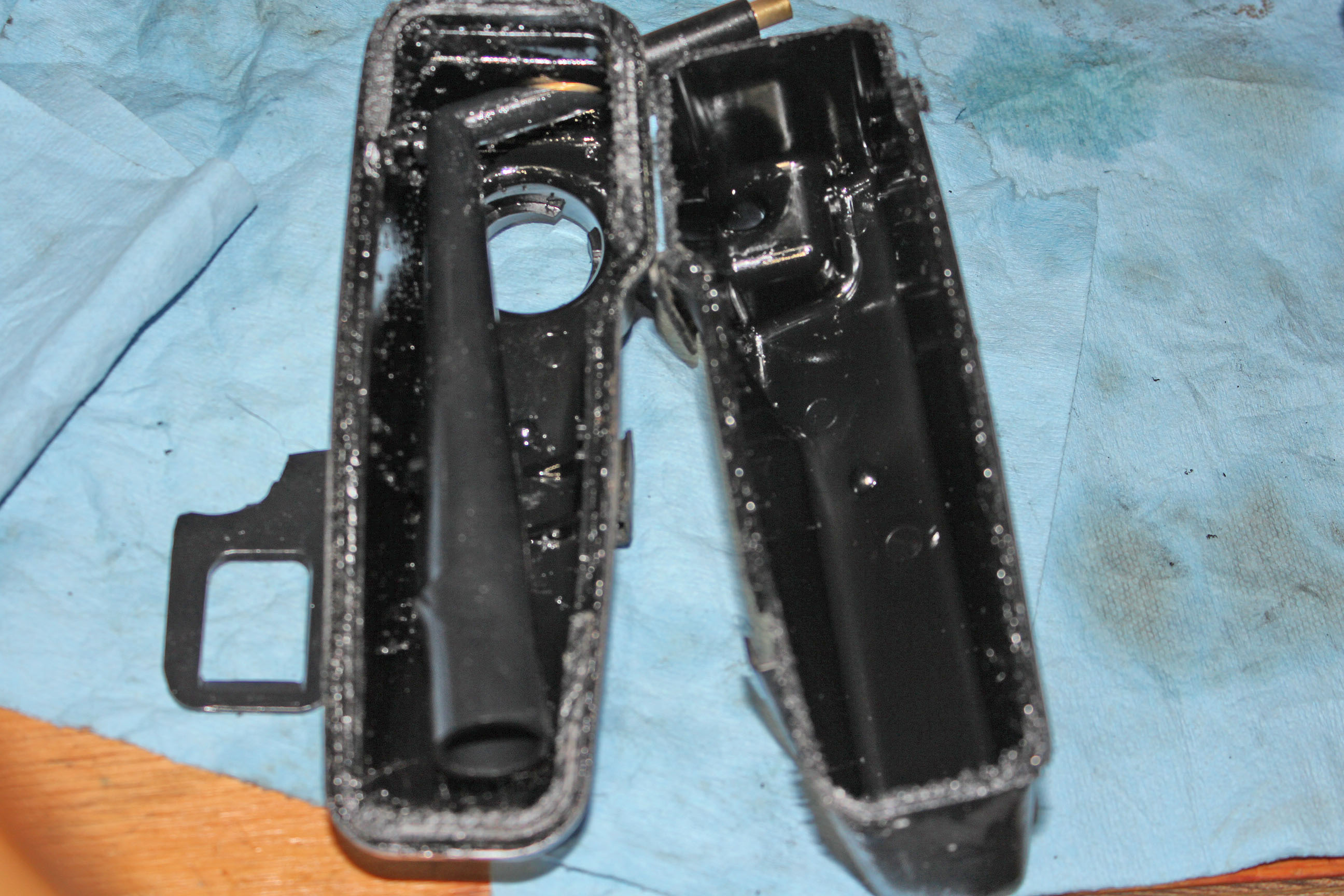

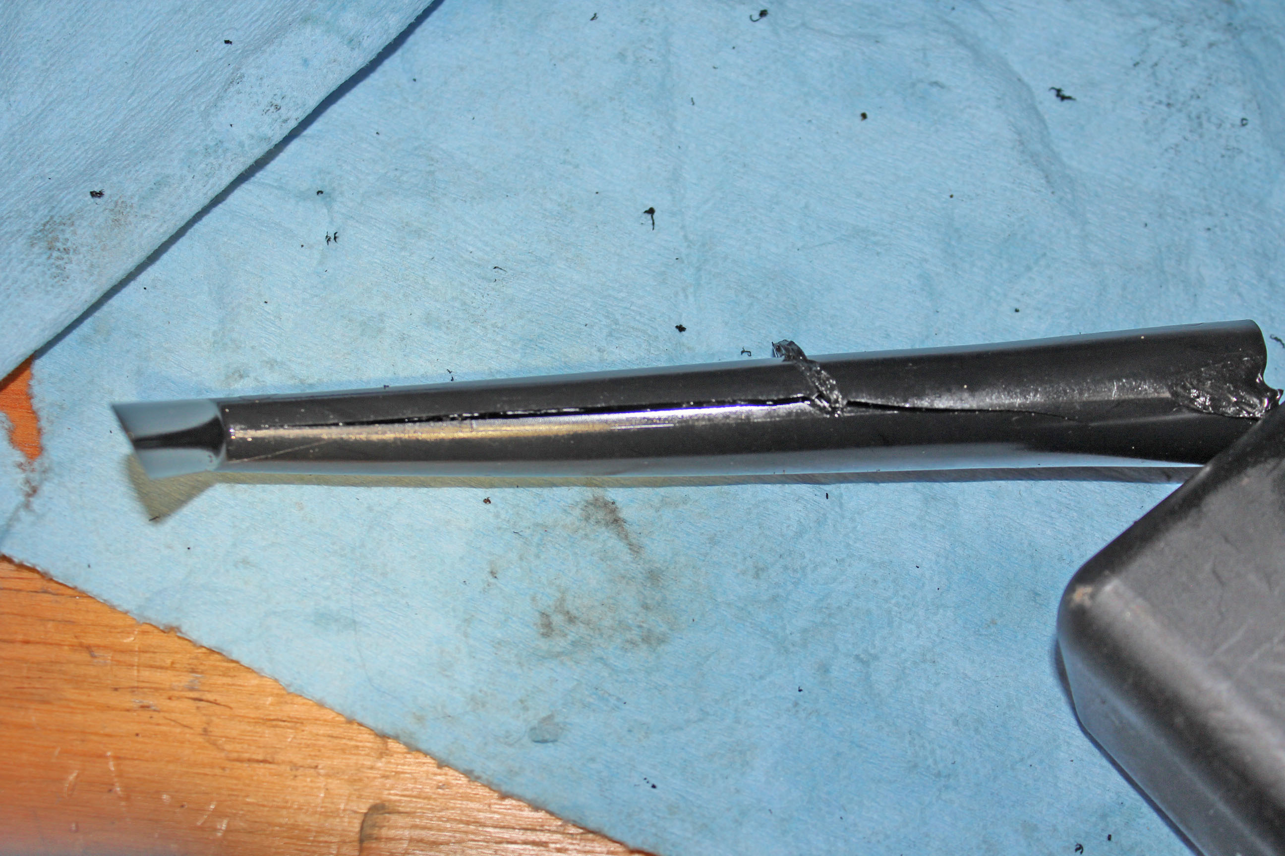

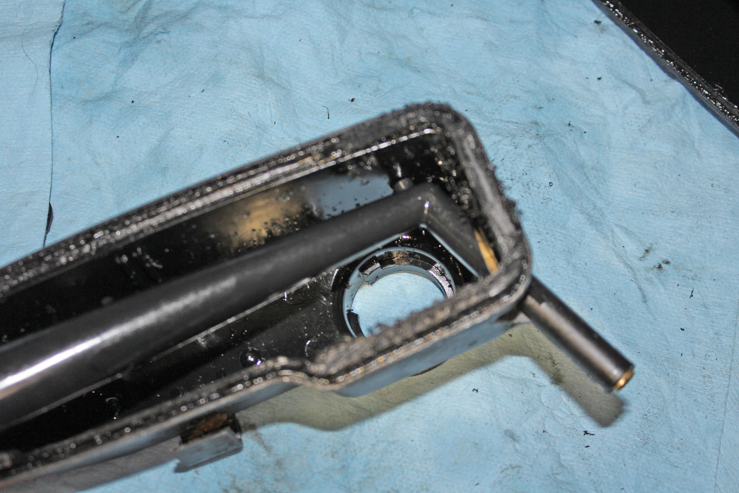

The brass tube can stick out some and if you want you can push it back in if it will move. One thing to look for is air bubbles in the fluid while the engine/PS pump is running, take the cap off and check. My PS reservoir had a crack the length of internal plastic tube (return line) and this was the causing aerated fluid and PS noise. I've attached photos of my reservoir after I opened it up. This is the reservoir design for 2001-2004 model years, it looks like the design changed sometime in the 2005 model year.gnalan wrote: ↑20 Nov 2020, 16:20 I noticed I had a leak with my power steering system somewhere, since the rack has started groaning. I read on here about problems with the reservoir leaking, and also the plastic piece inside that connects to a brass piece coming off of the return line. My plastic piece is still connected, and the brass piece sticks out of the plastic nipple the return hose connects to by about 1/4" of an inch. Is this normal? Can someone post a pic of how it should look if that's not right?

Not the last pic, but the one before it, is how far the brass piece is sticking out on mine. Also the plastic 90 degree bend seems to be against the side of the reservoir on mine. Is there a way to push the brass piece into the plastic piece, assuming it'll push in, without breaking the plastic piece? The last thing I want to do is break anything. If I could afford a new reservoir I wouldn't have spent so much time with the two part JB Weld trying to seal up the entire seam.
