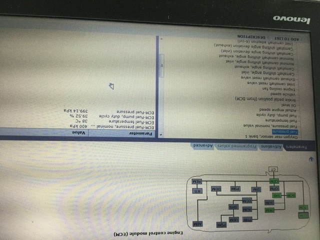

Can someone read on Vida the normal duty pump cycle ? I read online either 40% or 50% ?

oragex wrote: 30 Nov 2020, 13:54 Can someone read on Vida the normal duty pump cycle ? I read online either 40% or 50% ?
Hi Oragex,
While idling our 2006 xc70 194k duty cycle of the fuel pump is around 40%

Thanks. So it seems a 50% duty is too high. I guess I damaged the pump by keeping the tank low for too long. The pump sits inside a cup filled with gasoline at all times, but it seems this cup does not provide enough cooling for the pump if the tank is always low. Lesson learned. My pump relay would heat up too much in summer time and the pump would shut down while driving.

VIDA says 35% +/- a bit for a new pump. By 65% they almost certainly die. My pump is at ~50%, the car has 265k on the odo.

vtl wrote: 06 Dec 2020, 17:56 VIDA says 35% +/- a bit for a new pump. By 65% they almost certainly die. My pump is at ~50%, the car has 265k on the odo.
I replaced my fuel pump right after I bought my car this summer. I'll check what my duty cycle is tomorrow, if I get a chance, and post what it shows.
