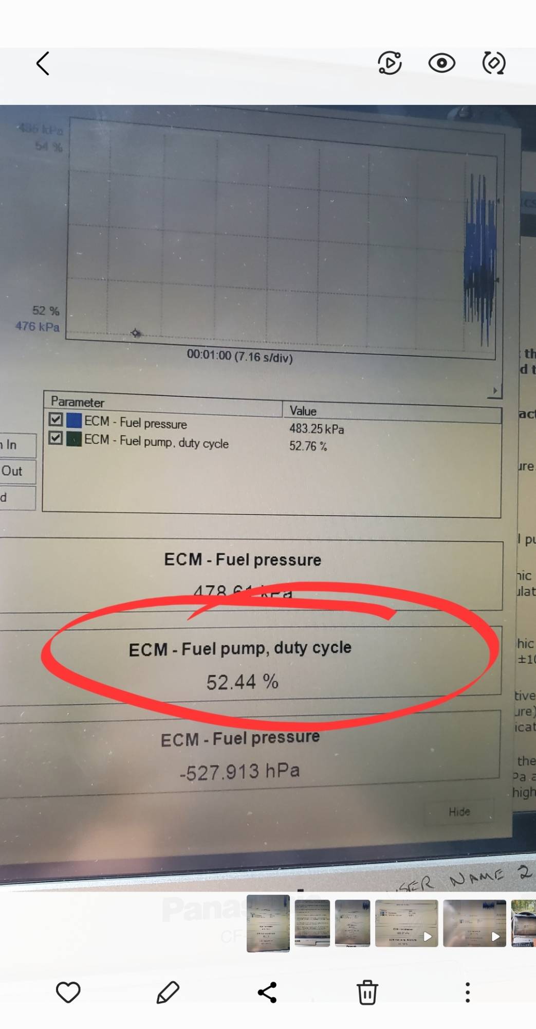

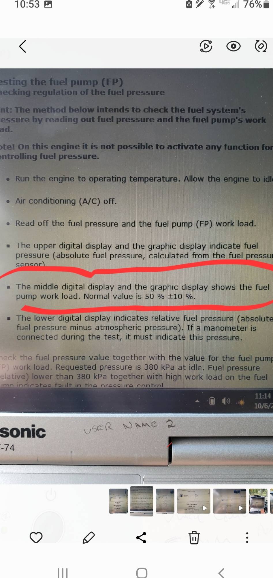

Jphowey
Posts: 1
Joined: 15 October 2019
Year and Model: 2003 V70 T5
Location: PA
Post by Jphowey »
VIDA for my 2006 XC90 V8 is saying 50% duty cycle +-10. Not 35% as all the commentary suggests. Hmm?
