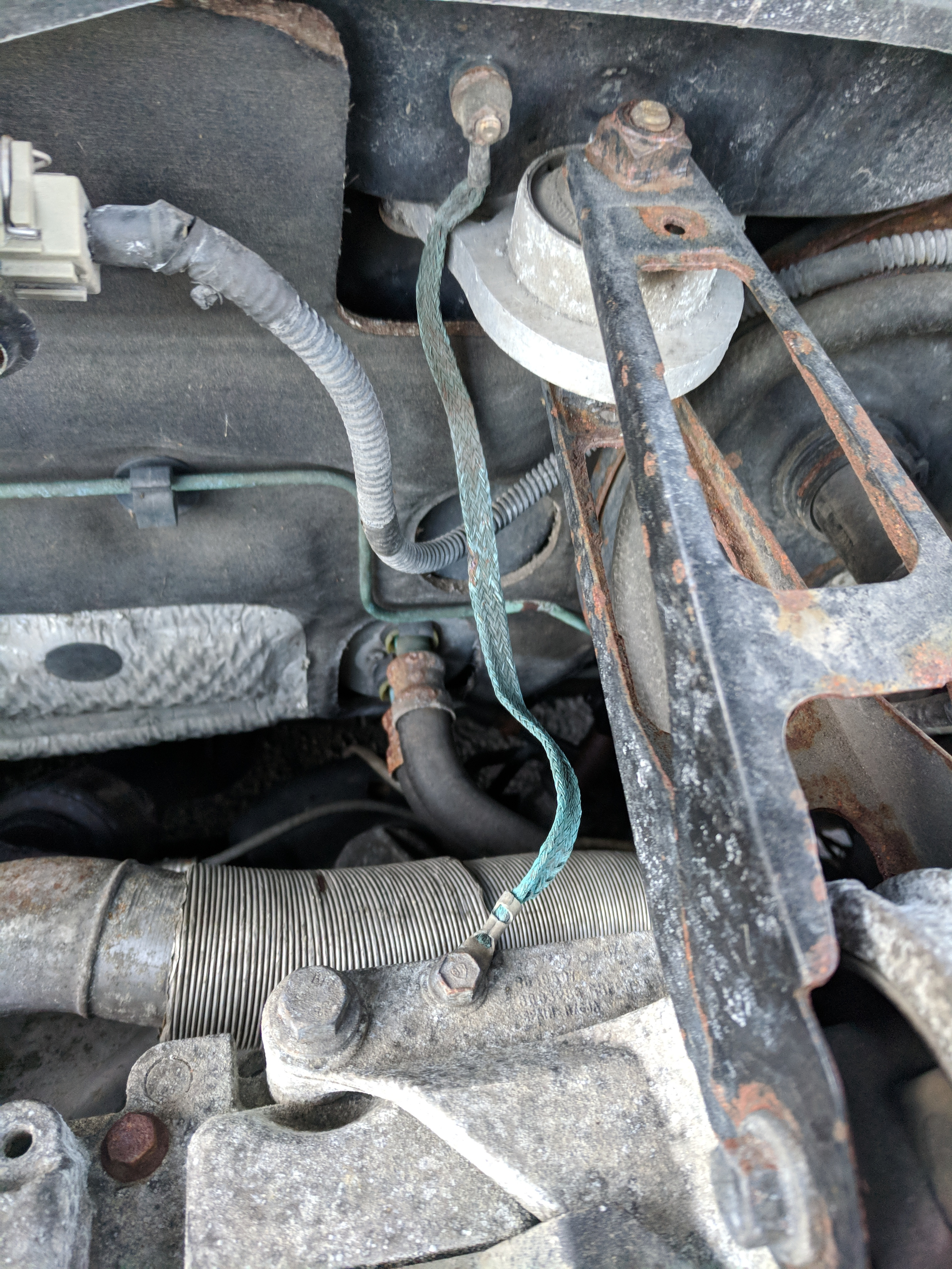

Where did you ground it on the engine?FireFox31 wrote: 08 Dec 2020, 12:14 Try connecting a jumper cable from battery ground to a sturdy spot on the engine, then try starting the car. If your car has grounding straps between the engine and the car body like my 2000 V70, than they may have failed.
My 2000 has two braided grounding straps from the top center and top right of the engine to the car body at the back of the engine bay. Visually, they looked oxidized but intact. A year after changing my starter, the car simply failed to crank or start. It didn't even click/pop like yours, so the symptoms aren't an exact match, but I'm mentioning it anyway. I installed a homemade replacement strap using 8 AWG wire and wire terminals and the car worked perfectly.

The attached pics show the failed ground (which looks perfectly fine) and where I connected the jumper cable to battery negative. Remember, this is a 2000 V70 so may be different from yours.
