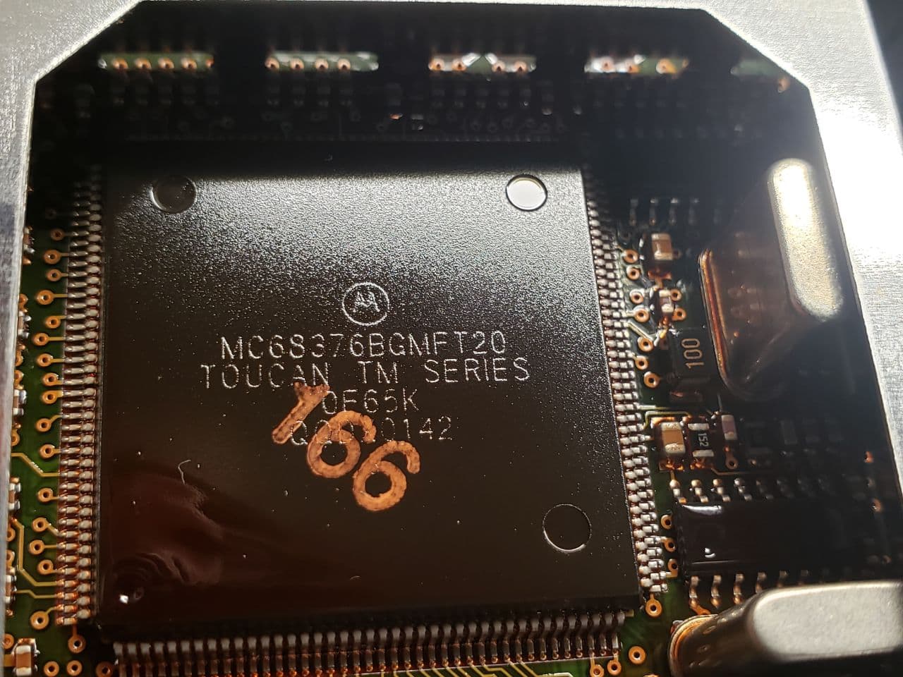

I can't seem to find a datasheet for the MC68386. Are you sure that's the correct IC?RickHaleParker wrote: 19 Nov 2020, 00:17 P2 CEM-H: HS CAN 250 kbps, LS CAN 125 kbps. ( Motorola MC68386, 1999 - 2004 )

I cannot find a datasheet. I found the part number on the D5T5 website. Companies are keeping a tight rein on what use to be readily available information. Not surprising considering one of the big issues today is the right to repair.gnalan wrote: 17 Dec 2020, 06:45 I can't seem to find a datasheet for the MC68386. Are you sure that's the correct IC?
The MC683XX line started under Motorola continued under Freescale Semiconductor. Don't know if it survived the merger with NXP.
I wonder if it a typo on the D5T5 website. I found the datasheet for a MC68336. 3 is often misread as 8. I got a CEM-H somewhere in the shed. Maybe I will find it and pop it open.

MC68376 datasheet
https://www.digikey.com/en/products/det ... T20/410949
