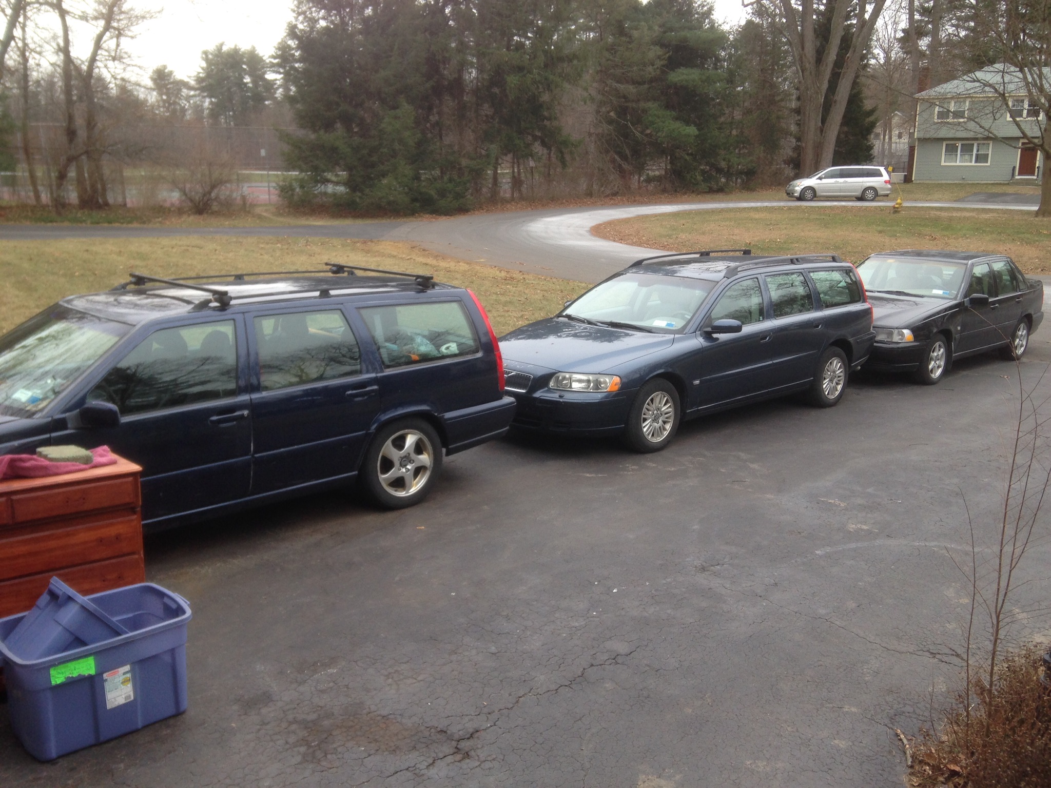

Luckily I happen to have a T5 Stick shift in the driveway
