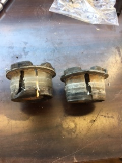

Drilled bushings.jpg (32.37 KiB) Viewed 8851 times
Bushing removal was very easy, I drilled out the white plastic on the bushing with a 1/4 inch drill bit and then simply pried it out with a flathead and hammer. You must drill out the plastic in at least one spot to "collapse" it and get it loose. There's no need to remove the centre part with a hole saw as some people have done.

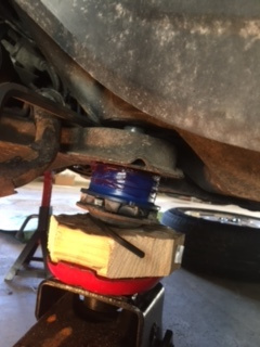

Starting bushing.jpg (35.21 KiB) Viewed 8850 times
I then cleaned the bushing bore with some emery cloth, a couple of mine were rusty and scaly. I then put a small amount of wheel bearing grease on the outside plastic body of the bushing to help it get started. I used the floor jack and a piece of wood to start the bushing. You'll probably only get the bushing in about a half inch with the floor jack, just not enough force to get it fully seated

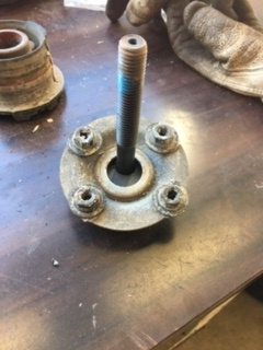

Special bushing press.jpg (35.98 KiB) Viewed 8851 times

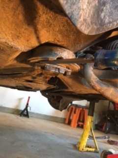

I used the washer from the first bushing and turned it upside down and glued some top strut nuts on it to make an installation tool and a bushing bolt to fully seat the bushing. This was necessary so that the force is distributed on the plastic frame of the bushing, not the rubber tabs which will crush. You will also need to put a spacer between the subframe and the frame so that the bushing seats in its bore and doesn't push up on the car frame. For this I used a Large Allen key as seen in the picture. You'll know when the bushing is fully seated, it's pretty obvious. I probably only had to use about 50 foot pounds pressure on the bolt to suck the bushings in. I would discourage using an impact wrench for this step.

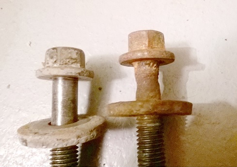

Since other people will watch this thread in the future, I would like to also warn about potential issues with the large subframe bolts, same may rust badly which will cause them to get thinner (so less solid) and also stuck. There were a few unlucky people who had such bolts break during removal (not fun). If one feels the bolt is stuck or starts to 'twist', better stop removing it. I recommend not using excessive force on the breaker bar while trying to remove a bolt. Here's a picture of a badly rusted subframe bolt.
Notice the bolts have a black paint coat, once this coat is scratched, rust starts having a party. I've found the same issue with the two horizontal control arm bolts
